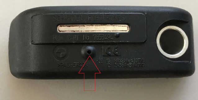

You would think but no. I use to use Ride On in my Harley wheels and when you take off the tire to replace the majority would be stuck around the inside of the tire but there is also stuff on the rim everywhere too. I don't use it on my BMWs as the TPMS sensor is not sealed.

Doctor T wrote: Mon May 15, 2023 1:33 pm The sensors are a sealer unit
No they are not. Got an answer from BMW with a picture where the hole is. The newer smaler one have the hole at the end.

What year is your bike? Mine hasn't got that hole

Bikes in my info at right. Ride On says sensors need to be hermetically sealed so sealant won't damage them. Contacted BMW and they said their's are not, longer older ones and new short ones have the hole which they pointed out. Probably best to contact actual maker, Schrader for real answer. Both my BMW part number ones have the holes as they stated. Why yours doesn't who knows.

60Aviator wrote: Tue May 16, 2023 4:57 pm Bikes in my info at right. Ride On says sensors need to be hermetically sealed so sealant won't damage them. Contacted BMW and they said their's are not, longer older ones and new short ones have the hole which they pointed out. Probably best to contact actual maker, Schrader for real answer. Both my BMW part number ones have the holes as they stated. Why yours doesn't who knows.
Haven't a clue why mine has not have a hole. I had a good look at them 2 weeks ago whilst fitting new tyres. Going through the service history, they seem to be the original ones from 2007

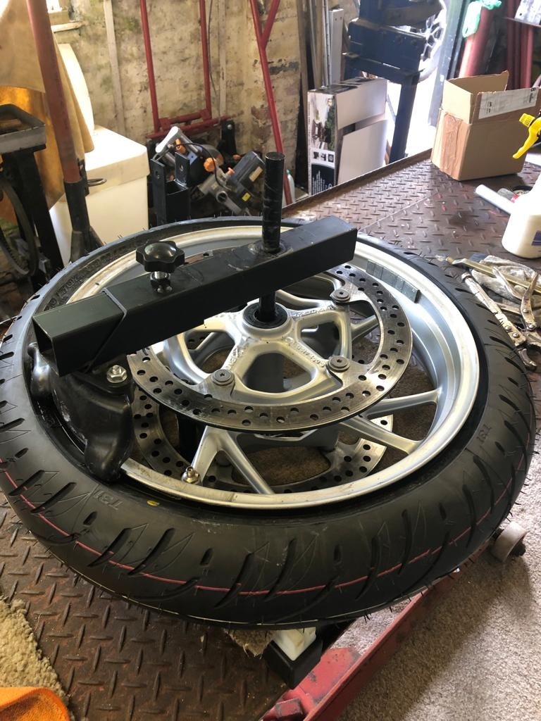

New tyre fitted and repair kit ordered (thanks Steve), fitted the tyre twice as I do it nice.... :lol:
First time the rotation was wrong :roll:

Which tyre fitting contraption is that,looks a lot better than my setup.

burridge01 wrote: Sun May 21, 2023 8:34 pm Which tyre fitting contraption is that,looks a lot better than my setup.
Proworks from XL Moto, I bought it years ago and only used it once, wasnt a good experience.... chased it a round the garage floor for a while then resorted to tyre levers, thought I would give it a go again but this time I bolted it to my bench, that made a big difference. Still hard work but each time it gets easier.... didnt get instructions with it and the you tube video is not a lot of help.. definately not as easy as the video...
