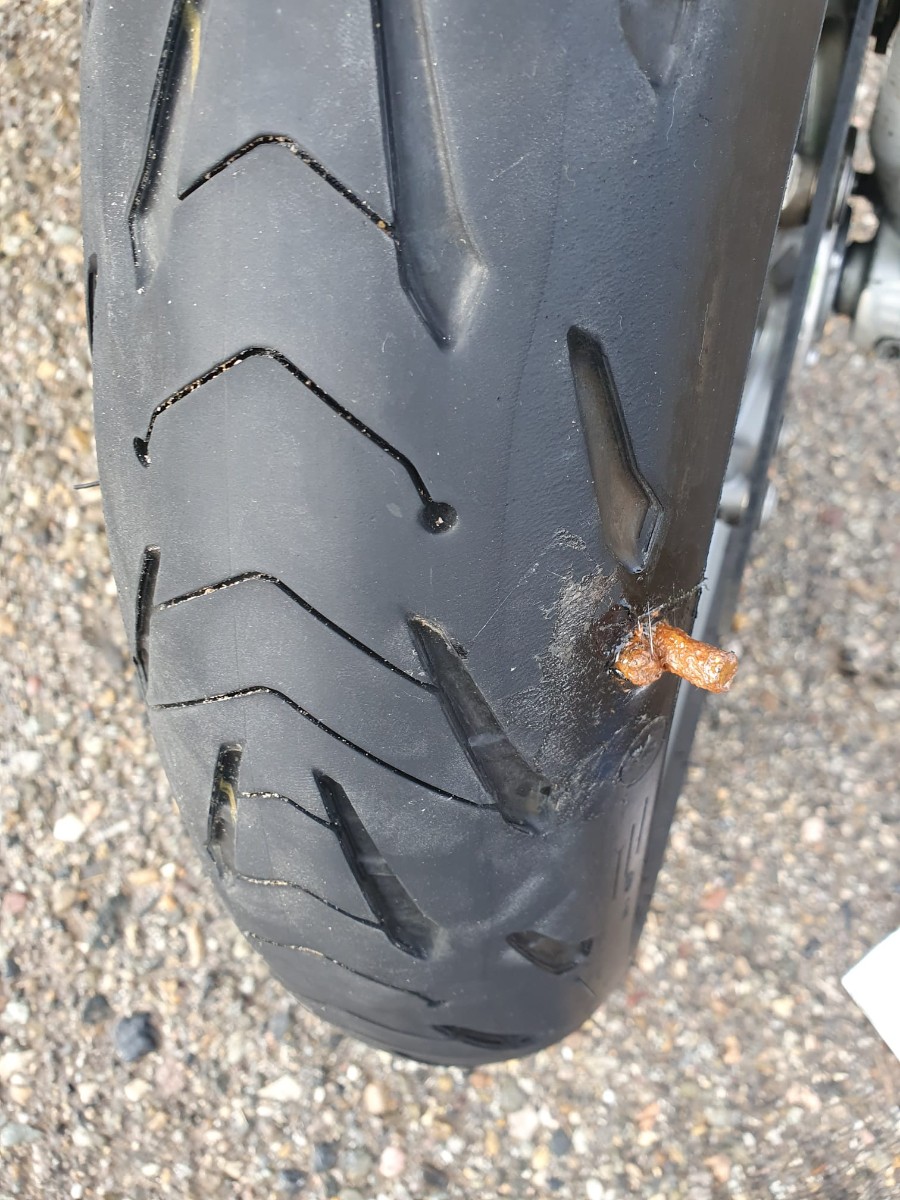

I hit a rock in the pyrenees and had to use two strings to fill the hole (well, Michael did
) it lasted the duration of the tyre.
- IMG-20210901-WA0003.jpg (255.66 KiB) Viewed 6121 times
