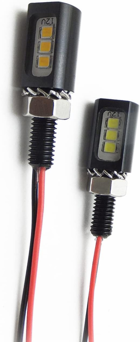

I got a set of these, but my solution is working just fine....
lic plate bolt lights.jpg (86.77 KiB) Viewed 6034 times
