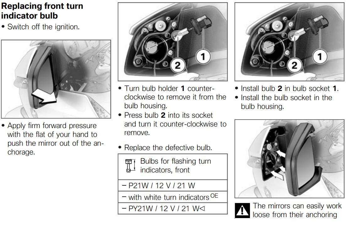

The front still have me confused. The owner's manual says something about putting your palm on the mirror and pushing hard to remove it! Really?
This sounds more like a way ot break it. Push the mirror into the fairing to get it out?
Some seem to be able to push a screw driver in at the upper right corner and remove the screw that holds the entire mirror mount. I've seen a couple of videos that get to the turn indicator bulb that way, but I don't see that screw when I look in the upper right corner behind the mirror.
So the first "newbie" question is... How do I get to the front turn indicator bulbs to replace them? There must be a way or no one would ever replace them. That seems unlikely.
The canbus compatible bulbs arrive tomorrow. I'm looking forward to replacing all four turn indicators. The rear will be easy.

There's a small hole underneath the mirror housing with a torxs grub screw in it that holds the mirror glass in place, undo that screw and the mirror pops off quite easily (use a glass sucker from a sat nav/phone mount or similar) from there you can gain easy access to the running light bulb. There will be videos on the tube.

For a 2008 Hexhead, fast forward to 1:30 on this video to remove the mirrors.
This video might make things clearer.

I've seen the video for this but the screw is in the upper right hand corner. I don't have a screw like that I can find anywhere.simbo wrote: ↑Wed Dec 18, 2024 9:28 pm There's a small hole underneath the mirror housing with a torxs grub screw in it that holds the mirror glass in place, undo that screw and the mirror pops off quite easily (use a glass sucker from a sat nav/phone mount or similar) from there you can gain easy access to the running light bulb. There will be videos on the tube.![]()
Darn, your instruction isn't the same as the other videos people gave.
So , there must be more than one way this comes apart? In your procedure does the mirror come out all by itself? or does the black pastic frame around the mirror come with it?? I'll go hunting for the screw that causes the mirror to pop put.
Question: if the mirror pops off, why will i need a suction cup from a SAT NAV mount?
I can tell.. I am so going to break this and then spend $800 getting the whole thing replaced at the BMW dealer! Yikes!
What is a "torx grub screw"? There's another thing I have to go and google. Is it like a phillips head screw?

Wow! He makes it look so easy. I still can't see what he did to make the mirror and the black plastic frame around it come off.
Is there a screw that needs to come out first? If so, where is this screw?

Success!
OK.There is NO screw, torx or phillips, that needs to come out.
I grabbed the plastic around the mirror (not just the glass mirror by itself) , and the plastic came out with the the mirror as ONE UNIT.
It's held in place by two round, plastic, "ball" pieces that fit into rubber mounts. You put it back by placing the two plastic round things on to the rubber mounts and pushing. I can see why one of the videos teaches how to put them on a tether. They could fall out and go bouncing down the highway. Still, the bike I'm learning on is 16 years old, and that's never happened. Two rubber gromets hold it in place.
It's a "ZEN" thing... I would say. You can't really learn how to do it without doing it once.
The videos helped most of all for that reason.

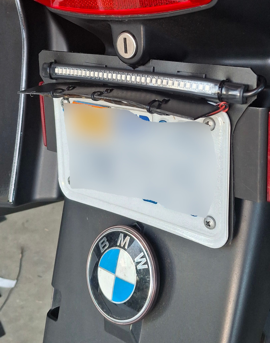

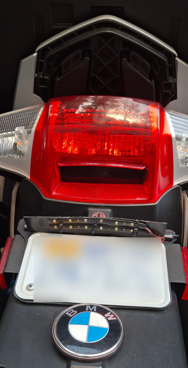

OK, here's a photo of the license plate adapter that hosts the brake light LED strip and the License plate LEDs.
The first shows it from looking down on to it. The seconds is meant to show the leds that light the plate.
