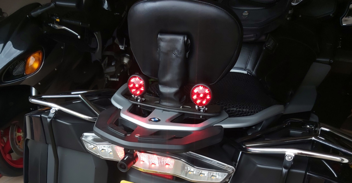

Do you have a Hex EzCan ?
I have and used one of the spare plugs to give me extra brake lights.
I know the EzCan are not cheap, But it will give you the opportunity to add more electronics to the bike without upsetting the Can-Bus.
If i'm off base here, then i'm sorry i can't be of more help.
Brakes ON.jpg (160.28 KiB) Viewed 3495 times
