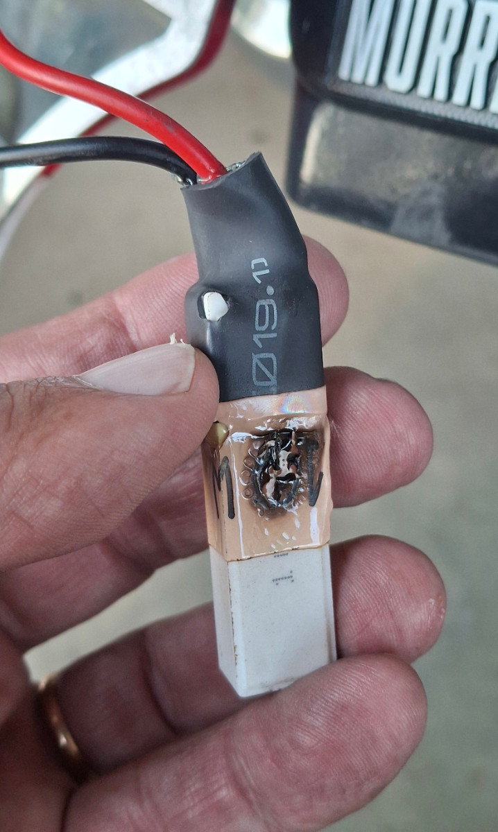

I put two 10W resistors inline with each brake light in the back. They keep CanBus happy.... but....
They appear to melting.
What is the fix for that???
Should I use a 30W resistor instead??

Inspecting the resistor, I see that the shrink on the outside is melted but not the white plastic underneath.
Obviously, that's not white plastic, or it would have melted too!

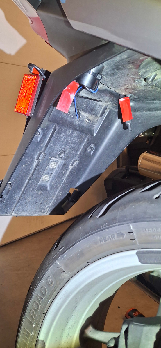

Still, the engineer in my heart tells me that the resistors need more ventilation, sooooo....
I've trailed them just outside the rear brake light enclosure in the rear tire well.
It doesn't make sense that something that HOT should rest against any surface down there as it's all plastic and not metal. It seems like it would have been best to surface mount the resistors on to a metal surface somewhere because the metal wouldn't melt, AND metal would help dissipate HEAT, which is my real enemy here.
The resistors are suspended by their own two wires (Red/Black) outside of any enclosure for maximum air flow. They stick out under the rear tire fender about an inch and a half (the length of each Resistor) ..... well away from the tire. Exposed to weather like that, they won't last forever, but what does?
The resistors ARE now surrounded by cool air, somtimes rushing cool air at speed, and should they burn up completely, they will fall off and into the street OR they will FAIL and break the circuit.
At either point, the CanBus will go sour and tell me something's wrong.
More specifics if you're not disgusted already.... I went for a three hour ride yesterday, and all that happened was that each resistor scorched a circular hole in the shrink protecting it. This suggests the heat is HIGH but also constant and NOT high enough to start a fire.
It's a little more "rube goldberg" (look it up) than I would like, but it's better than leaving the hot resistors tucked in with the brake light wiring in that confined, unvented, area just behind the actual brake lights.
Any thoughts? I would love to hear a better solution!
Different resistors? I don't know what will fix this....
or maybe this is just the way it is... for all resistors, and I have to accommodate it.

Here's a photo of the work. I added the red electrical tape strips so you could see where the resistors live now...

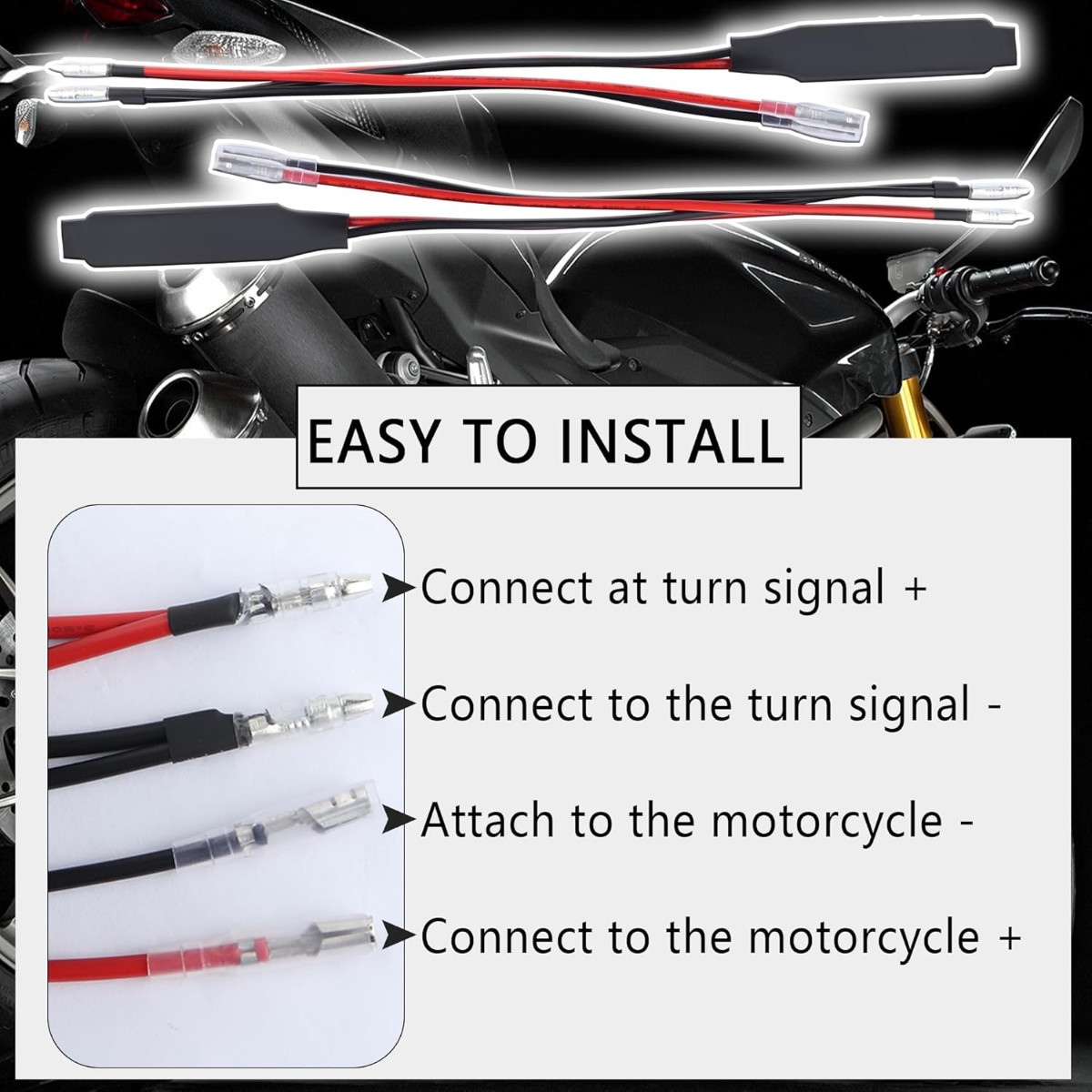

Examining the wiring diagram for the 10W resistor, I realize I have them wired in WRONGLY!
Consider this diagram, please:
There are SINGLE and DOUBLE wire connectors for both RED and BLACK (hot and ground (earth))
I have the "motorcycle" connected to both DOUBLE wire connectors, HOT and EARTH, and
the SINGLE wire connectors to the LED lights.
That is BACKWARD!
(that's what I get for reasoning it out on my own.) Maybe an electrician could tell me what effect that has on the resistors, but I suspect it's causing the over-heating!
The diagram says I should connect the DOUBLE wire connectors to the LED socket, AND
connect the SINGLE wire connections to "motorcycle".
That is the first change I will make.

Turn signal resistors obviously do not remain live permanently like the tail/brake light does.
I've viewed a video where the metal ones are used. If these cannot be mounted to metal bodywork, then in air is the next best thing.
If the Can-bus system is happy with the value of the resistors, just replace plastic with metal ones.
From what I can see of the turn signal resistors wiring, it's to connect them in parallel as they should be.
Higher wattage = more heat.

a) I've left the resistors fully exposed to air flow underneath the rear tire enclosure. It is free there to too cool down as much as it can.
b) I've put a "quick connect" on the resistor's two black/red wires so that I can replace a failed resistor at the road side armed with only a fillip-head screwdriver. There's plenty of space to carry two spare resistors, pre-wired with the same quick connect.
c) As many, including Bill Murray, said "It Is What It Is".
Murray's comic translation is "You're FU**ED, and it's going to stay that way".
(It's in the movie "St. Vincent". It's a charming movie worth sitting for.)
I could certainly fix this by giving up and putting the incandescent bulbs back in the brake light sockets. I could then carry replacement incandescent bulbs. That would work... and depending how this goes over time, I may just do that.
The result? It seems clear that using a 10W resistor would work for turn signals since the turn signal is ON well less than half the time.
Using the same resistor for a light that is ON constantly and gets even more ON from time to time, is a mis-use of the resistor.
There must be a resistor (or solution) for this, as I am NOT the first person to ever experience this behaviour.
Someone knows exactly how to fix this.
Someday, I hope to meet that person.
Until then... here is my solution:

The metal ones could be secured to the framework under the seat to dissipate the heat.
