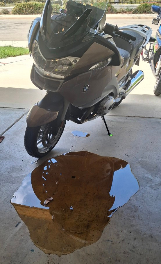

oil spill.jpg (165.8 KiB) Viewed 2605 times
Actually, I did figure out this is what happens if you leave the rubber oil filter O-ring from previous filter on and then screw in the new filter and it's O-ring.!!!
Two O-rings don't seal 2X as well!!!!

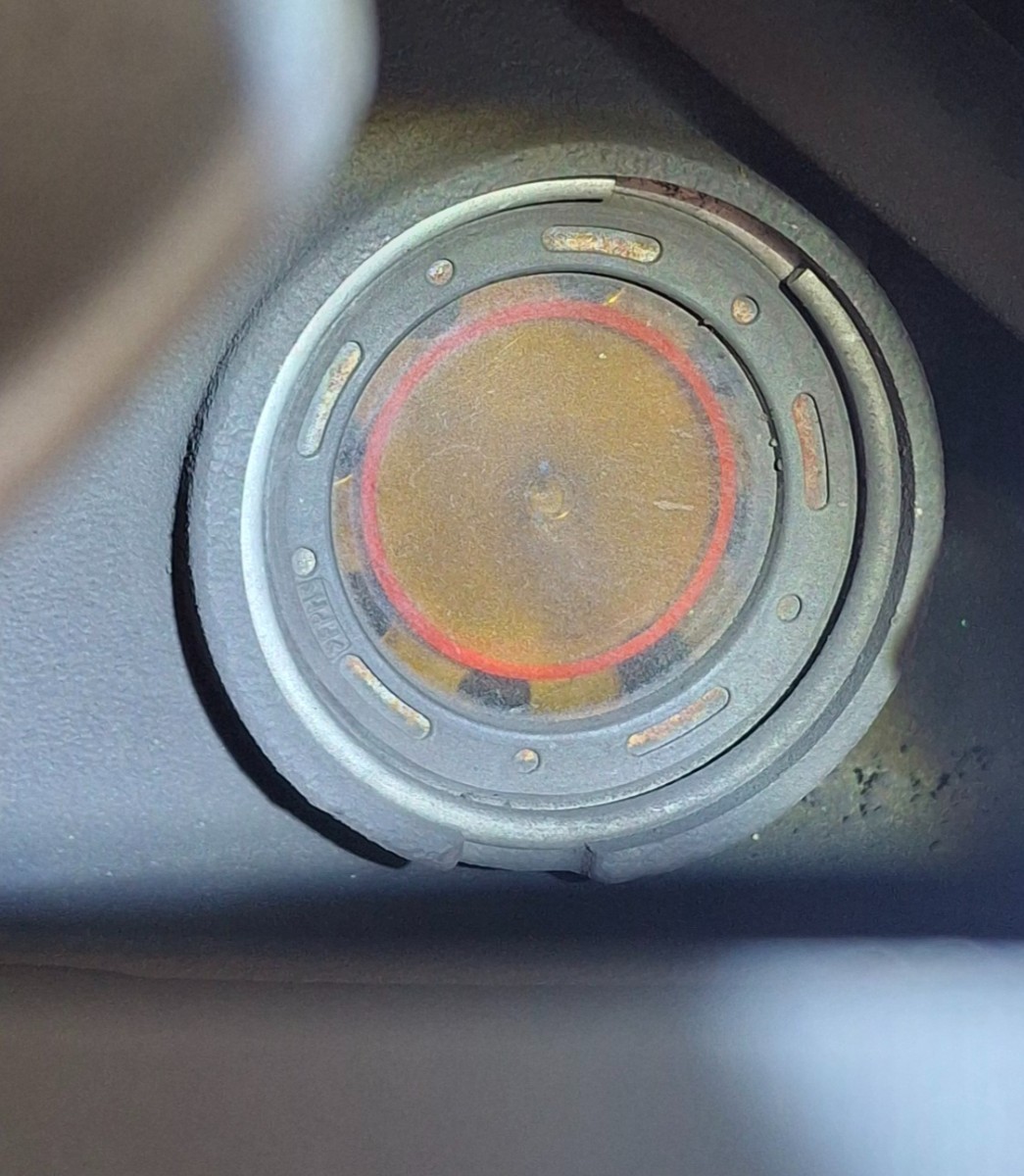

Is this window showing me full or empty?
- Willie Nelson

So..........Now, I don't know what to do. I've put in 3.8 of oil (I THINK), and now I can't read the window. Is there too much ? Is there too little?
How do I fix this?????
Should I now loosen the drain bolt? And watch the window to see if the oil horizon line shows up???
What would you do next?
- Willie Nelson

Strat Tuner wrote: Thu Mar 27, 2025 8:32 pmIs this window showing me full or empty.
That looks full to me.
Re: Tools 1st oil change
Strat Tuner wrote: Thu Mar 27, 2025 8:42 pmWhat would you do next.
If you've put 3.8 litres of oil in and haven't run the engine to fill the oil filter, I'd be surprised if the oil level is too high.
Whilst watching the sight glass, run the engine, the oil level will be seen to reduce.
With the help of an assistant, lean the bike over on the righthand side, the oil level should be seen to reduce.
My 2012 Camhead probably has a little too much oil in, I'll just ride it until some is used and the level reduces itself.

yes two mile look to heat it....still fulll....how do i take oil out a little at a time?
ANSWER: loosen the drain plug until a small amount (one dixie cup full) spills out. Tighten it back down to stop the flow.

David. wrote: Thu Mar 27, 2025 9:32 pm That looks full to me.
I was guessing that too....how to take oil out now? to lower it?
