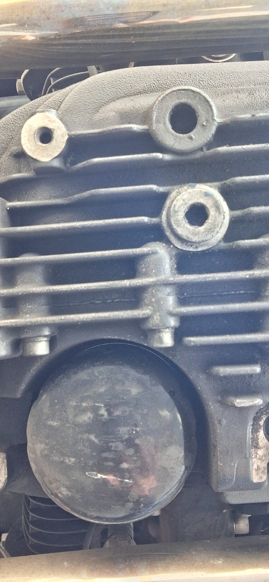

I'm gathering tools and advice for 1st oil change.
Here's the underside.
I think I can tell which is the oil filter.
One of the others is the drain bolt.
Which one???
None have a HEX head.
What tool removes the drain bolt?

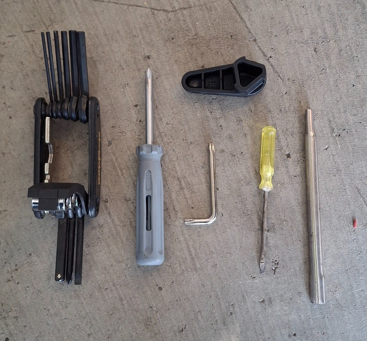

Here are the tools it came with. None of them look right.
Yes, I've read the paper service manual and watched at least one YouTube video.
Is it possible to replace the unusual drain bolt with a hex head?
Any advice is welcome!

Re: Tools 1st oil change
Strat Tuner wrote: Mon Mar 03, 2025 12:25 amI think I can tell which is the oil filter.
This is the BMW oil filter wrench $68.78, https://shop.maxbmw.com/fiche/PartsDeta ... T_11_4_661 others are available.
EnDuraLast oil filter wrench $6.99, https://www.euromotoelectrics.com/BMW-O ... 12g554.htm
Strat Tuner wrote: Mon Mar 03, 2025 12:25 amWhat tool removes the drain bolt.
8mm Hexagon bit or Allen key.
Strat Tuner wrote: Mon Mar 03, 2025 12:25 amIs it possible to replace the unusual drain bolt with a hex head.
A hex head drain bolt would reduce the ground clearance of the sump.

Thank you for that reply and especially for the photos!
I'd guessed correctly about which bolt was the drain plug, but I was thinking it was a Torx wrench I'd need.
I've ordered the oil filter wrench for the BMW oil filter. I'll be replacing that with K&N brand just because it's what I'm used to.
