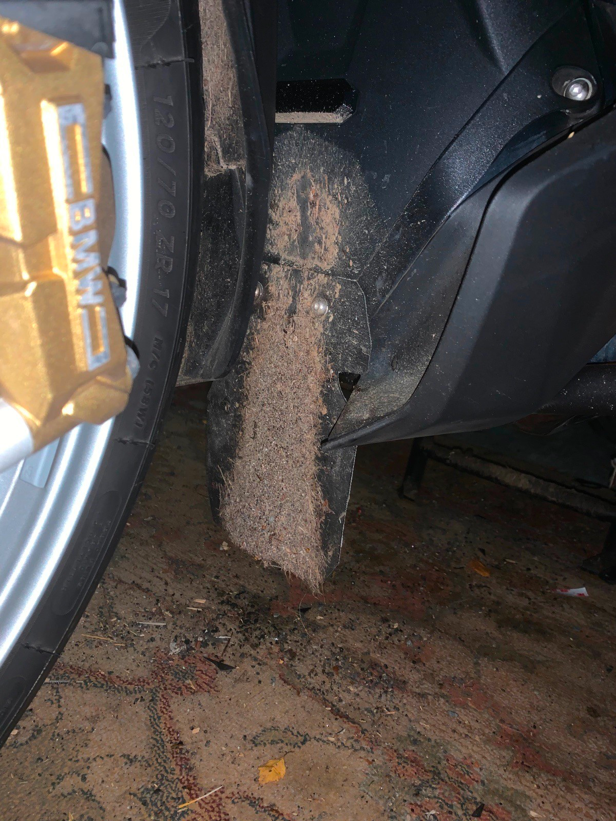

A solution I've seen on a Camhead to protect the exhaust system and centre stand is to fit a mudflap to the rear of the sump. The mounting points used were the two rear bolt holes which a bash plate would be fitted to. Bash plates themselves are available for Wethead RT's, one fitted would protect the sump and could be extended rearwards.

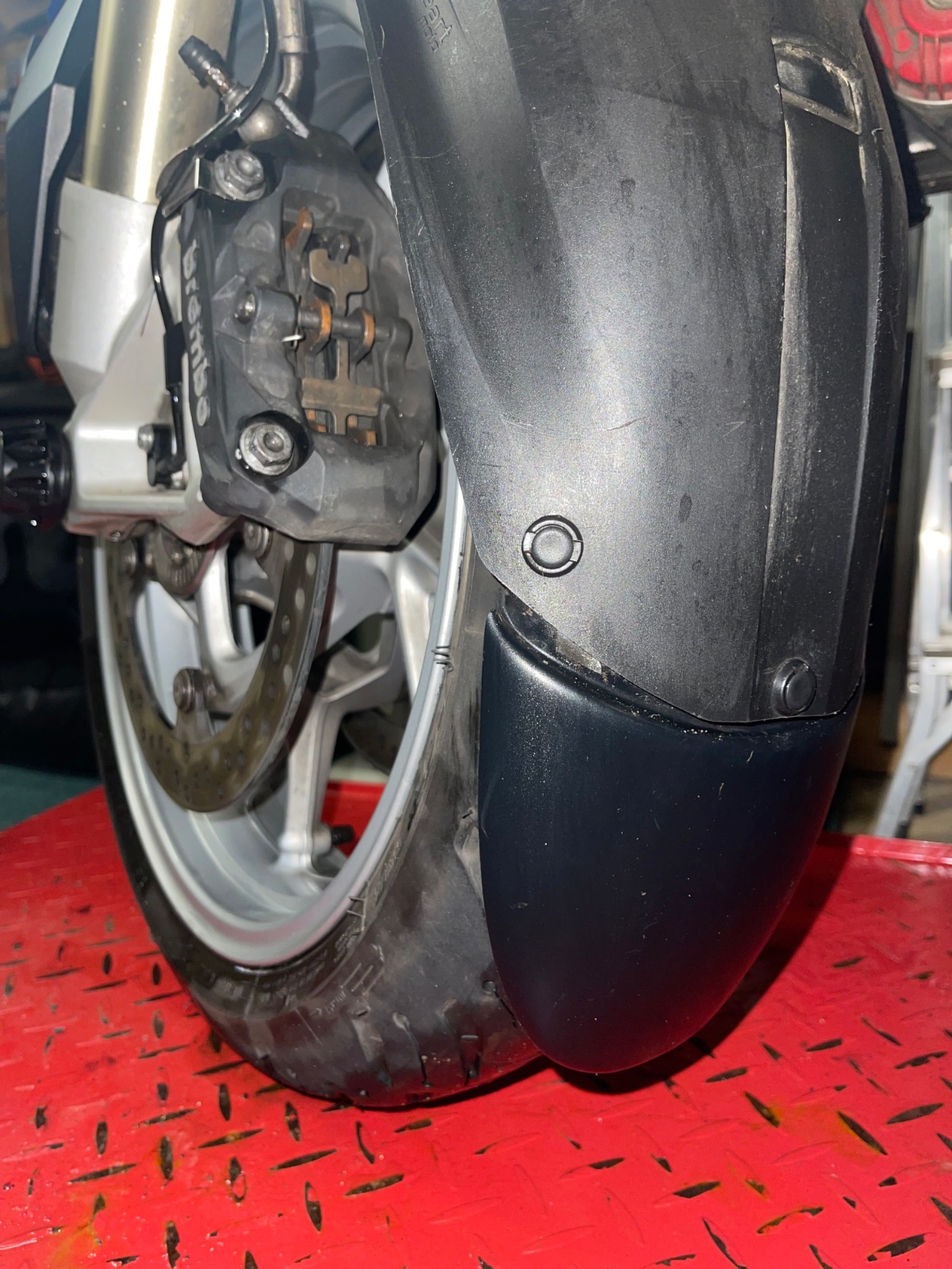

A mate of mine has ‘doubled up’, he says there’s very little muck or water hitting the front engine cover

Steve398 wrote: Thu Jan 05, 2023 6:40 pmA mate of mine has ‘doubled up’.
That looks like a MachineArt Moto fender extender with another one clagged on the bottom of it. Good idea, if it does the job, why not.
I changed my original fender extender for a MA M one and still have it so could do the same.

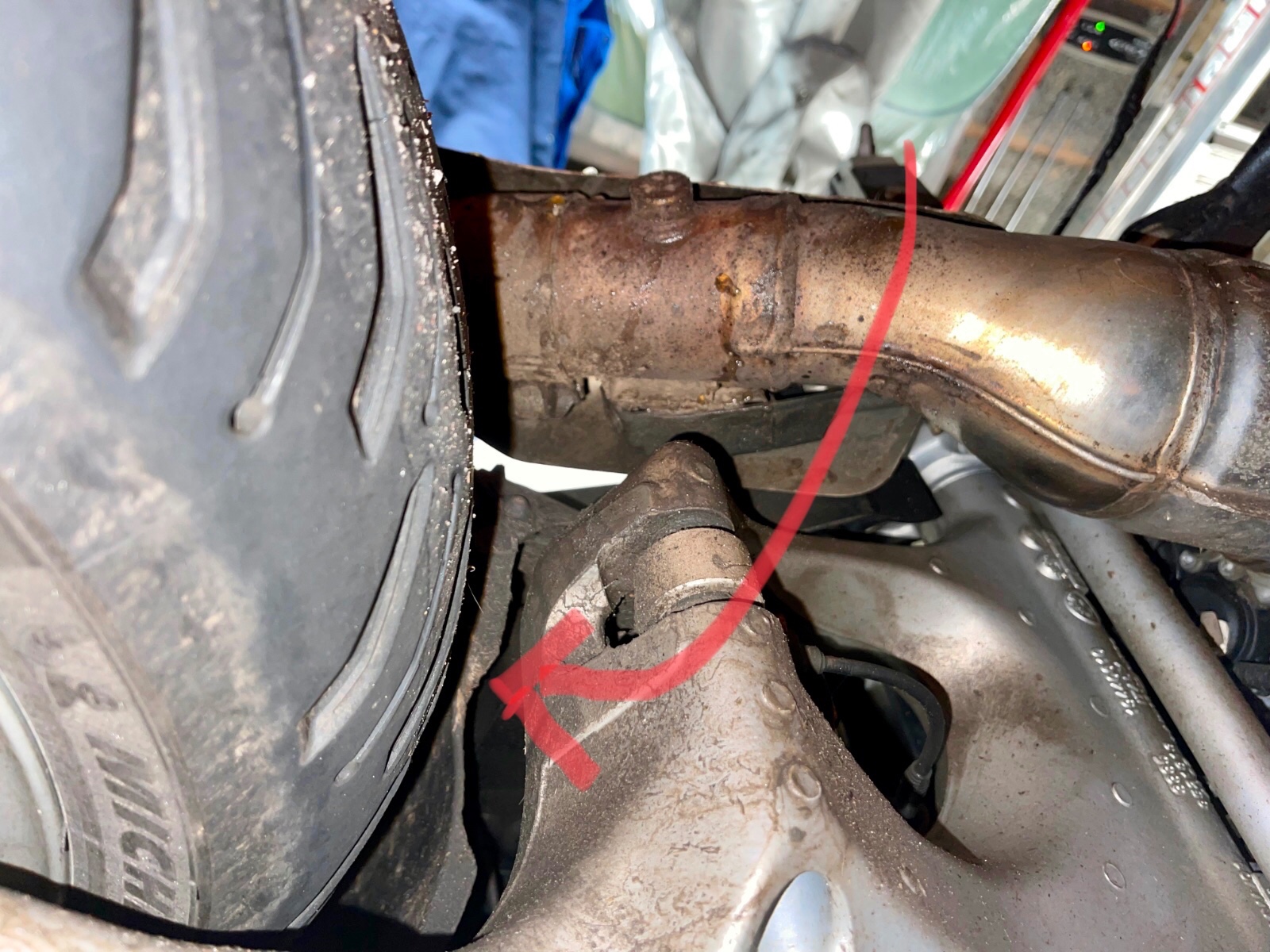

Still no solution to the problem caused by the rear wheel/tyre and debris getting onto the swing arm/rear shock pivot point.

David. wrote: Fri Jan 06, 2023 10:27 am Still no solution to the problem caused by the rear wheel/tyre and debris getting onto the swing arm/rear shock pivot point.
Reading through the thread - an extension from the front section of the rear mudguard would protect the mount from the rear tyre, I’ll have a better look when the the back wheel and silencer is off.
and as Excellence suggested on another thread the repurposed conveyor belt mudflap should reduce the mud/debris from the front wheel thrown under the sump and onto shock mount.
These mods won’t cure the problem entirely, but in respect of cost and effort I think they’ll certainly help

To protect the sump and forward facing shock mount, I think I'd prefer the flexible mud flap between the engine spoilers.
The "doubled up" fender extender leaves an amount of unsupported plastic on the front mudguard. It's rigid and close to the ground.
