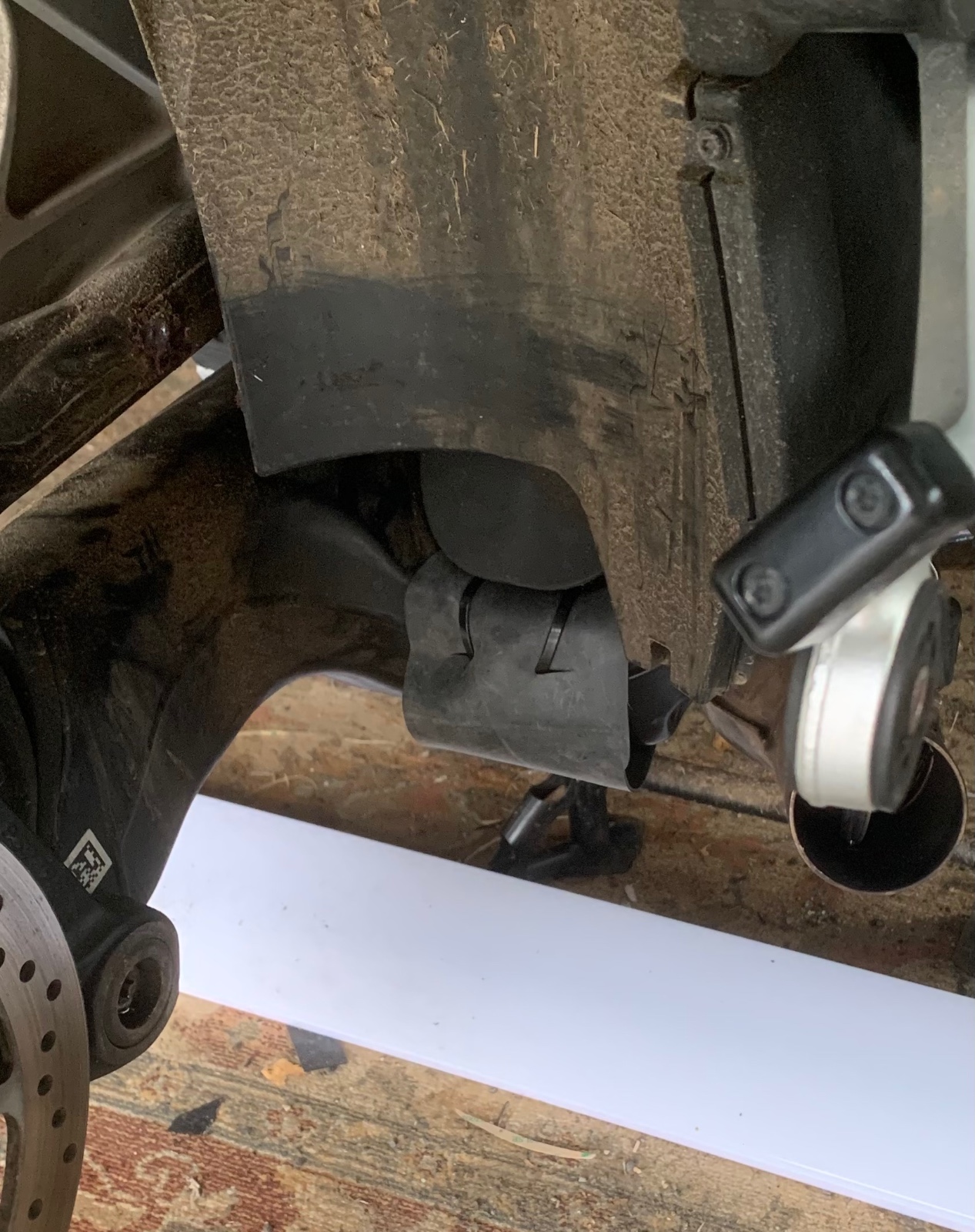

Now I'm sober, (Happy New Year to everyone) this morning I had a look at the swingarm to spring knuckle. Even after only 5/6k miles it was filthy and was only going to become worse I reckon.
This is a 'let's see what happens' test solution to hopefully prevent a build up of potentially damaging or component life shortening road crud - easily monitored when riding up here once again becomes both possible and sensible.
If it proves the protection principle I can re-do it with more robust and better finished materials but I've a suspicion that it'll work fine as it is.

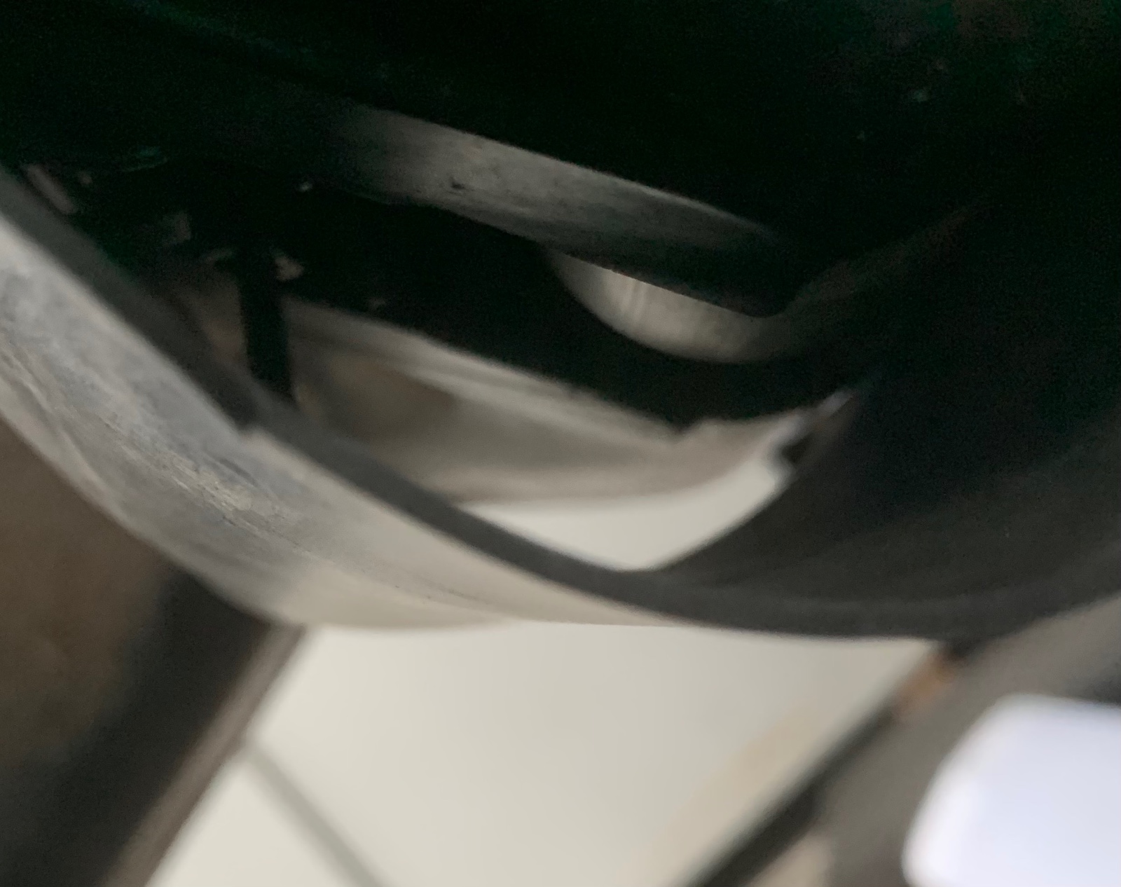

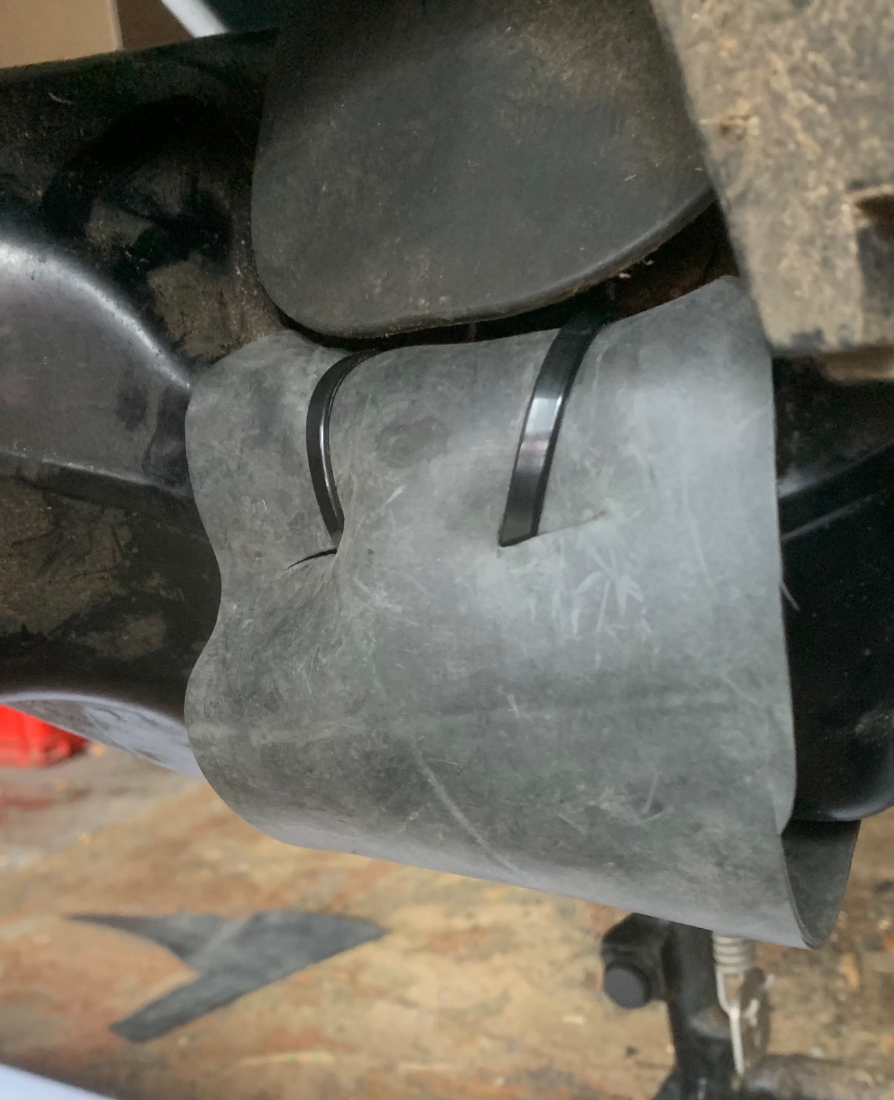

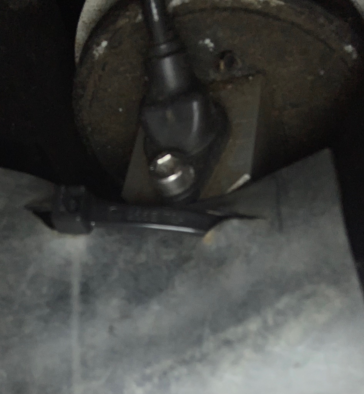

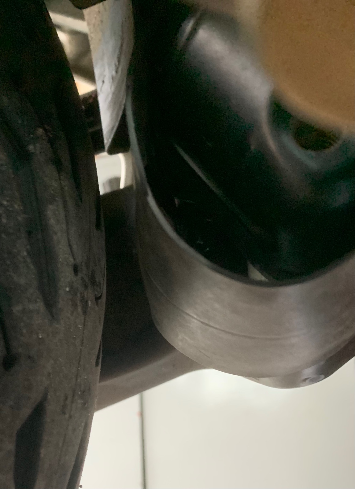

The idea was to use well flexible truck tyre inner tube bent round the knuckle and secured with reasonable quality tie wraps both at the front (1) and at the rear (2). As everything is flexible and soft-ish, any marks on the swingarm should be mild scuffing only and easily sorted but I'll monitor that.
While giving shelter against flying debris the arrangement is both clear of the tyre even under the mild flexing it'll experience and is able to drain easily as it's open both sides.
The only fiddly bit was persuading the tie wraps to pass around the knuckle and the swingarm without having to use any tools.
The top of the rubber was inserted into the space between the spring and the spring mounted protector to hopefully deter debris from slipping over the top of the swingarm to then drop into the knuckle joint.
Well... I'll keep an eye on it when I fire the bike up again.

Is that to protect the area from debris thrown up by the rear tyre.

Yes, I think that's the only place the crud could get in there from.
