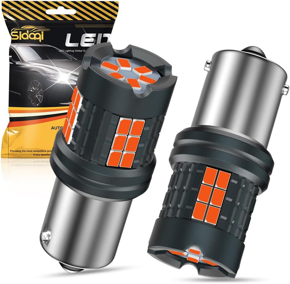

Today's success came in the form of two RED LED 1156 bulbs for the rear brake lights...
The CanBus god is Happy.

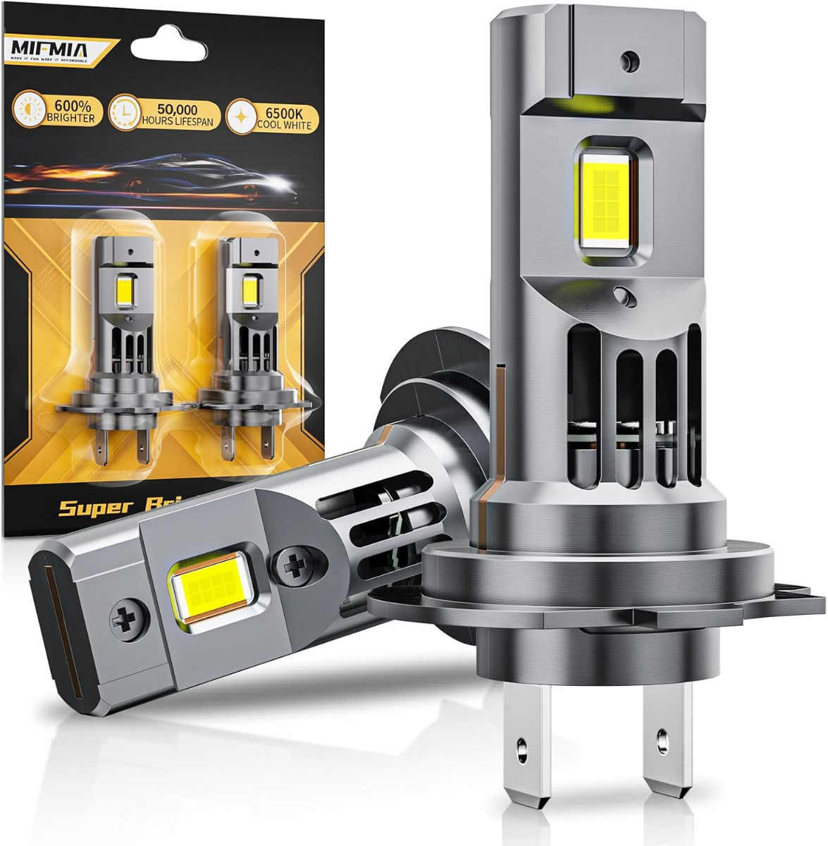

Here is a list of the things that I know worked in my 2008 R1200RT....none of the caused a CanBus error.
---------------------------------------------HeadLights:--------------------------------------------
2x H7 LED Bulb, 34000LM 800% Brighter 1:1 Size, No Adapter Required, H7 Bulb 6500K Cool White Plug and Play IP68 Waterproof Interior Lights, Pack of 2
bmw r1200rt headlight no canbus error.jpg (239.88 KiB) Viewed 5614 times
----------------------------------------------end Headlights----------------------------------------

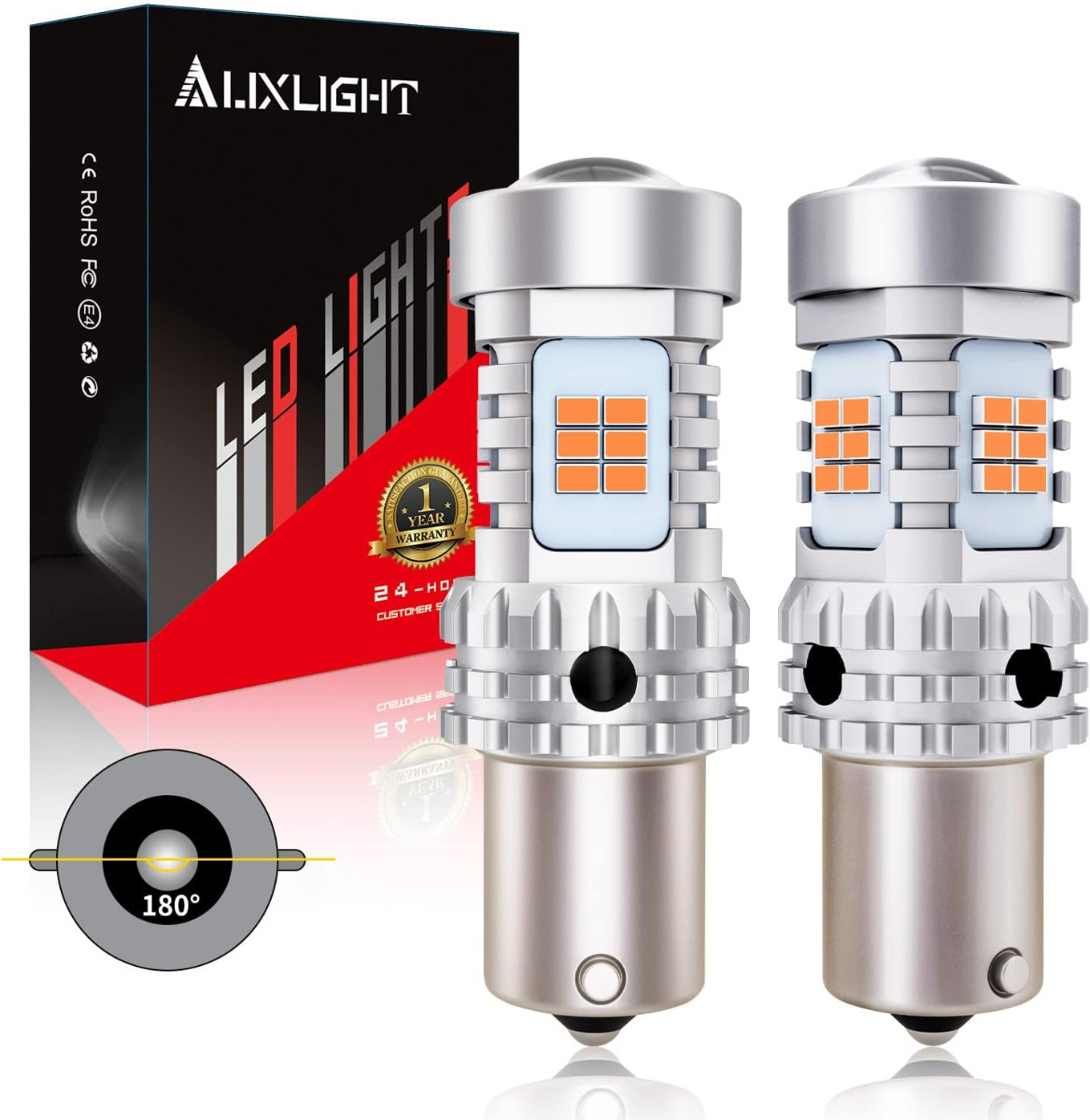

---------------------------------------------Turn Indicator Lights:(4) -----------------------------
AUXLIGHT 1156 BA15S LED Bulbs Extremely Bright 7506 1156A 1003 1141 P21W Canbus Error Free Replacement for Turn Signal Lights, 2200K Amber Yellow (Pack of 2)
bmw r1200rt Turn Signals no canbus error.jpg (202.14 KiB) Viewed 5614 times
----------------------------------------------end Turn Indicator lights-----------------------------------
---------------------------------------------Rear Brake Lights:--------------------------------------------
Sidaqi 1156 LED Bulb Red CANBUS Error Free Brake Tail Light 4000LM 30SMD P21W 1141 BA15S 7506 LED Blub Built-in Load Resistor Anti Hyper Flash for Stop Tail Brake Light 12-24V (Pack of 2)
bmw r1200rt rear brake lights no canbus error.jpg (152.32 KiB) Viewed 5614 times
----------------------------------------------end Rear brake lights----------------------------------------
