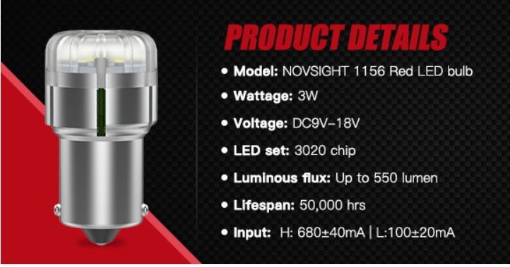

I found this.
https://www.amazon.com/gp/product/B09B2 ... Y1DMQ&th=1
If, IF, ....it really uses 21W, as it claims, then the resistance should be identical to a 21W filament bulb....???... I think.
Maybe W's are different between LED and filament? Who knows.

Re: LED upgrade for all bulbs
Sorry to say but you may be disappointed.
LED Bulb.JPG (51.88 KiB) Viewed 11433 times
Strat Tuner
Posts: 251
Has liked: 161 times
Been liked: 32 times
Post by Strat Tuner »
Copied from Amazon specs on the page I linked to...
"Light Source Type
LED
Wattage
21 watts"
I believe, in my post, I stressed If sufficiently.
Yes, I probably will be disappointed. I have been many times with this effort. It may be that $100 bulbs are the ONLY recourse.
At least Amazon returns are easy. :)
