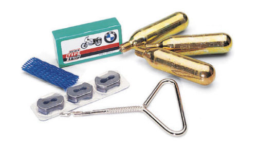

There has been some discussion on the K1600 forum about this product . Most of us have probably used it in the past as it does work.
However if you have tyre pressure monitors it must not be used as the system will be destroyed.. . Use a TipTop puncture repaid kit, also available with a BMW part number from your dealer.

New genuine BMW motorcycle tyre repair kit 71112332083
http://www.ebay.co.uk/itm/new-genuine-B ... 3641.l6390
Re: Ultra Seal
DaygloDavid wrote: New genuine BMW motorcycle tyre repair kit 71112332083
http://www.ebay.co.uk/itm/new-genuine-BMW-motorcycle-tyre-repair-kit-71112332083-/161431763924?_trksid=p2141725.m3641.l6390
I always struggle with this type - the rubber bands always seem to snap. I prefer Stop 'n' Go or simple sticky strings...

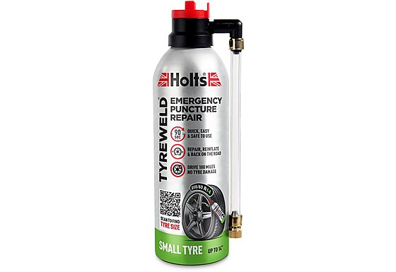

Have used Tyre Weld to good effect for small punctures.
Re: Ultra Seal
This stuff will also bugger up pressure sensors.
I once used one of these on a Land Rover parked in a garage. It came off the valve and covered the whole garage in a sticky film. lucky it wasn't my garage. .
