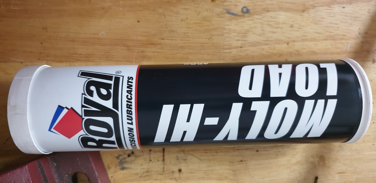

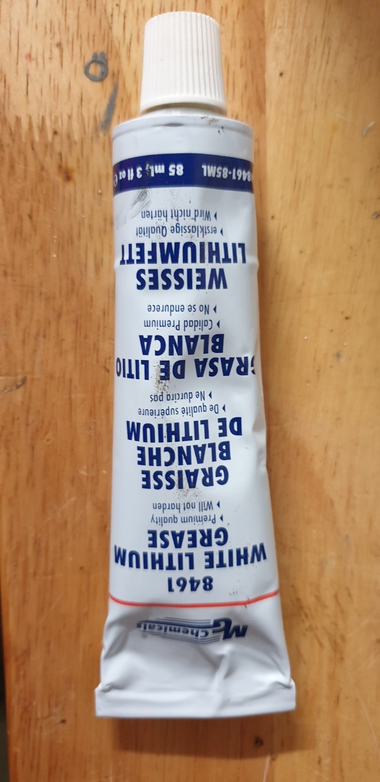

I can't get the suggested options in Australia. Obviously I could get the BMW branded tube from my local BMW dealer but I'd rather not have to mortgage the house.
White Lithium Grease to seal rubber boot (also used to lubricate slides on 3D printers)
A heavy duty molybdenum grease for final drive spline:
