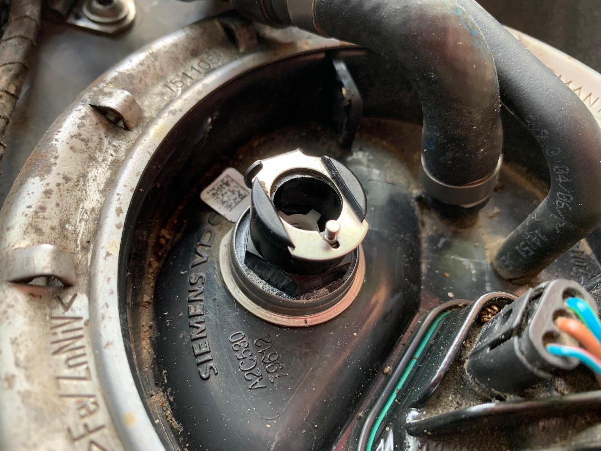

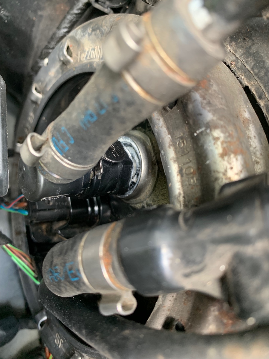

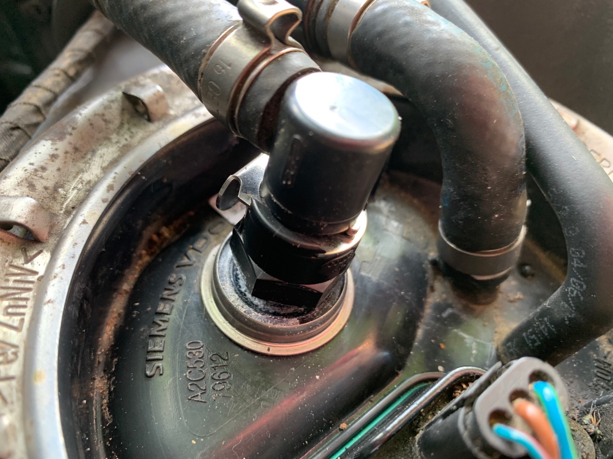

Hi Sorry to resurrect an old thread but... Stopped at service station to refuel on way for trip up to York and saw petrol dripping onto forecourt. Returned home and stripped off panels to find petrol spray coming from bottom of flange on petrol delivery pipe. Disconnected the union clip in and the whole unit has come away, pushed up by non return valve(?). Looking at previous posts mine has the metal flange which i think was the upgrade in 2014 but that was before me. Bit hairy riding back with petrol dripping down onto a hot engine.
Had a call in with BMW dealer in case i can get it as part of the 2021 "recall" but they would have to have it in and charge diagnostic at £115 pro-rata plus delivery costs before submitting a claim to BMW if they confirmed it was replaced and has failed again. Record that the recall was done but too old for records where etc, Quoted £426 with £66 labour if not covered by BMW. See photos. Probably look to used unit and swop out.
Any comments (spare fuel pumps top section!) welcome, Rob

Re: RT recall fuel pump problems
If I can get the top flange without the pump can it new swopped out with my existing pump etc? Thanks Rob
