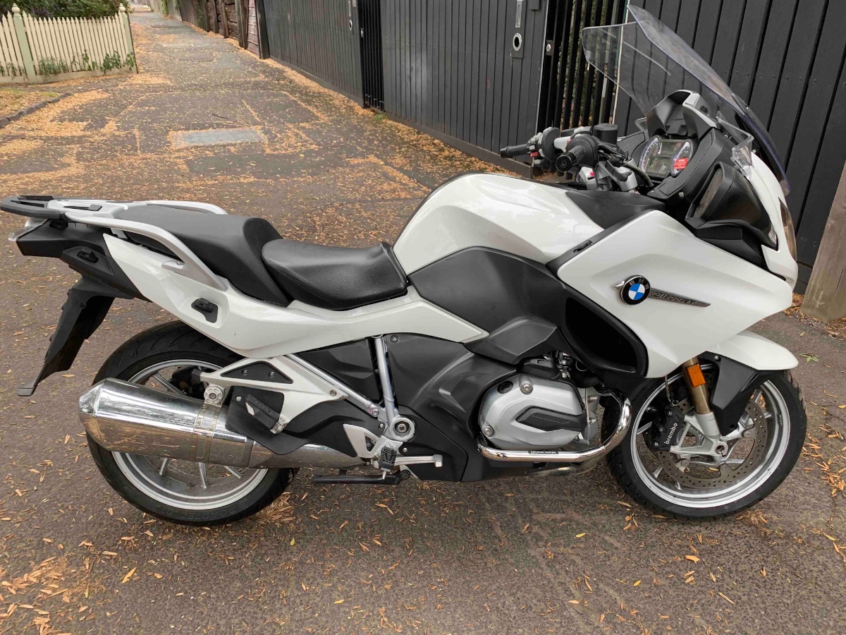

Here is an 2018 R1200RTP I converted. Went well. I hadn't anticipated the need to buy a standard horn and an EZYCan to run it all. The most costly part was getting someone to snip all the police wiring and tuck it away. I did all else, which was like Lego...and fun.
- finished.jpg (535.55 KiB) Viewed 7760 times
