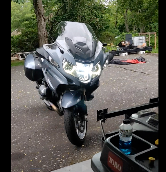

I have 2019 R1250RT US version and the main headlight is always on together with halo lights. I went to Europe and they have the option to switch off the low beam and leave the halo only...I guess my question is, is there a way to do the same on US version?

I have personally looked into doing this and I assume the process would be swapping your left hand control assembly and reprogramming the ecu to now recognize the extra button for turning on and off the low beams, or switching your bike into some sort of EU mode. I have not seen anyone on this forum or anywhere else attempt this mod before. Probably because it is a waste of money just to make yourself less visible on the road. I have not seen any EU style left hand control clusters for the RT on ebay and the BMW item index lists two model numbers for the part but makes no reference on which one is the EU version, or if the EU version is even for sale in the US. Honestly its more work than its worth, and thats assuming its even possible.

Thanks for info. Yes it definitely needs a new switch and ECU update/program, but I came across some posts, showing how to switch it off on older versions using a combination of turn signal switches, unfortunately it does not work on my 2019 RT. Wondering if someone knows how to do it on 2019 models...
