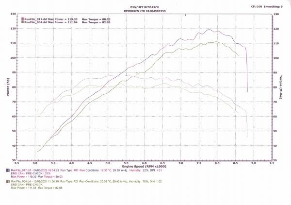

I had my '16 remapped yesterday. Ex factory it's rated 125hp / 92ft/lb - at the crank, which is probably 95hp at the back wheel. Unsure of torks at the back wheel. Anyway see attached. My bike has a K&N filter, stainless headers which are de-cat and have no flappy valve thing, and an akrapovic end can. Before the remap it was running 111hp / 82ft/lb - at the back wheel. Pretty healthy. After remap - 119hp / 88ft/lb - again at the back wheel. Low revs / throttle opening fuelling issues were what I really wanted to get sorted, the power increase is a bonus. Shame I'll be stuck in a car all day today, ah well I'll give it a run out tomorrow.

Post by Old-Git »
Well rode about 100 miles today and the difference is quite obvious. The "pinking" sound hasn't quite gone away, but it's better. It's been doing this since I bought the bike with 7k on the clock, new cylinder heads under warranty made no difference,  and the bike now has over 35k on it. Anyway the money was well spent, I reckon probably 135 - 140 hp at the crank, who needs a 1250 - not me. Crack open the throttle at low revs and pulls so much better, much easierto get it to rev to the red line, I'm probably in a gear higher than previously. Well most of the time. It's made keeping up with my KTM 1290 buddies a damn sight easier.

well it was in Dyna mode, I've no idea if the remap works on other modes, but I thought they just affected throttle response?
Headers are blackwidowexhausts.co.uk - great pipes, but you need to trim them to fit an akra, and they do tarnish quite quickly so clean them regular or get them ceramic coated (or whatever)
