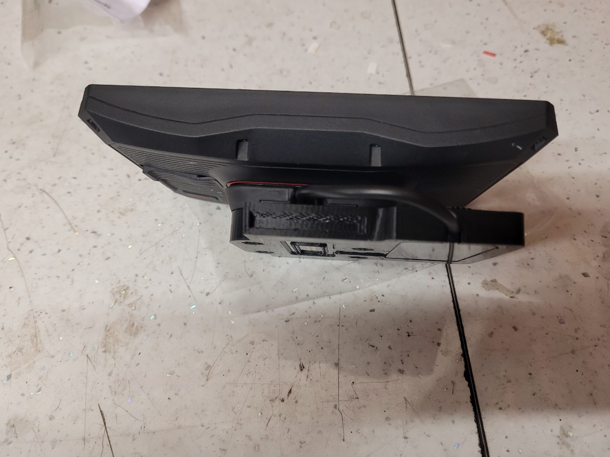

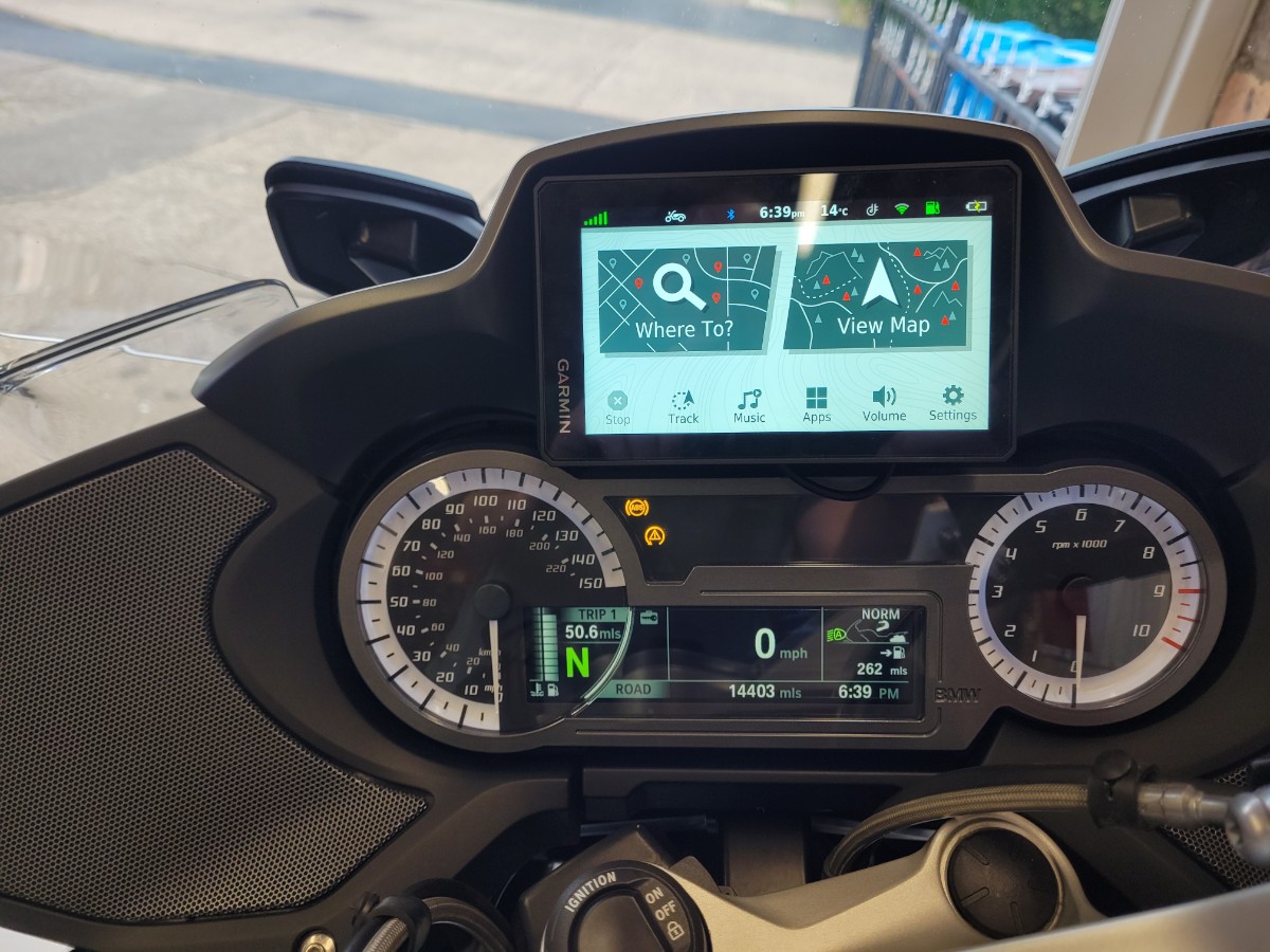

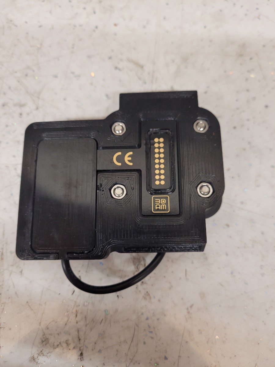

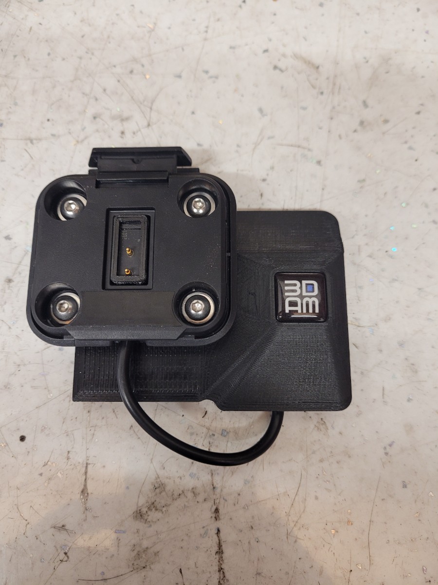

Zumo XT all the way for me
You can't use the wonderwheel but this is no biggie to me
Plus there is adaptors out there to mount it in the correct position too

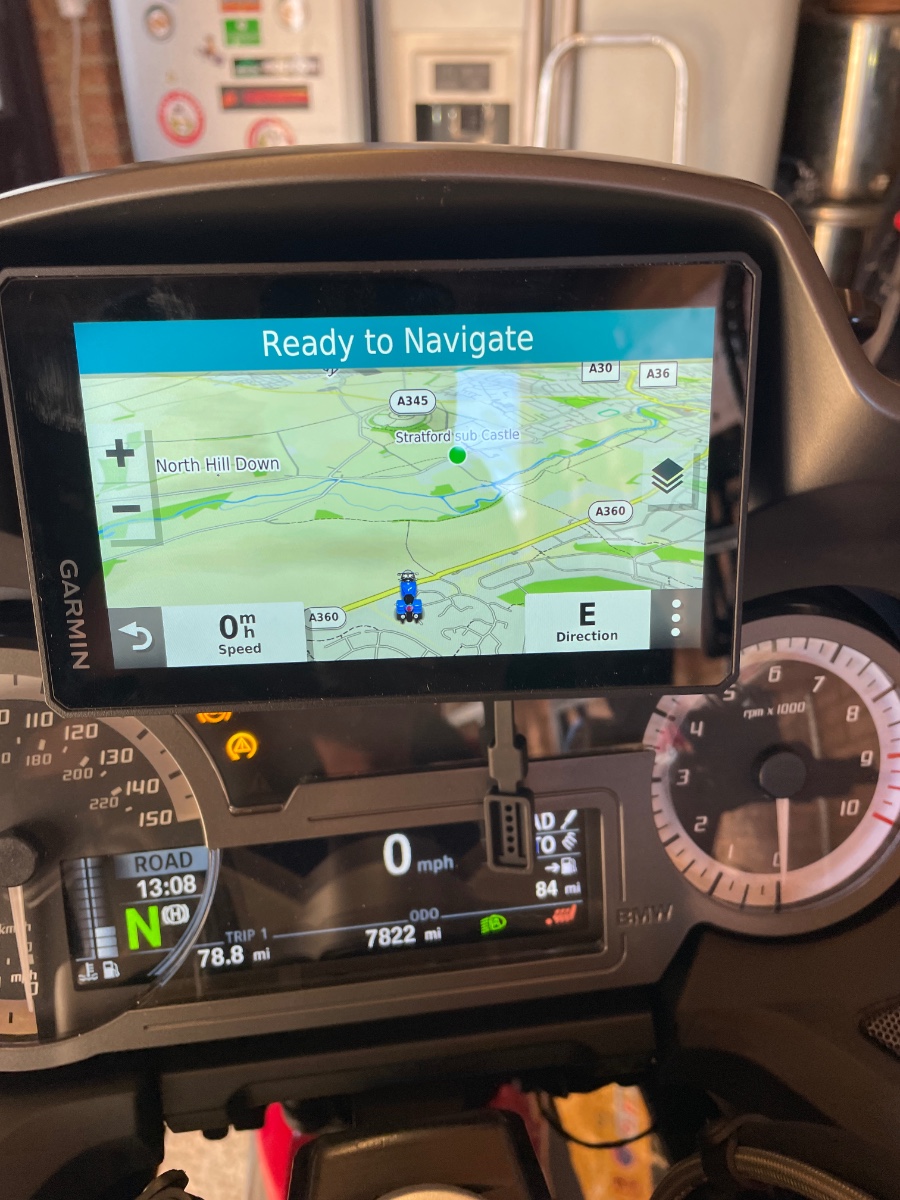

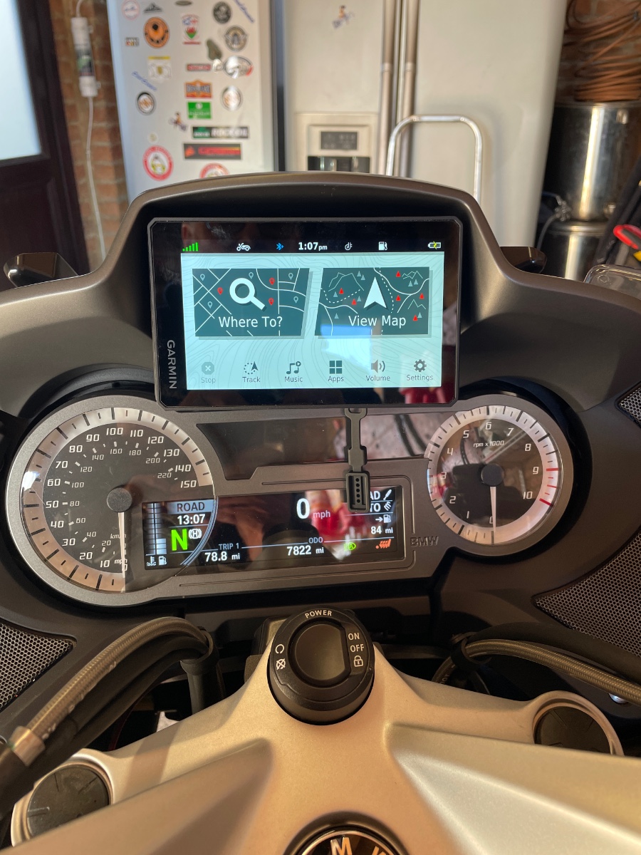

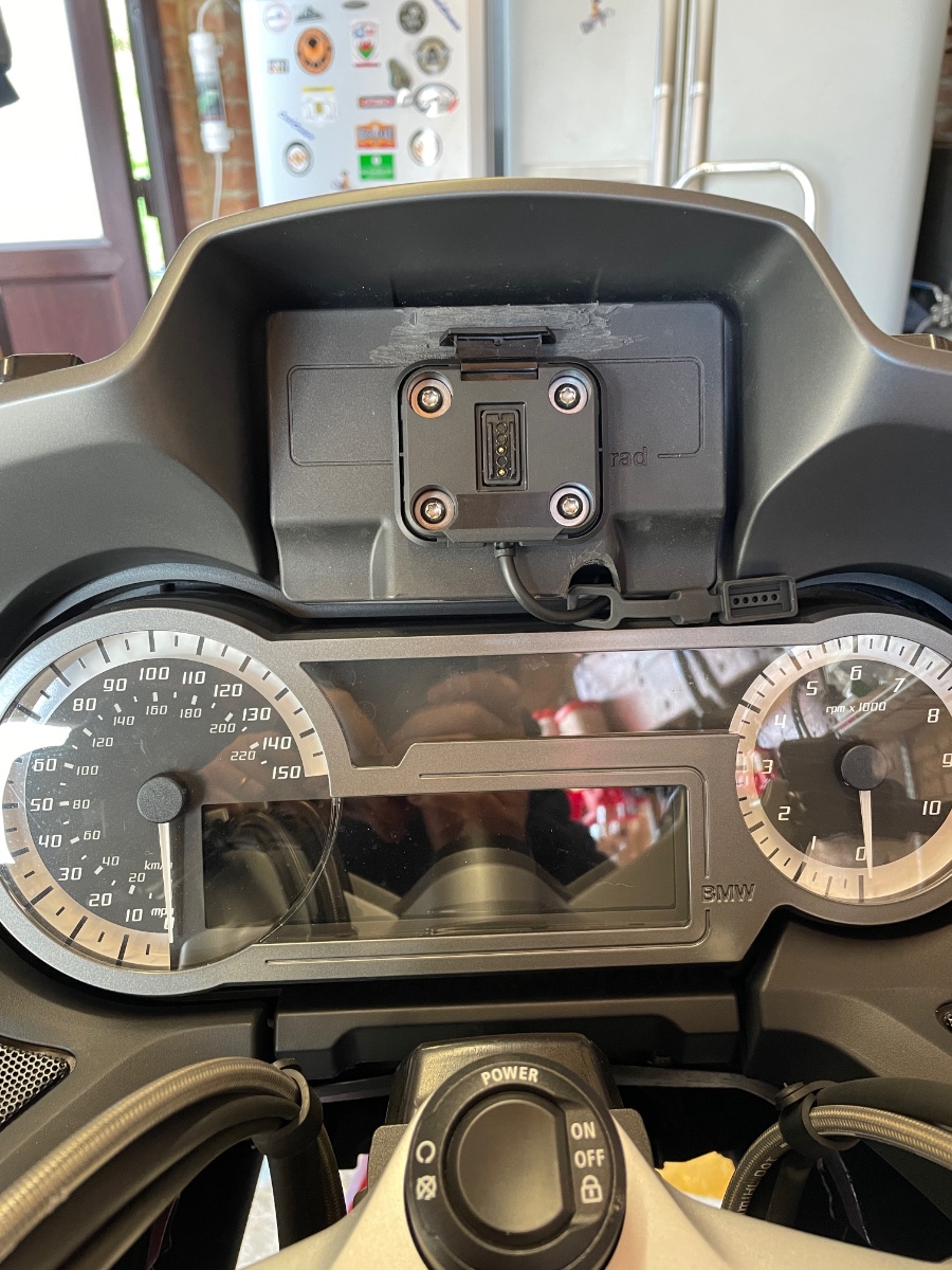

I used 4 x 40mm x4mm bolts with 4 x 30mm spacers. I bought the fly lead with the correct plug on, to connect to the same plug the Nav VI was powered from. I also had a spare Nav cover, which I drilled to mount over the original nav mount, so it covers it and acts as a backing to the zumo mount.

Thanks Casbar. That's kind of what I was thinking of doing, using the Nav VI mounting plate. Can you give me any more details about the "fly lead" and the "correct plug" for the power?
Re: Nav VI
This is the lead I used, think you can also buy direct from BMW https://www.motorworks.co.uk/wiring-rep ... 585-1.html
