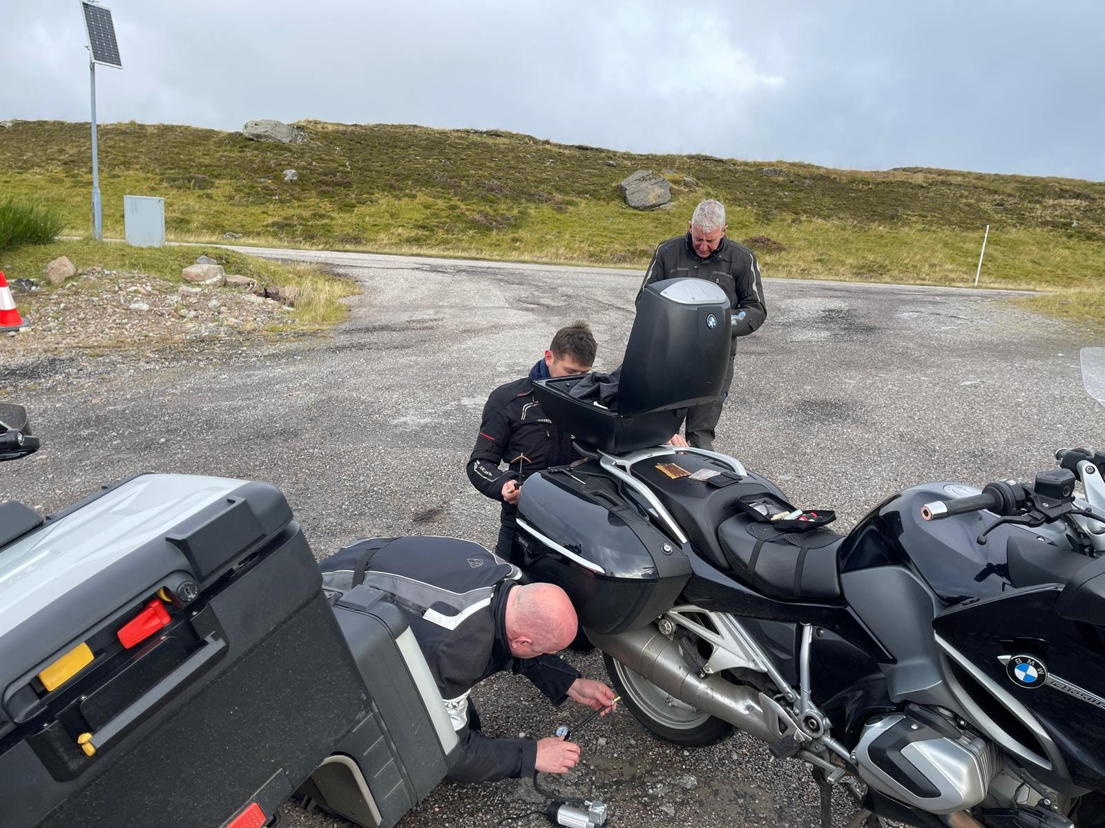

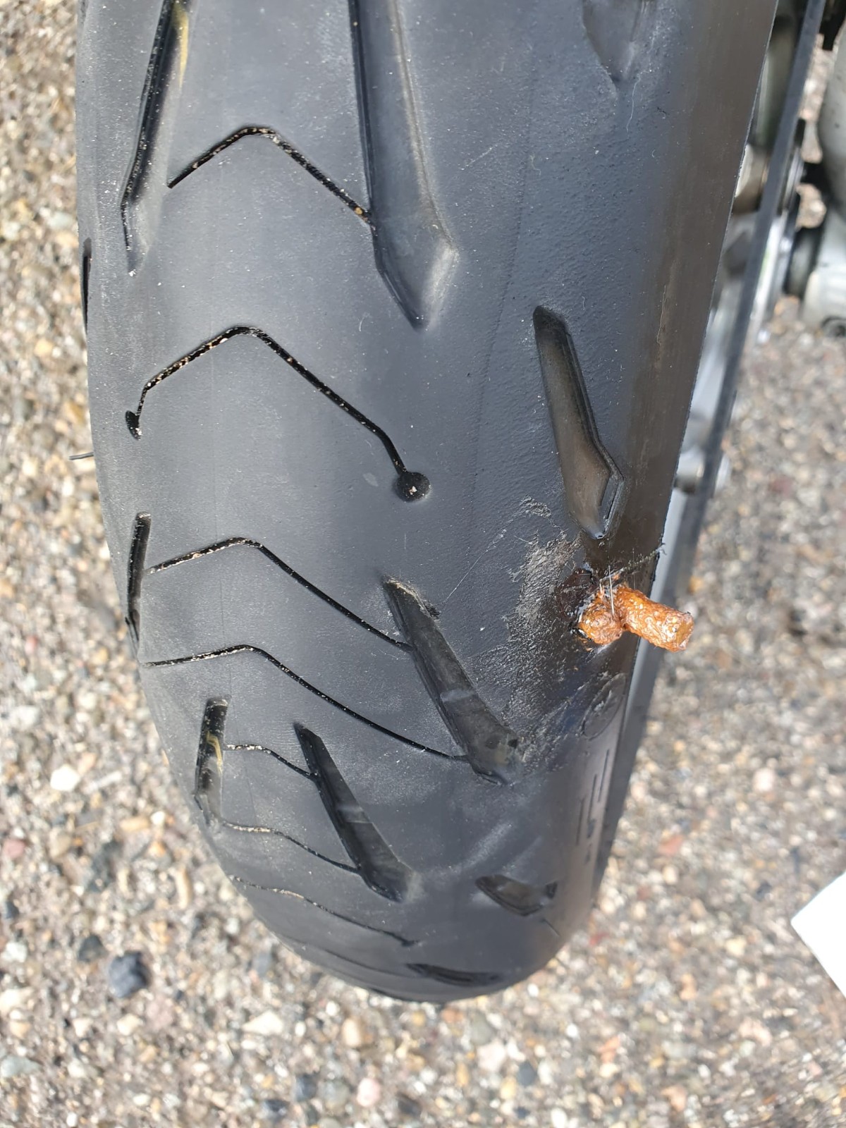

First puncture in 30 years yesterday, just had to be in the middle of no where on the Isle of Skye.
Luckily had my support crew on hand to help me sort it. Nail out and repaired in about 5 minutes.
Seems to be holding up which is good because there's another thousand miles to do before home.
