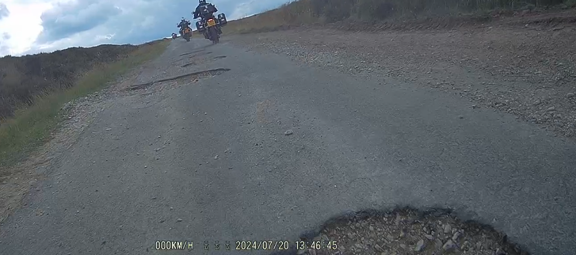

Don't think I would be able to put a claim in for those on this road
Anyway checked with rim and its less than 1mm out so I'm not worried about it
