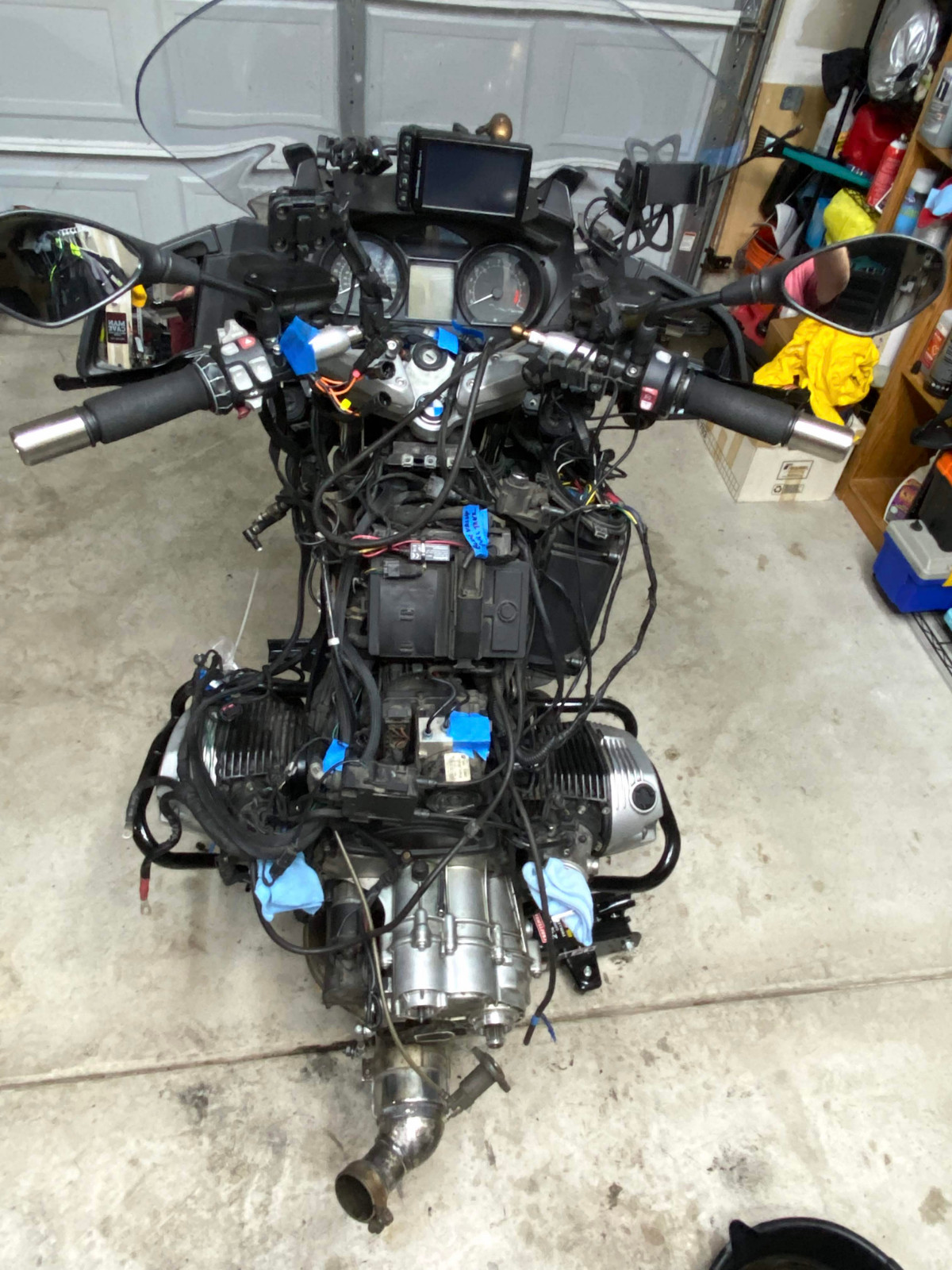

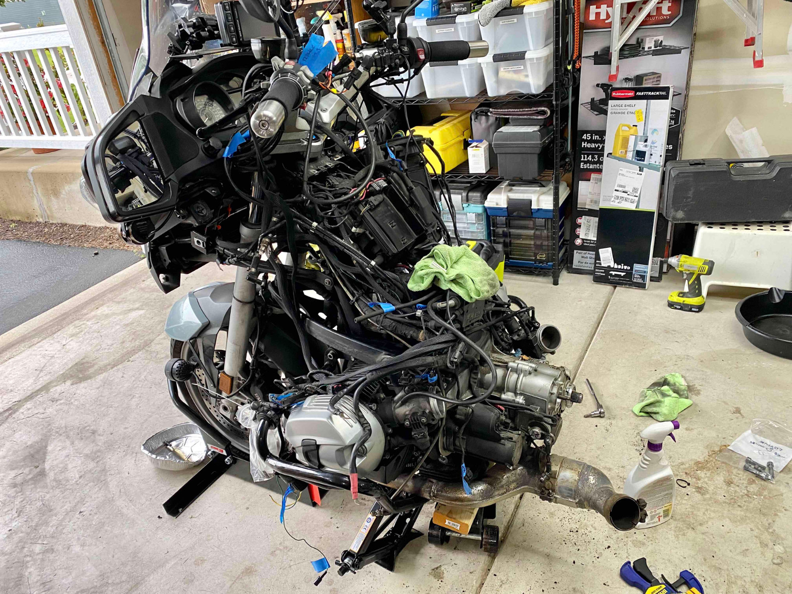

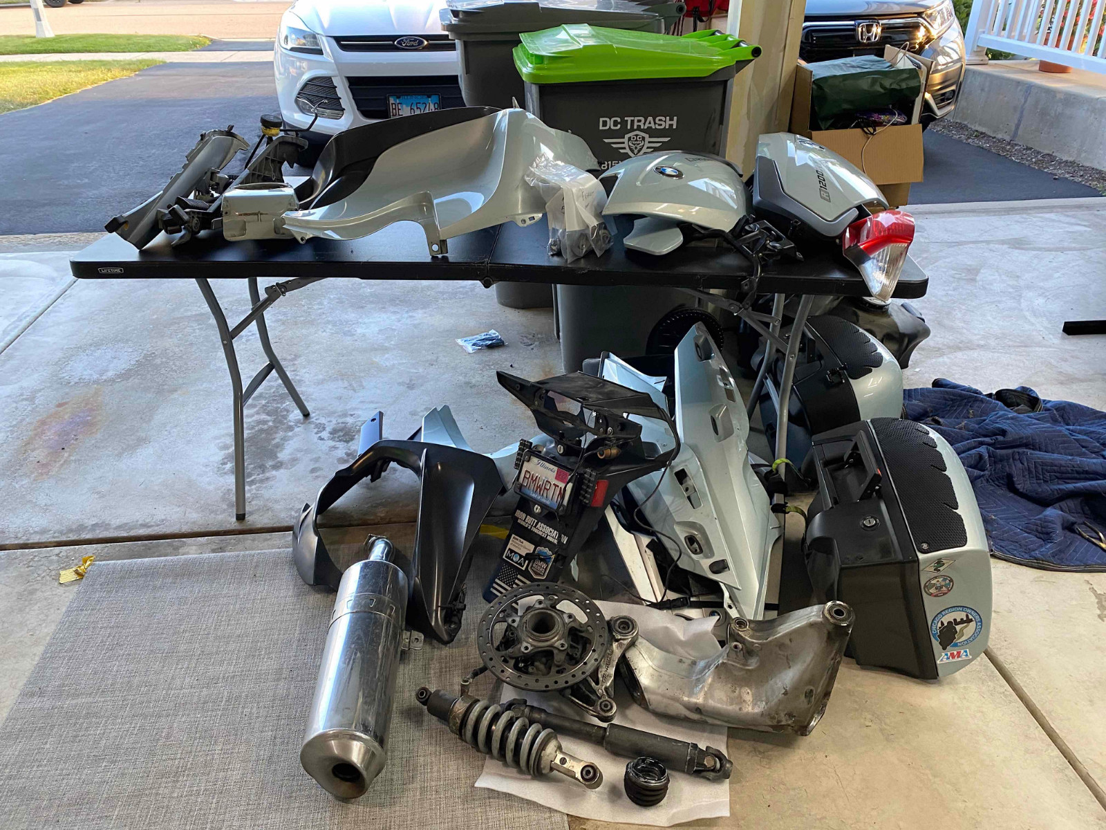

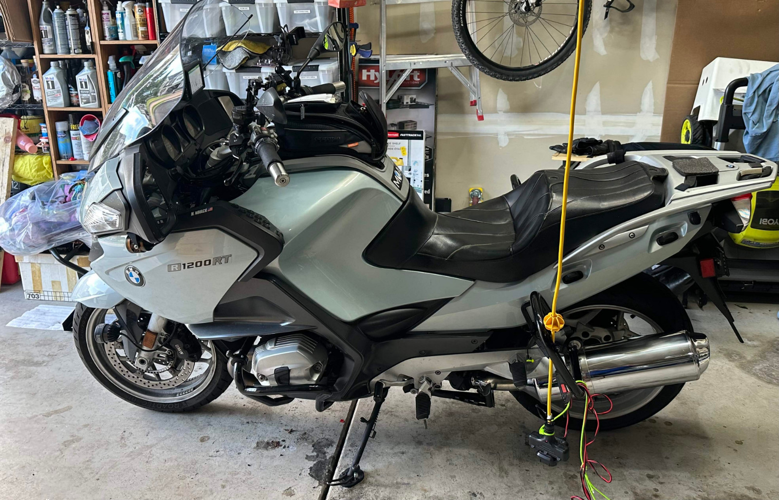

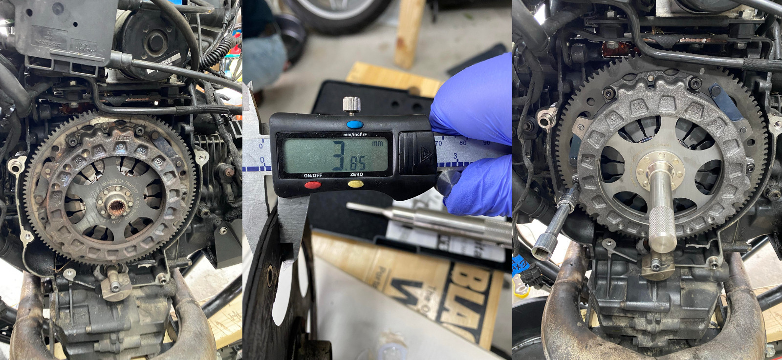

I did the clutch on my 2010 RT in September 2022. Bike had 95,300 miles on it, now has 99,800 and all good. I bought the kit from Euromotoelectrics out of Denver, CO. Kit included the Pressure Ring, Clutch Plate, Clutch Spring, Pressure Plate, and Bolts. I did buy a slave cylinder as well after I had issues with clutch not releasing after job was completed but that was due to a bleeding issue and just needed a bit of wearing in. I pretty much had the new clutch in a replaced over a 3 day weekend but the entire job was about 2 weeks due to some welding I had done to frame, a few days to get a slave and I did some rewiring while I had the bike so much apart. I was able to do most on my own but for some of it you really need another person or two to help remove/replace rear frame and some other steps its helpful to have others to help.
I opted to not do the seals unless I saw them leaking, I heard opinions on both sides and I realize it will be a lot of work to go back in, but working in automotive we rarely see leaking at these seals even at high mileage so why fix something not broken. I think the only tool I needed that I didn't already have was the clutch centering tool, but if you are doing the seals you will probably need some additional specialty tools. It was not a highly technical job, I am not a technician but a service manager in auto so I'd say mechanically inclined and knowledgeable. It is a time consuming job, a lot to take apart to get to the clutch. I purchased a bunch of parts bags that I wrote on with marker, took lots of photos and videos of locations of items and made notes on bags about any details I might need later. My situation was a bit more complicated as I have a lot of add on wiring for lights and other power leads - made for some extra work as these were added over time with minimal disassembly of bike. I did have a shop manual, I forget if Hayes or Clymer, it helps but lots of flipping around to get info as it doesn't just show the procedures for the clutch as steps in order but you go from chapter to chapter to work on various sub assemblies of bike.
I did watch a number of videos and read all I could but were a few surprises, just do it methodically and label parts, take photos and make notes! This will help when you go to put it all back together trying to recall what went where or how. I'm sure I saved $$$$ although it did take time and I hope this one lasts another 90K+ or I am riding a new bike by the time it needs another, although I am sure I could do it again much faster.
Let me know if you need any other info. I see you are just up north of me in WI.
