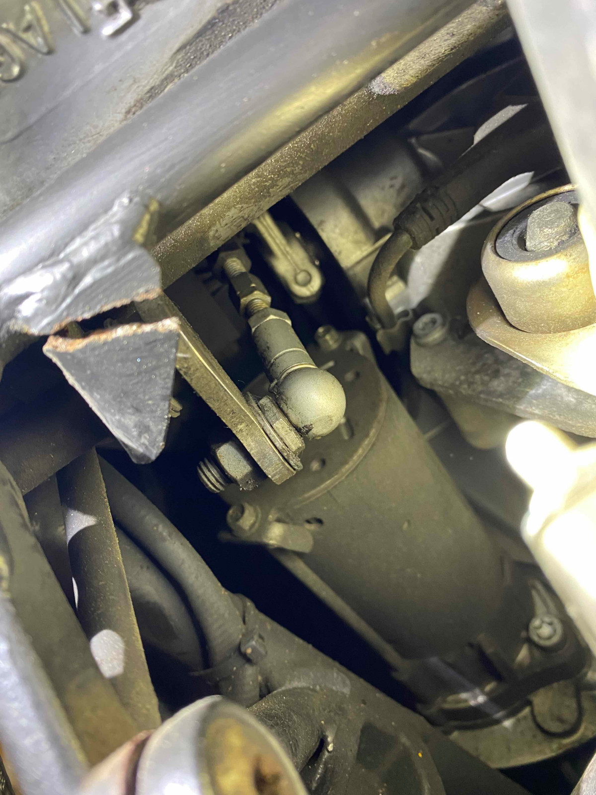

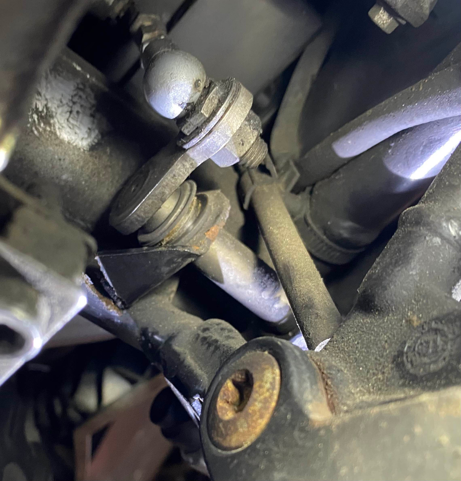

There has been some discussion in the "Winter Maintenance" thread about gear linkage lubrication. Found a thread on R1200GS.INFO which suggests that BMW now recommends to remove grease from the shift lever. https://www.r1200gs.info/threads/update ... %20bearing. Although a different set up, there is a PTFE bush on which the shift lever pivots. On my Camhead, the bushes also look like PTFE, this would suggest that grease should not be applied. Whilst lubricating the cup & ball joints is probably good practice. Any comments would be much appreciated before I reassemble the gear linkage.
This is what the Camhead bush (#8) looks like, is it PTFE.
"A PTFE-bearing is maintenance free; do not lubricate the bearing."

I am led to believe that ptfe can swell when exposed to certain lubricants
So probably best to do as it says and not lubricate it
I would give everything a good clean too

Any recommendations on the best type of grease for the cup & ball joints, (waterproof would probably be a good start). There appeared to be some evidence of a white type grease on the lower joint when dismantled. Part #9 is a plastic (foam type) washer, this is possibly there to help keep water and dirt out of the joint. I'm pretty sure, (need to check), that this was missing from the upper joint which was in poorer condition and slightly corroded. Think I'll order a couple of new washers for reassembly.

David. wrote: Wed Dec 07, 2022 10:49 pmPart #9 is a plastic (foam type) washer, this is possibly there to help keep water and dirt out of the joint. I'm pretty sure, (need to check), that this was missing from the upper joint which was in poorer condition and slightly corroded. Think I'll order a couple of new washers for reassembly.
Checked this morning and I wasn't seeing things. There is definitely not a plastic/foam type washer on the top (gearbox) cup & ball joint. This is the one which was slightly rusty. Whereas on the lower (shift lever) joint there was evidence of some assembly grease. Shows that the washer must be there for a reason.
Have ordered two replacement washers (£1.50 each) from my local BMW car dealer rather than a 70 miles round trip to a Motorrad dealer or pay postage. They will be available for collection tomorrow.

I've lubricated mine regularly since the weld on the shifter mount cracked with 150 miles to get home from a 1000 mile IBA ride. Bike had about 80K on it at the time it happened. It became hard to get back into 1st gear but I made it home. Can't be sure if it was due to lack of lubrication or binding of the linkage or maybe it was just a flaw in weld or corrosion. I don't recall the shifter feeling unusual, but it may have been binding a bit as it seem to require a bit more effort, but that could have been as it was breaking and I hadn't noticed it yet.
Luckily I was able to find someone to weld it and it held up and when I had the rear subframe off to do the clutch he reinforced it and was able to get welds on all sides. I now regularly lubricate it with grease with teflon and have taken apart the joints and cleaned them as well as replaced the nylon parts. It seems to move much better when kept lubricated and clean.
