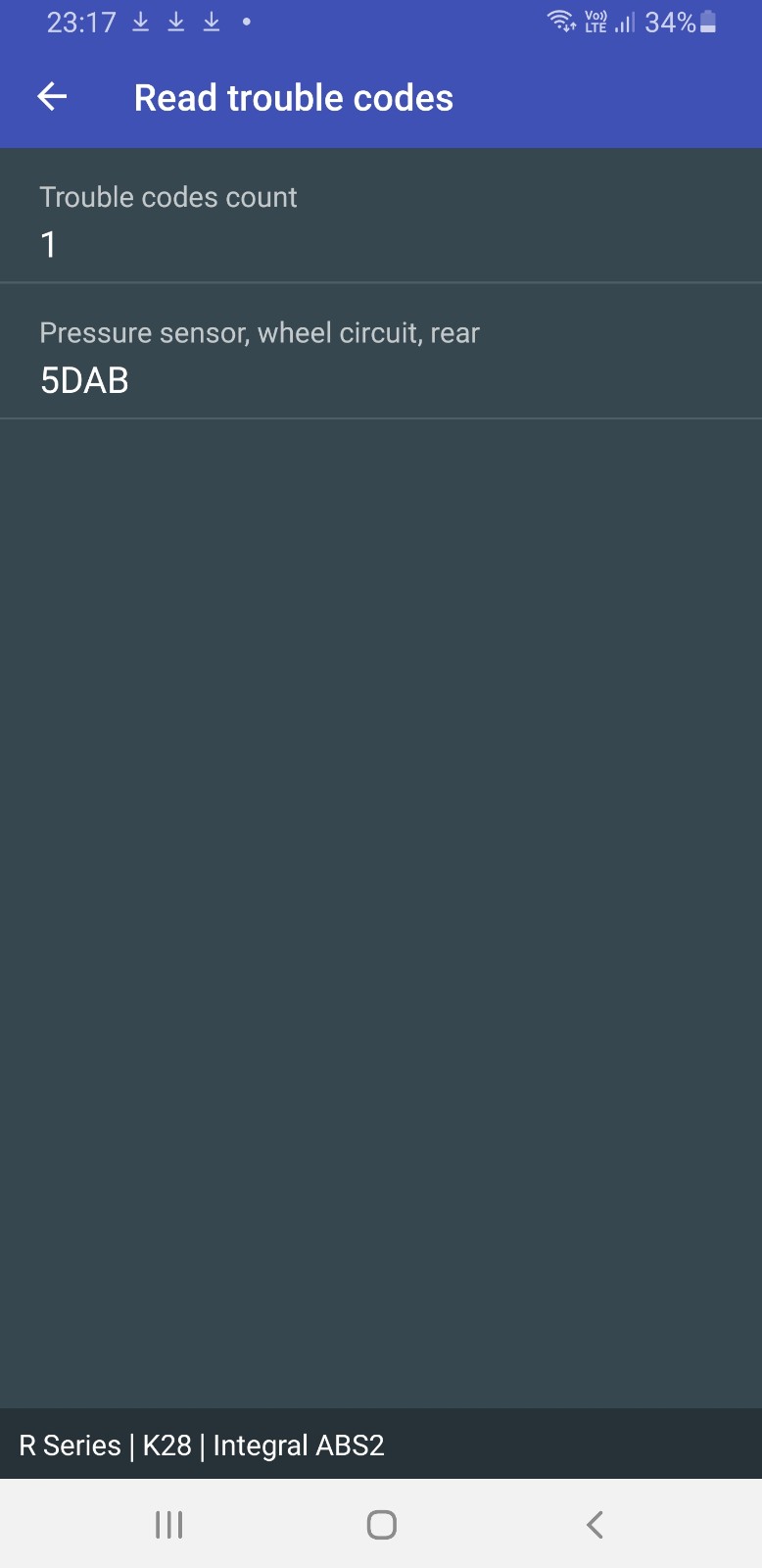

Well it has started throwing up the error when I first start off. Interesting to note that when the ABS fault occurs, the brake light stays lit until the bike ignition is turned off.
If you see this error on your dash please make sure you don't have any vehicle behind you as you slow down to pull off the road. A truly odd safety feature if ever there was one.
The latest output of Motoscan app can be seen in the attached screenshot....
- Screenshot_20230228-231713_MotoScan.jpg (45.54 KiB) Viewed 6164 times

Re: ABS red warning light coming on intermittently
The brake light switches are integral with the ABS control unit. Could this now be pointing towards a problem with the ABS unit itself.Marvin2Shoes wrote: ↑Tue Feb 28, 2023 1:19 pmInteresting to note that when the ABS fault occurs, the brake light stays lit until the bike ignition is turned off.
AFAIK, with the ignition on, the ABS pump is running.
