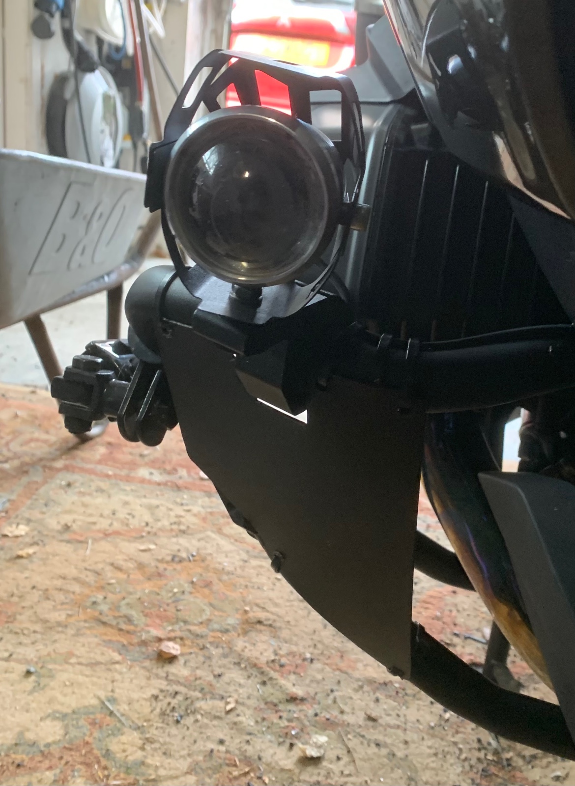

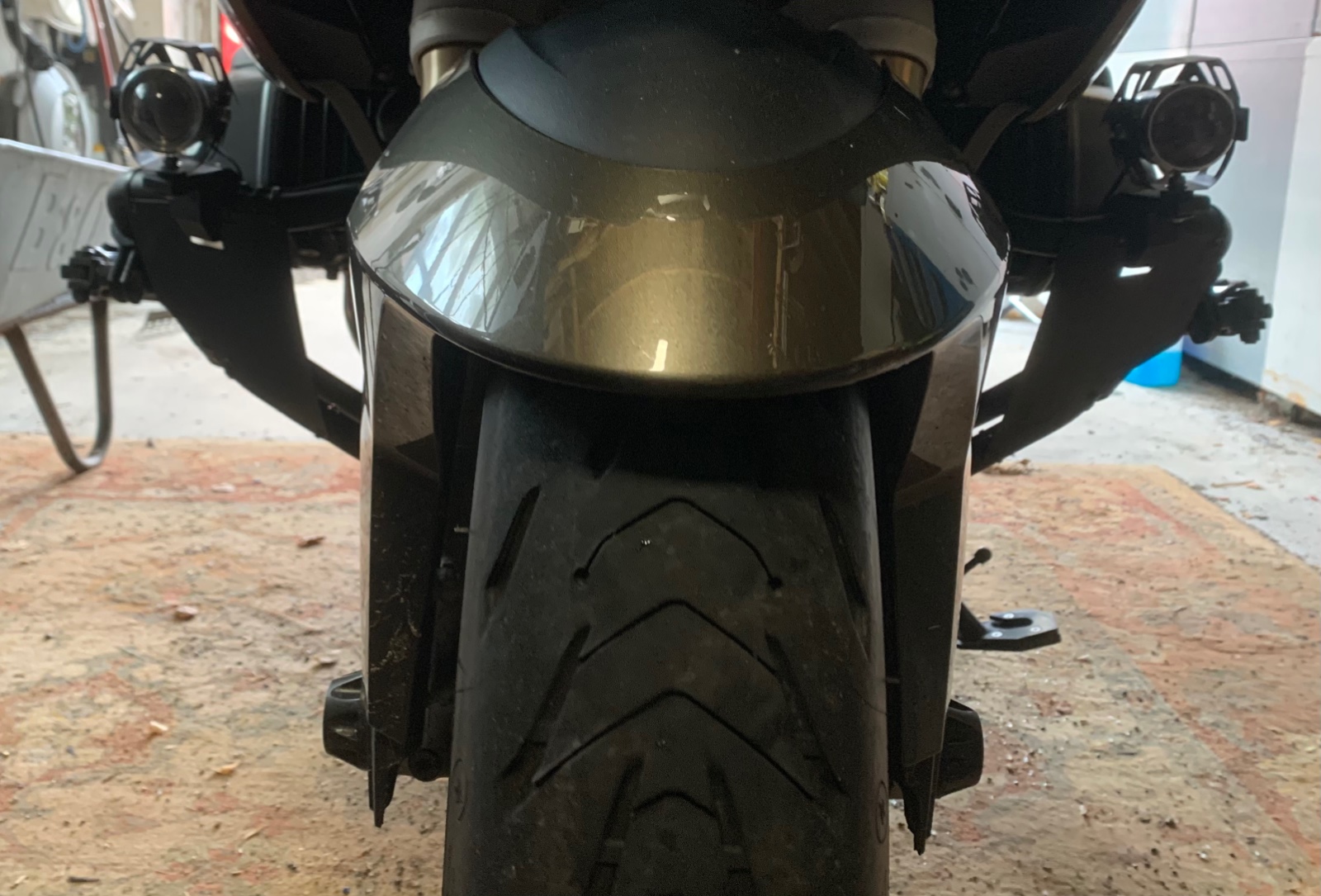

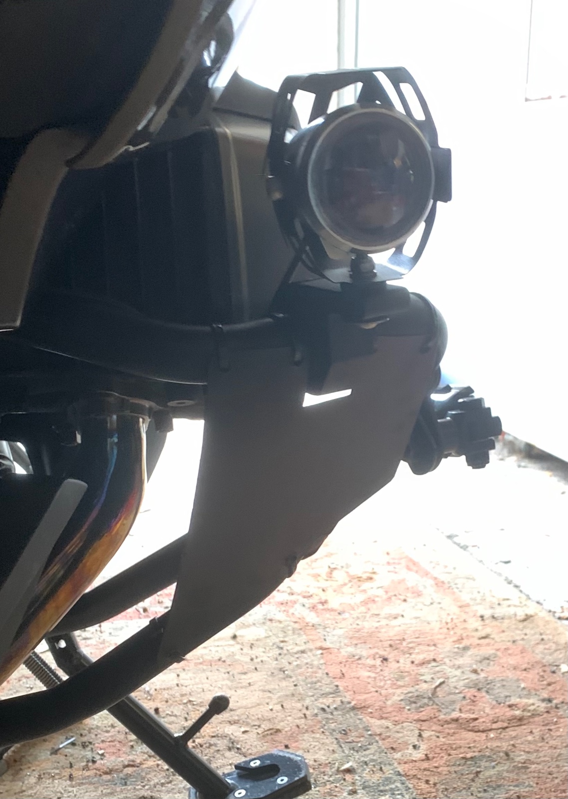

As I can't ride at the moment for snow, ice and mountains of salt on the roads up here I thought I'd see what might help preserve the '21 RT a bit longer for me.
I'm remembering an IAM observer years ago had to replace the pitted rockers covers on his 12 and had to shell out ridiculous amounts of money for real ones (as opposed to the cheap Chinese knock offs that didn't fit anyway) so...
I figured if I put a couple of shaped pieces of polypropylene pinseal finish sheet to deflect stones/grit/crud away from the covers then for little outlay I could score some semi decent protection. I was a bit worried I'd be introducing too much drag but having completed the job they actually slip away to the rear and down from where they fasten at the top rail of the Give head guards so I don't think it's going to be an issue.
Cooling shouldn't be affected as the area in front of the cylinder fins remains clear and there is loads of clearance around the heads in general.

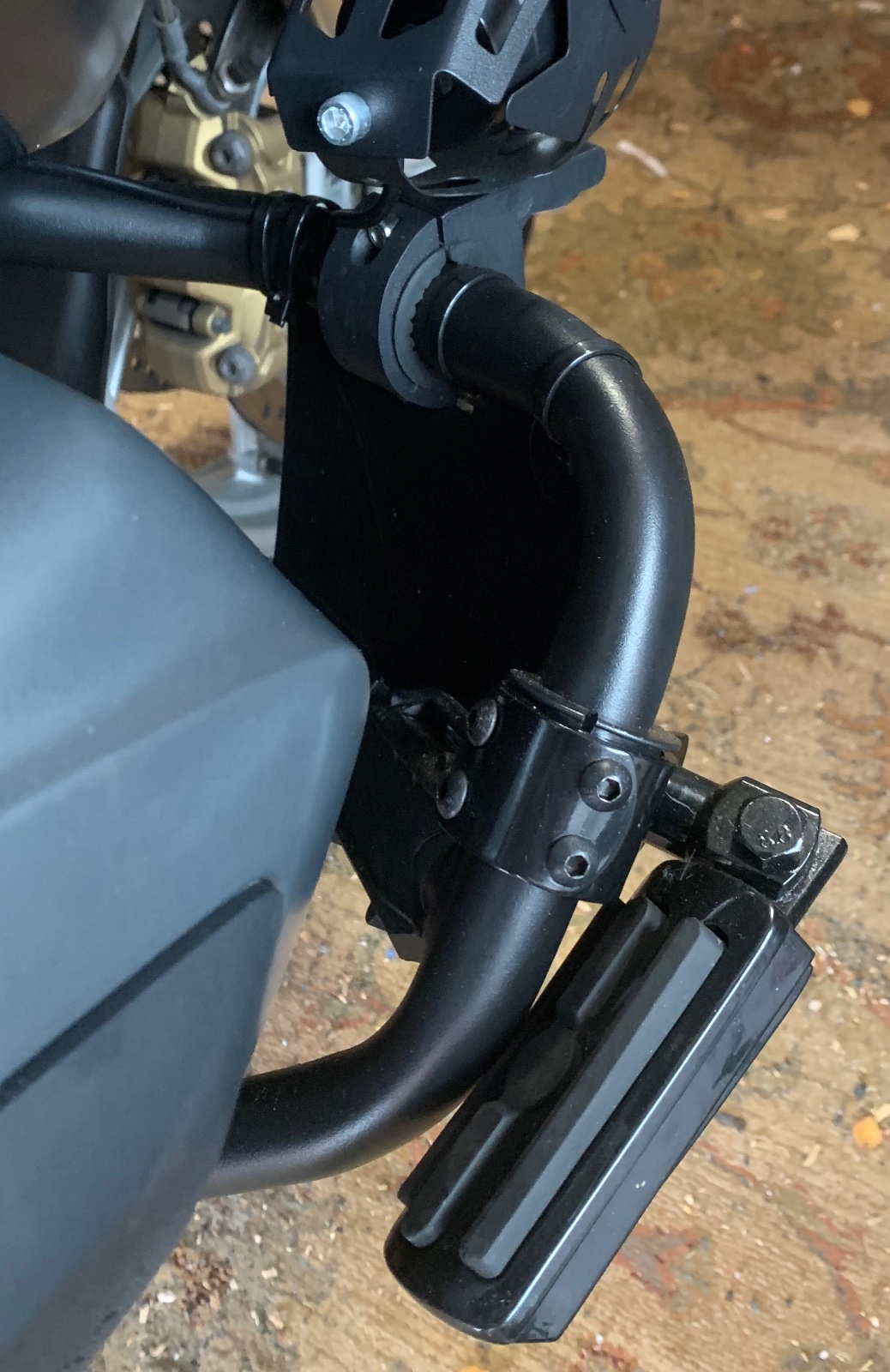

They fasten with six medium tie wraps around the front bars of the givi guards.
I'll have to wait a couple of weeks to see if they make noise etc, etc but I'll post again about how they get on.

After the first ride of '23 the rocker cover protectors worked. They didn't stop all of the road crud but what did get onto the heads was quite slight, non-damaging and was easily removed fully without brushing during a cleaning job with snow foam. Pleased with them - and as I think it would be a mistake to enlarge them to exclude everything the road throws at the bike they're going to remain unmolested for the future.
