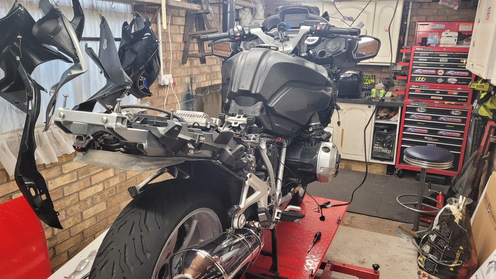

I'm new to this forum and in need of Help! :o Earlier today, I decided to do the brakes maintenance on the RT. I had the speed bleeders, GS911 WiFi, etc. Everything looked easy... until I screwed up and let the brake fluid get below minimum in the front reservoir. Now I have no front brakes :-D .
Any idea how to solve this? I mean, the fluid won't bleed now and when I pull the front brakes... nothing.
