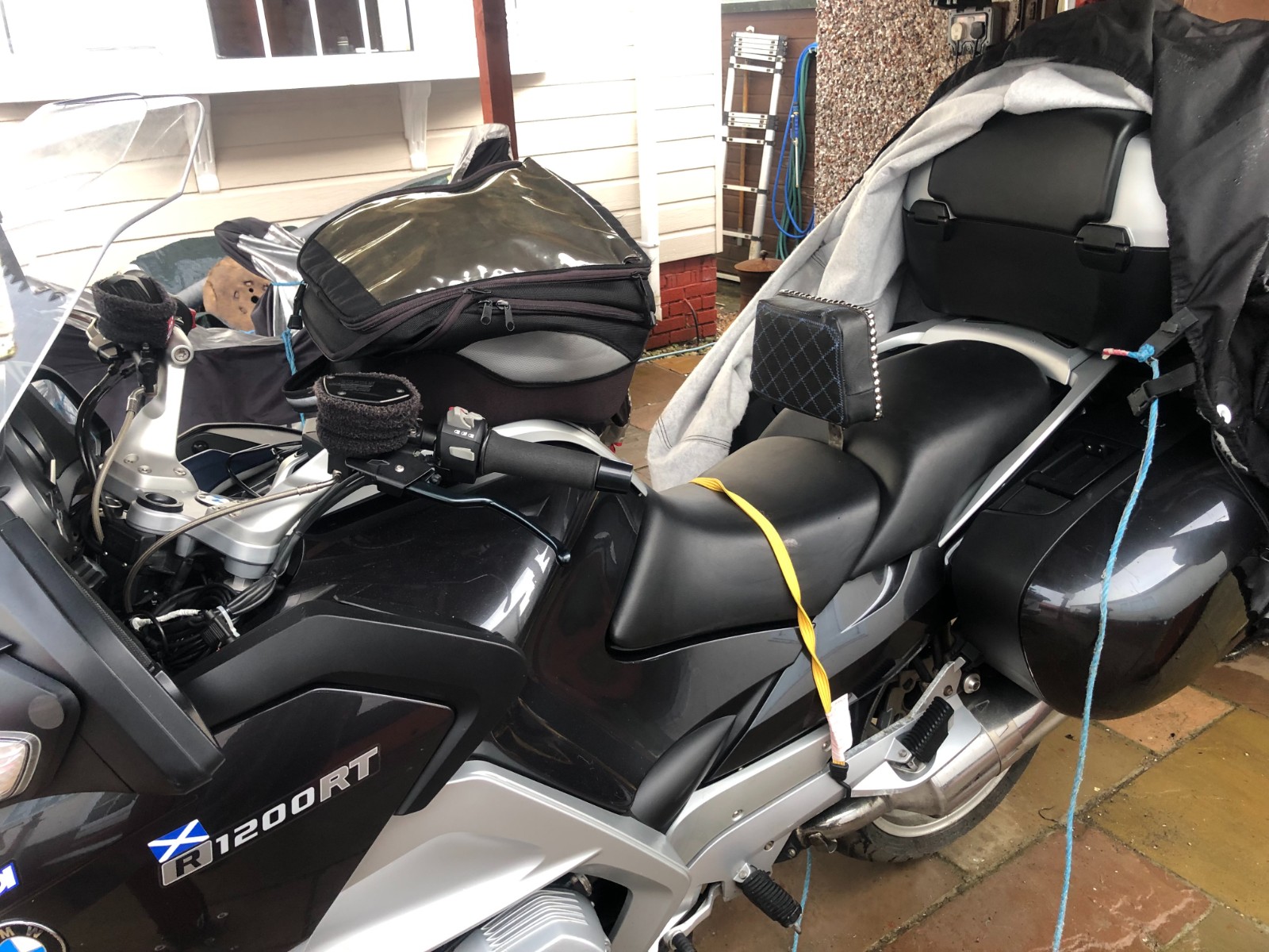

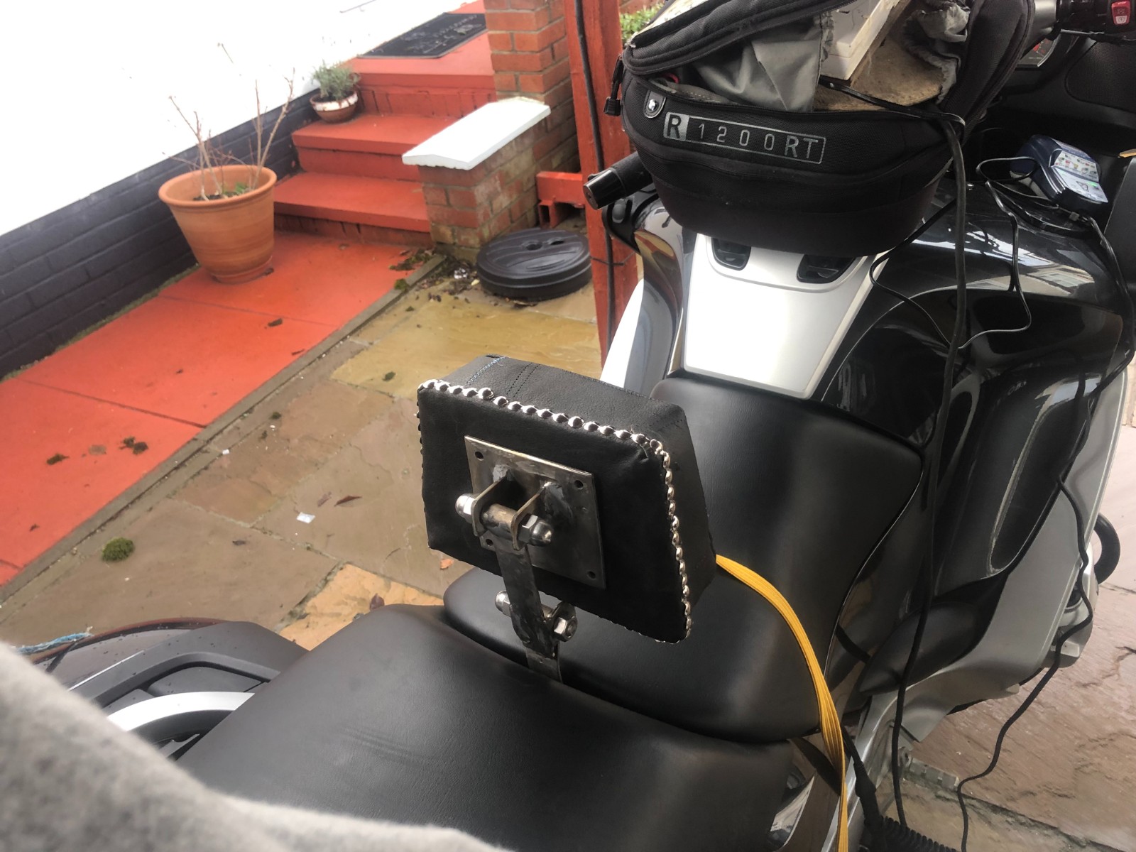

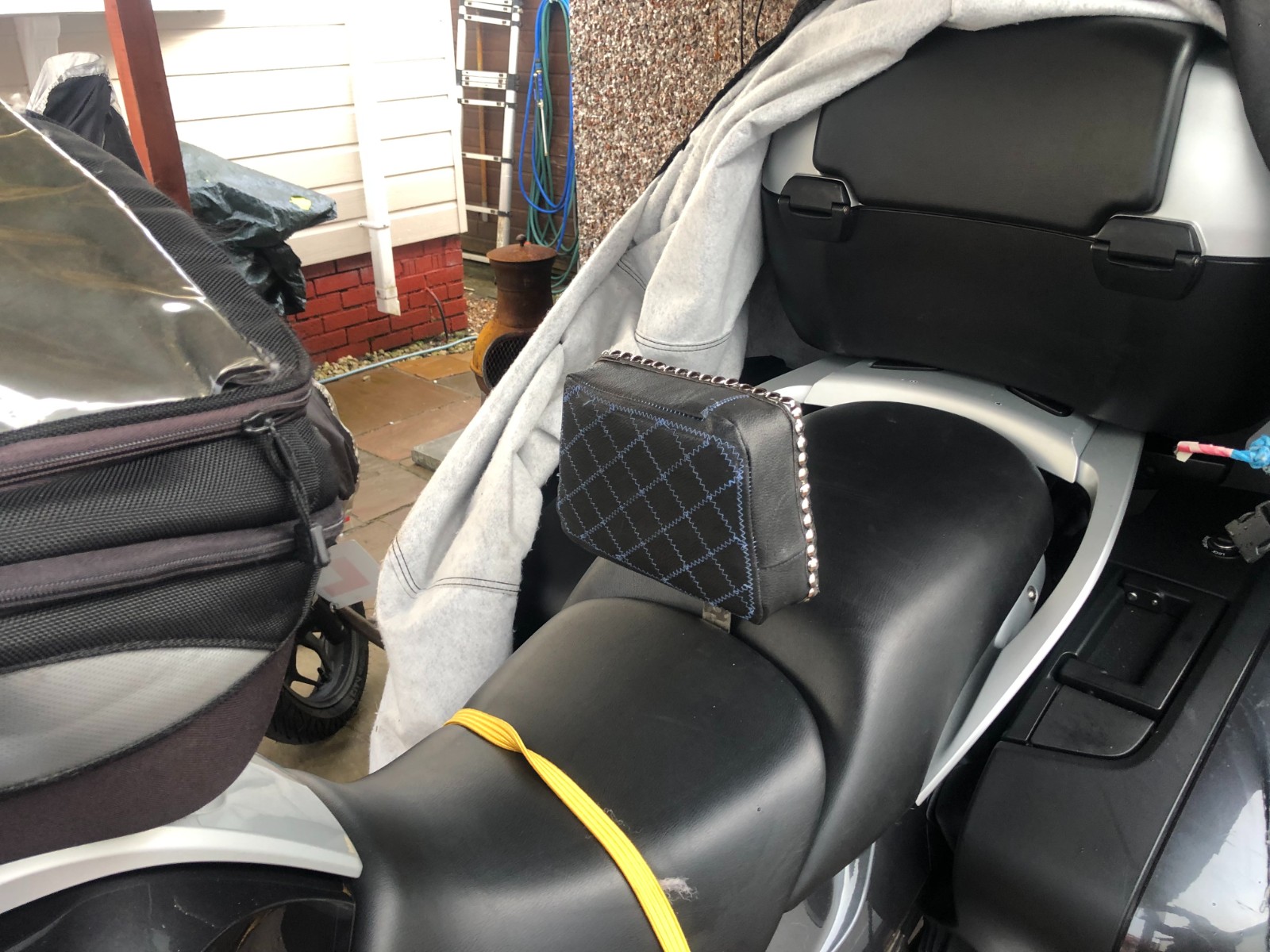

I wanted a rider back rest one for the RT but as usual nothing available in the UK - have to import and very expensive so made one for myself and well pleased with it

Can you show where yo bolted it under the seat? Welcome to the forum

The back rest is bolted onto the front face of the passenger seat. The whole thing comes away with the back seat so as not to cause an obstruction when needing to remove the riders seat to work on battery or such.
Obviously you need to make sure that the passenger seat is located and locked properly before riding as having it come loose unexpectedly whilst resting on the back rest whilst riding can give one quite a surprise.
I used 3mm stainless plate and made a plate for either side of the seat carcass to support the seat and give strength.
