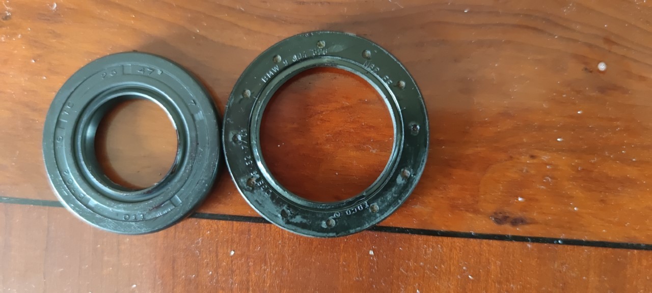

Fitted the bearings today. Used the Rawplug and heat gun method. A 10 minute job but and there is always a but. The seals they sent are the wrong ones. Typical Saturday nowhere open to get the correct one. Have to wait till they send the correct seals.
Theirs on the left, BMW on the right.

Received the correct seal today. Fitted and wheel back on. After i finished i thought i would take the covers off the old bearing. One looked rusty with only a tiny amount of grease and you feel notchy. The other was clean and ran smoothly. This one had plenty of white grease in it. Overall this looked like a newer bearing. In the service history, there is no mention of a new one being fitted.
Then my mind went into overdrive. Am sure bearings come pre-packed with grease these days but at the back of my mind am sure ive greased wheel bearing before fitting. This was a long time ago, i think it was an 80s bike.
