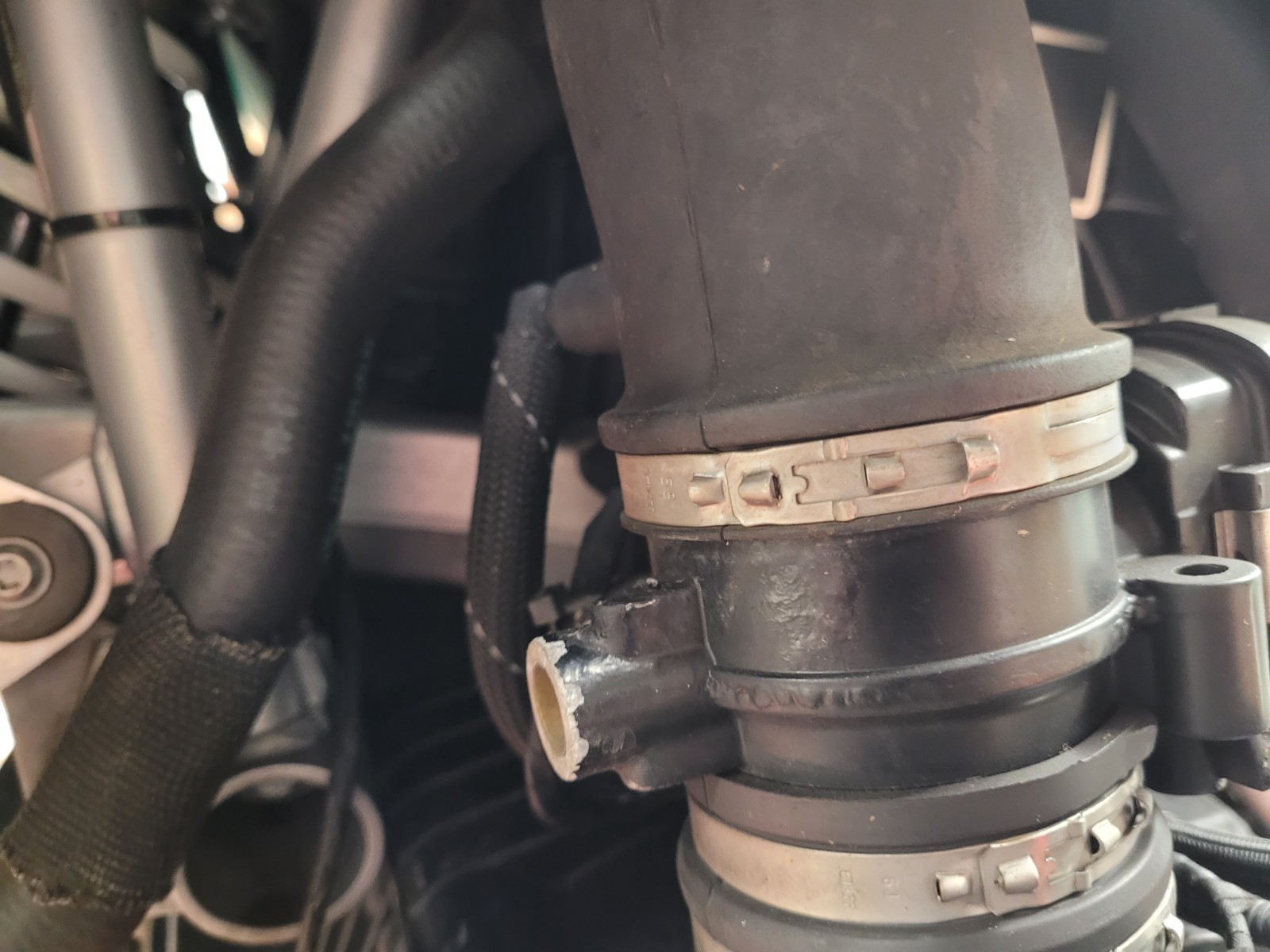

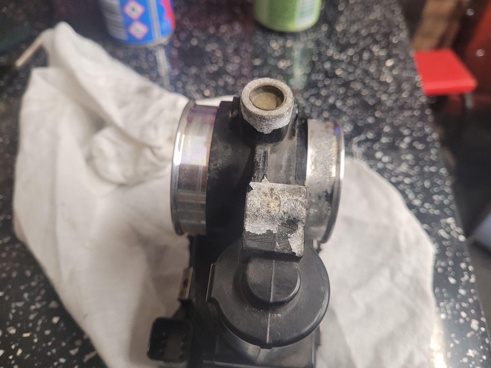

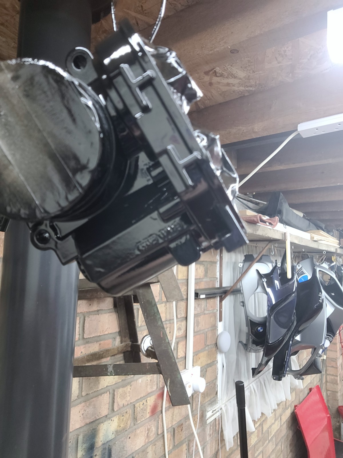

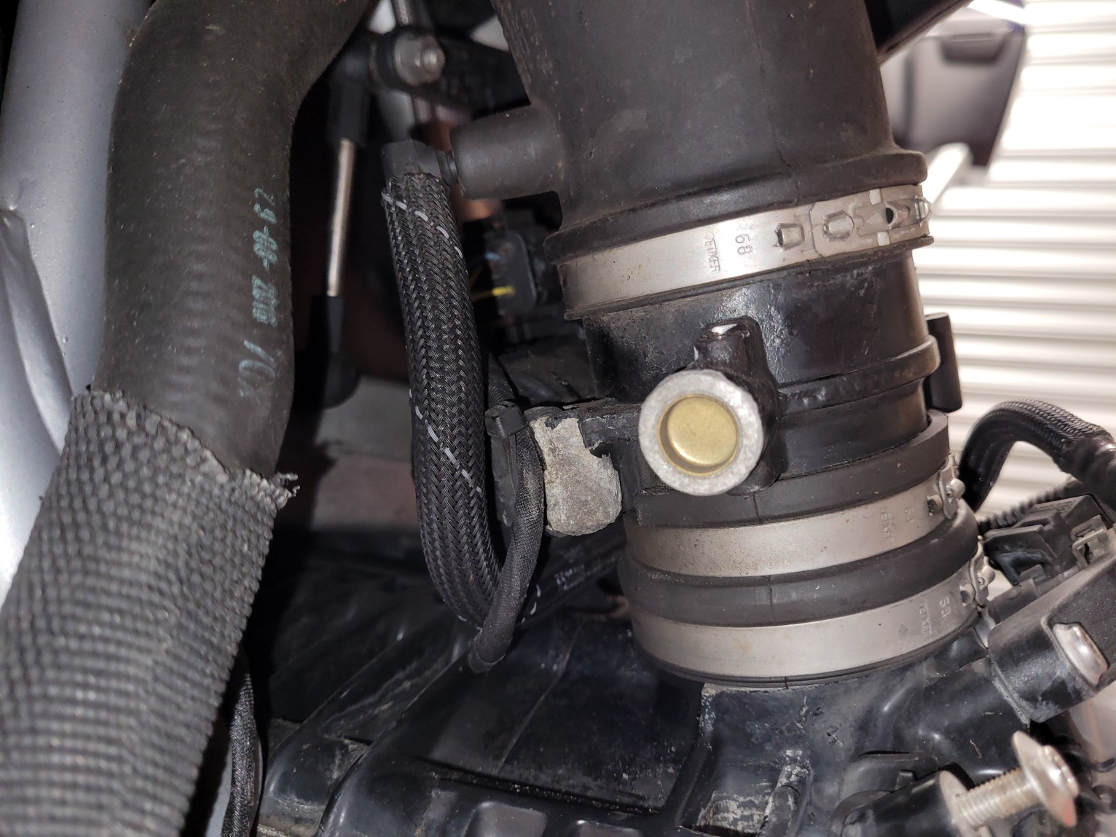

While the bike was on the ramp I noticed that the left throttle body was pretty badly corroded in a couple of places
And to be Honest looking at it I think someone has had a go at it before

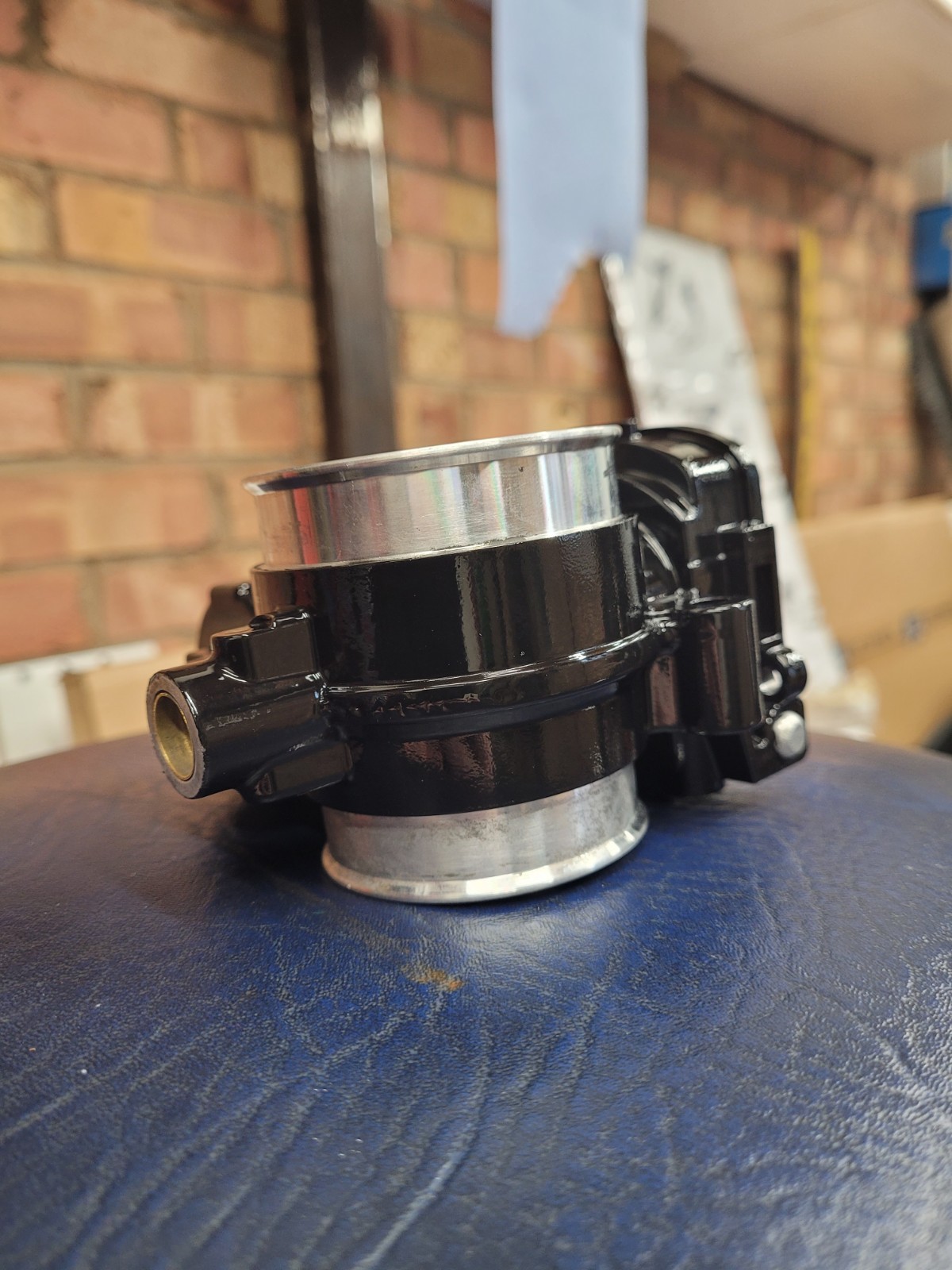

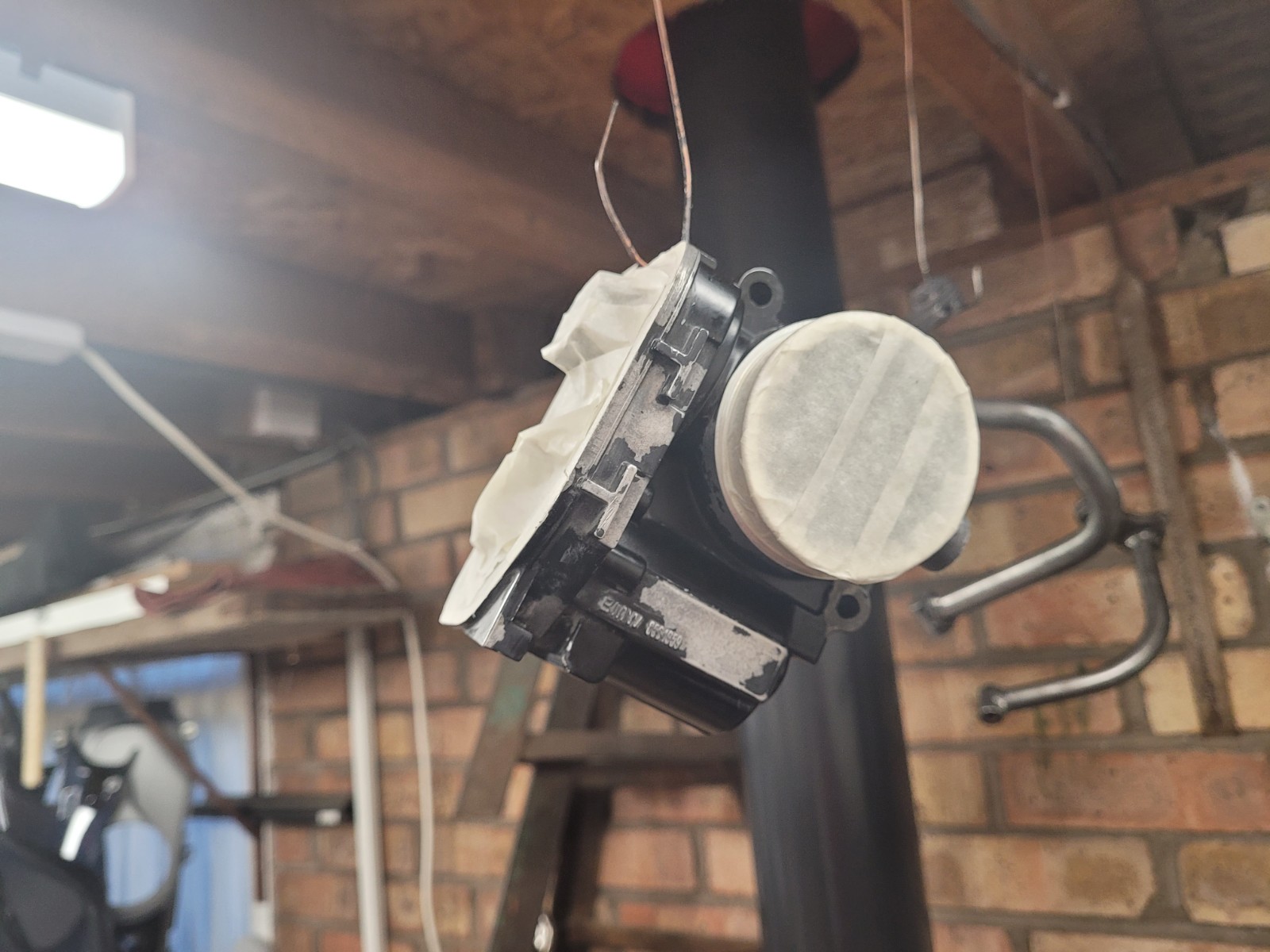

I took the plunge and removed it and removed all the lose flaking paint gave it a sand to rough it up masked it up and gave it 4 coats of black hammarite smooth
And to be honest I am pretty impressed with the result! the paint is a very good match to the original

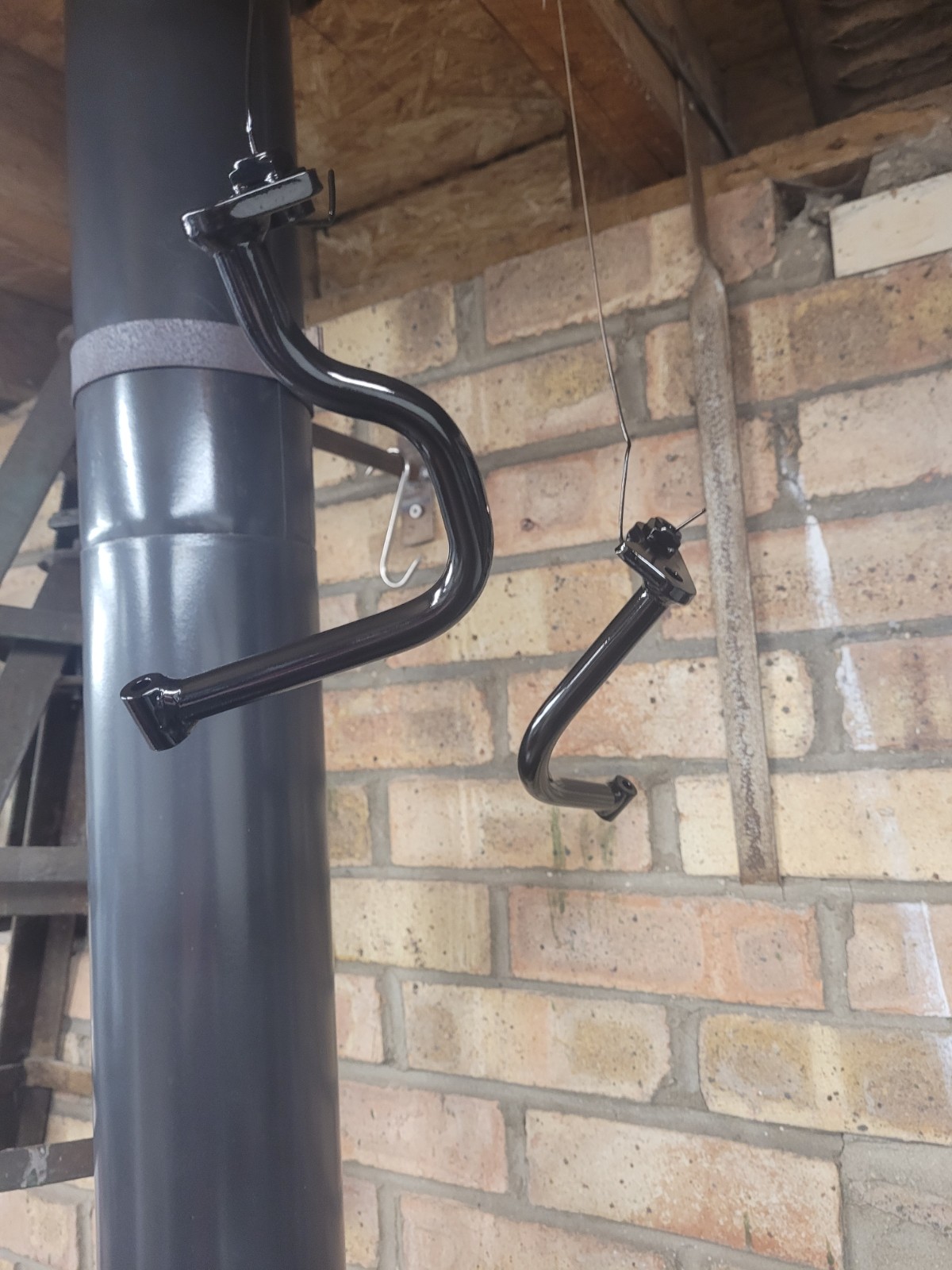

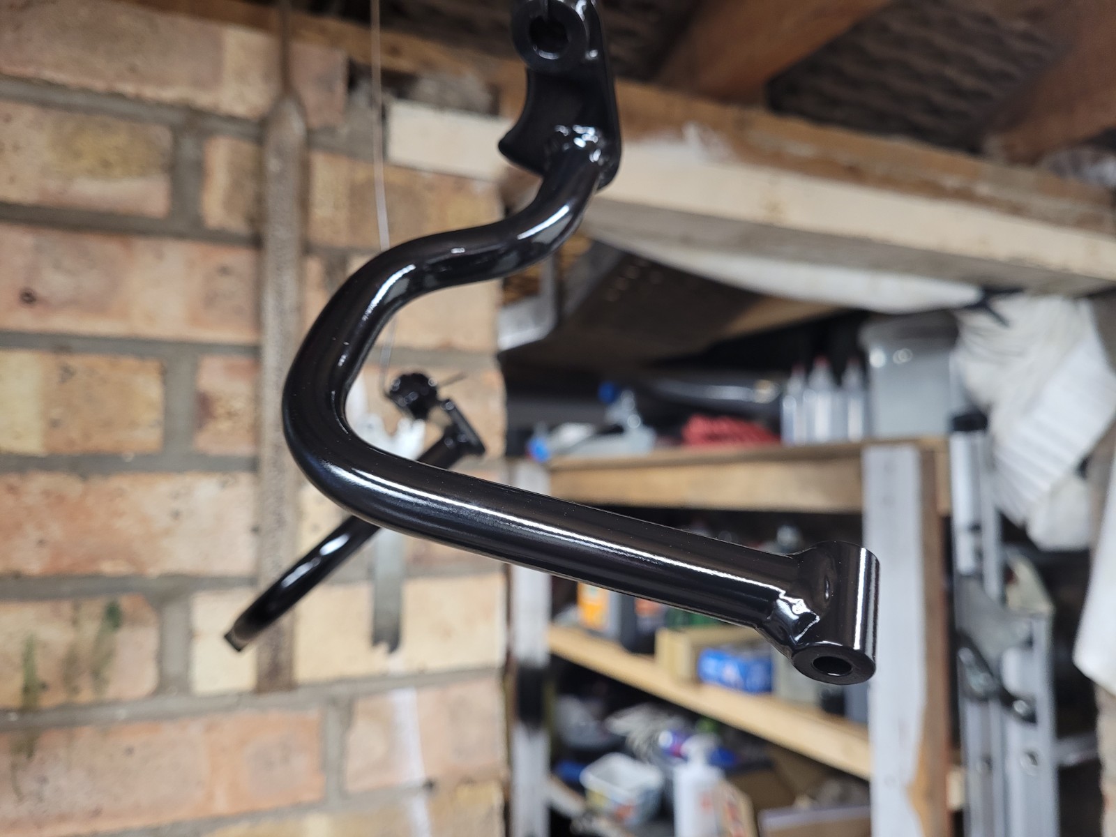

While I was at it I also stripped the spot light brackets as they was showing signs of rust showing through
I was also pleased with the outcome of those too

Looks good :thumb:

simbo wrote: Sun Jan 08, 2023 7:10 pm Looks good :thumb:
Cheers
Not that its going to matter as you can't see them with the fairing on but I know its done :lol:

sakm wrote: Sun Jan 08, 2023 5:58 pm While the bike was on the ramp I noticed that the left throttle body was pretty badly corroded in a couple of places
Nice job looks professional!, my 2019 has the scab on the right TB , I was going to try and remove my centre stand for powder coating but I might spray it now.
