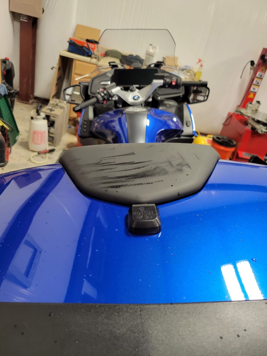

The quickest fix is to add an external XM antenna. I mounted mine on top of the topcase and routed the wire along the same path as the power wire for the topcase. It is between the two shells that make up the case. 100% fix for dropped signal. Total cost was under 30 bucks. Sometimes it's easier to just apply the fix rather than to try and beat BMW into submission...

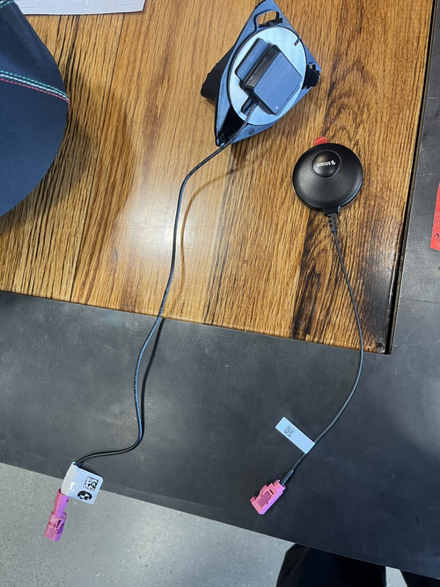

My bike was at the dealer for 17 days (600 miles service and XM/AM antenna issues). The dealer just sent me this photo of the "FIX" (photo below) for the XM that BMW has them installing. It looks like a Sirrus branded XM antenna, on the right. They're rerouting the wire because it's shorter than the stock one, but fits perfectly into the mushroom.
Nothing was happening after complaining and talking/emailing BMW-USA countless times, until I sent my videos of the problems to BMW-HQ in Berlin, the next day BMW-USA agreed to take care of it.

Motor32 wrote: Mon Dec 18, 2023 5:51 pm My bike was at the dealer for 17 days (600 miles service and XM/AM antenna issues). The dealer just sent me this photo of the "FIX" (photo below) for the XM that BMW has them installing. It looks like a Sirrus branded XM antenna, on the right. They're rerouting the wire because it's shorter than the stock one, but fits perfectly into the mushroom.
Steve
[url]
Sorry to bring this old thread back to life ... as I am struggling to replace the OEM antenna.
Based on the picture above, looks like the wire of the OEM antenna is quite short and I am assuming it ends with a socket in the front of the bike?
If there are other pictures to install a 2rd party antenna, please provide.
Thanks.

I don't have any other pictures, (the dealer sent me the picture). They told me they had to reroute the wire to use it. Maybe they have corrected the issue by now. The dealer covered everything under warranty, and works great w/no loss of signal since, FYI.

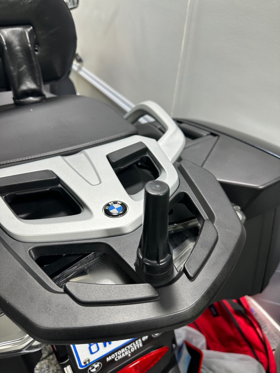

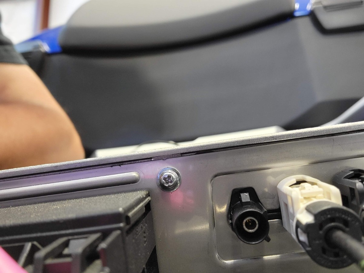

I can't seem to see how to get off the bodywork to get to the "mushroom antenna" so I can do this myself. I tried looking around for the FAKRA pink plug that is illustrated in the picture. It can't be very far into the bodywork since it's short. I don't want to break any tabs getting everything off; and since I can't have a BMW shop manual (2023 RT) I don't want to go "exploring" by taking stuff off the bike to get to the mushroom and the wiring.
So I bought a 4" tall Sirius XM antenna and installed in on the furthest back point of the rack, and then plugged it into the XM radio; FAKRA connection (pink).
Problem fixed so far, but I haven't ridden the bike to test the reception quality while riding since the weather has been bad since I completed it.
I will re-post once the verdict is in.
