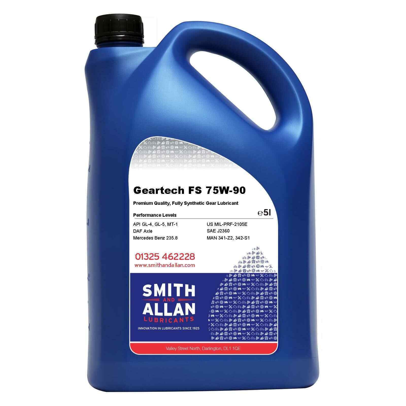

I use 75-90w in both. 99% of car gearbox oil will do. I use Smith and Allen Fully Synthetic oil.
s-l1600 (2).jpg (144.5 KiB) Viewed 5769 times
