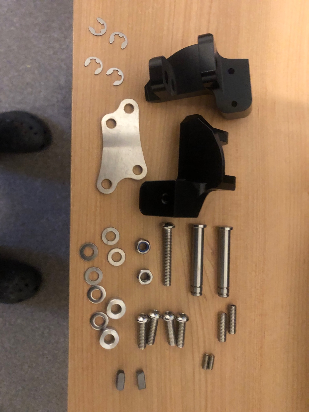

After reading a few comments on here about these and members sharing their experience on getting these from china I took the chance and ordered a set from Ali express. Cost me £37. All in. Arrived yesterday, a week earlier than delivery date. Royal Mail delivered.
Looks well made and nicely finished, goodly supply or pins and bolts and spacers and bushes, but no instructions. So if anyone can provide fitting instructions would be appreciated. Especially Info about the single plate.

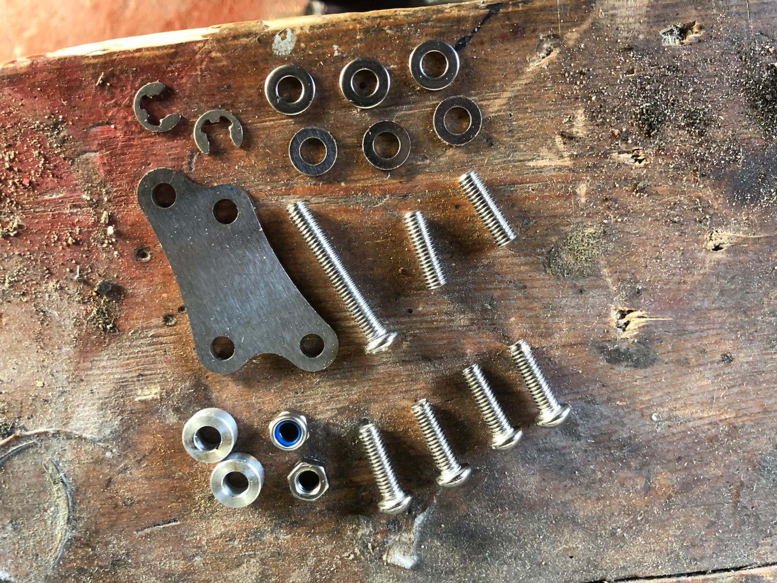

And sorry did not find out what the long bolt is for. Pic below is of all the stuff I didn’t use.
All the bits that were left over

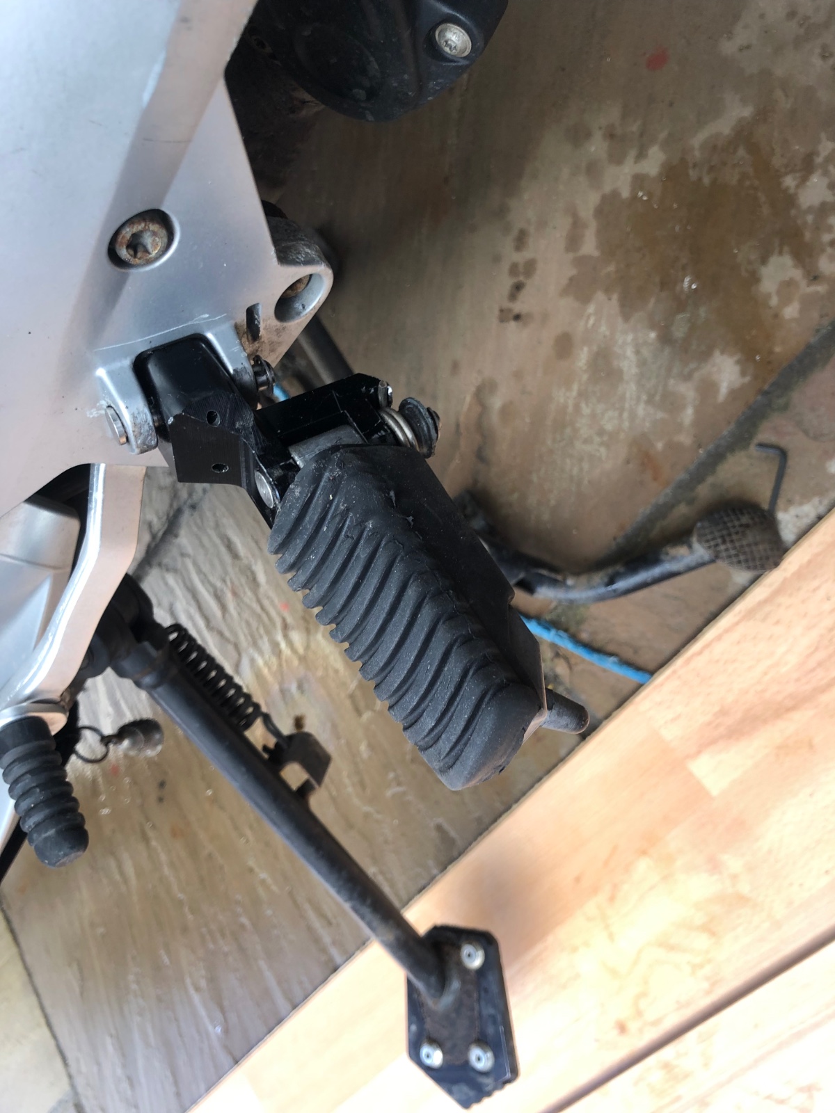

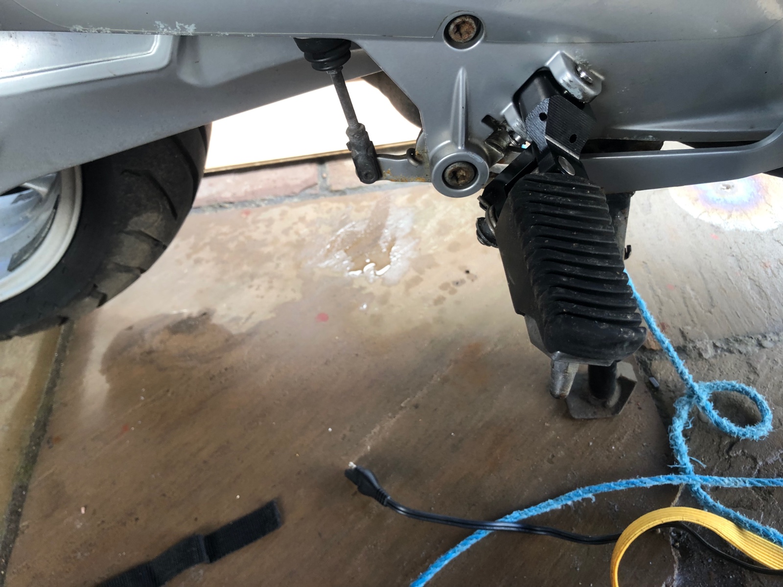

Here they are fitted to the bike
