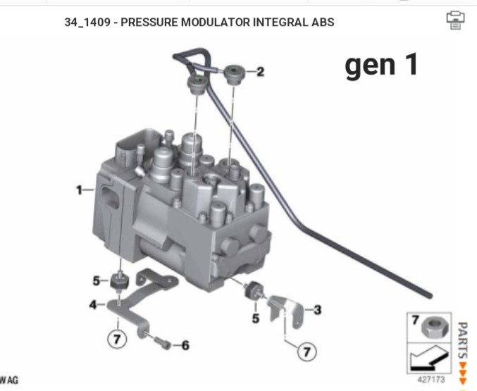

Re: R1200RT K26 Special - diagnostic and abs problem
My 2007 has a non working ABS system. I can still communicate with the diagnostics with a motoscan and GS-911. About a month ago i had a new fuel strip fitted at BMW. At the same time, i asked them to scan for any faults and the only problem was the ABS.
So to your question, the ABS doesn't stop connection to the diagnostics,
deltamike
Posts: 4
Joined: Mon Feb 13, 2023 5:51 pm
Bike Model and Year: R1200RT K26 - 2009 - Special vehicle
Croatia
Post by deltamike »
Doctor T wrote: Tue Feb 14, 2023 3:21 pm My 2007 has a non working ABS system. I can still communicate with the diagnostics with a motoscan and GS-911. About a month ago i had a new fuel strip fitted at BMW. At the same time, i asked them to scan for any faults and the only problem was the ABS.
Oh... You have ABS generation 1 or 2?
I have generation 2.
Posts: 2293
Has liked: 1433 times
IRC Gen 2
