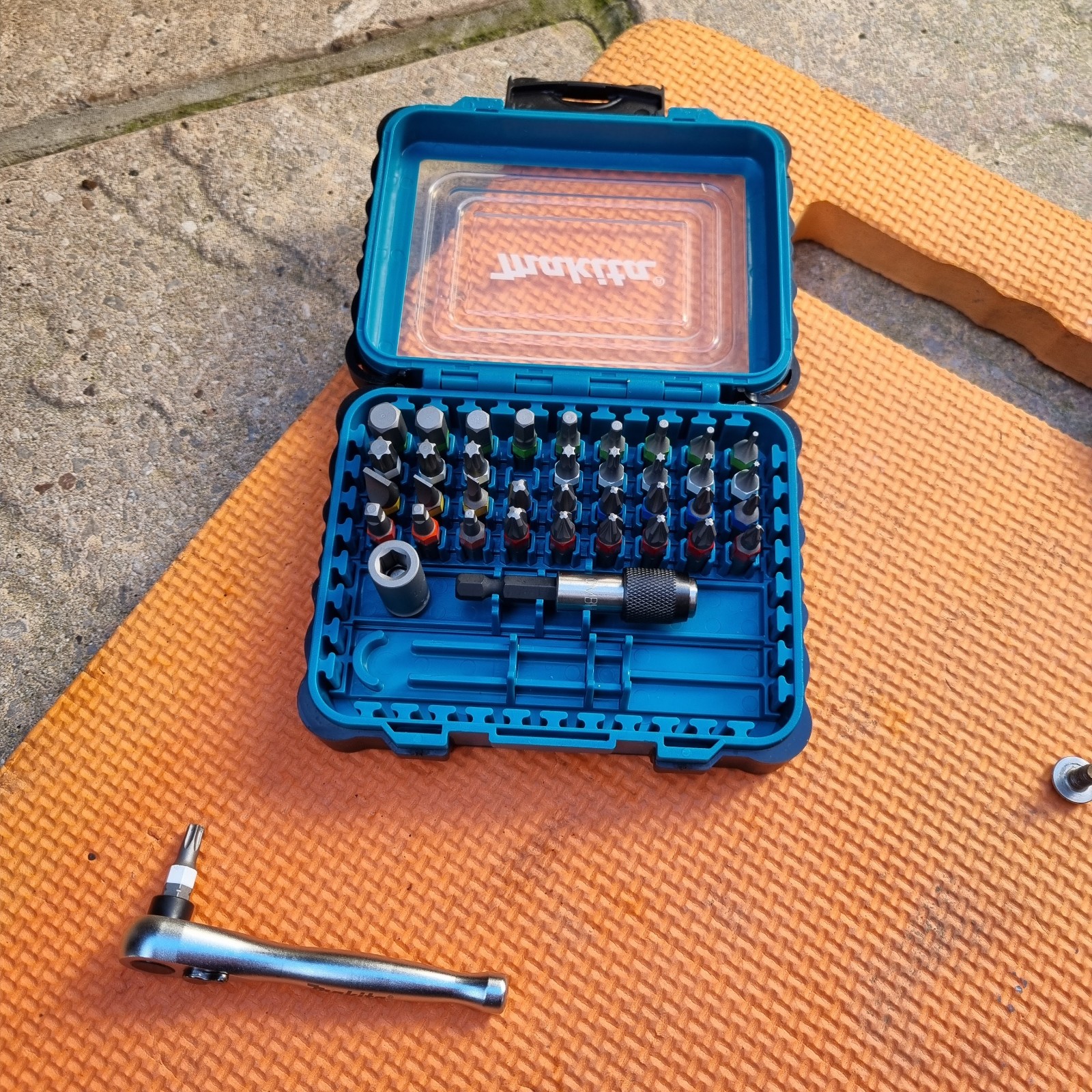

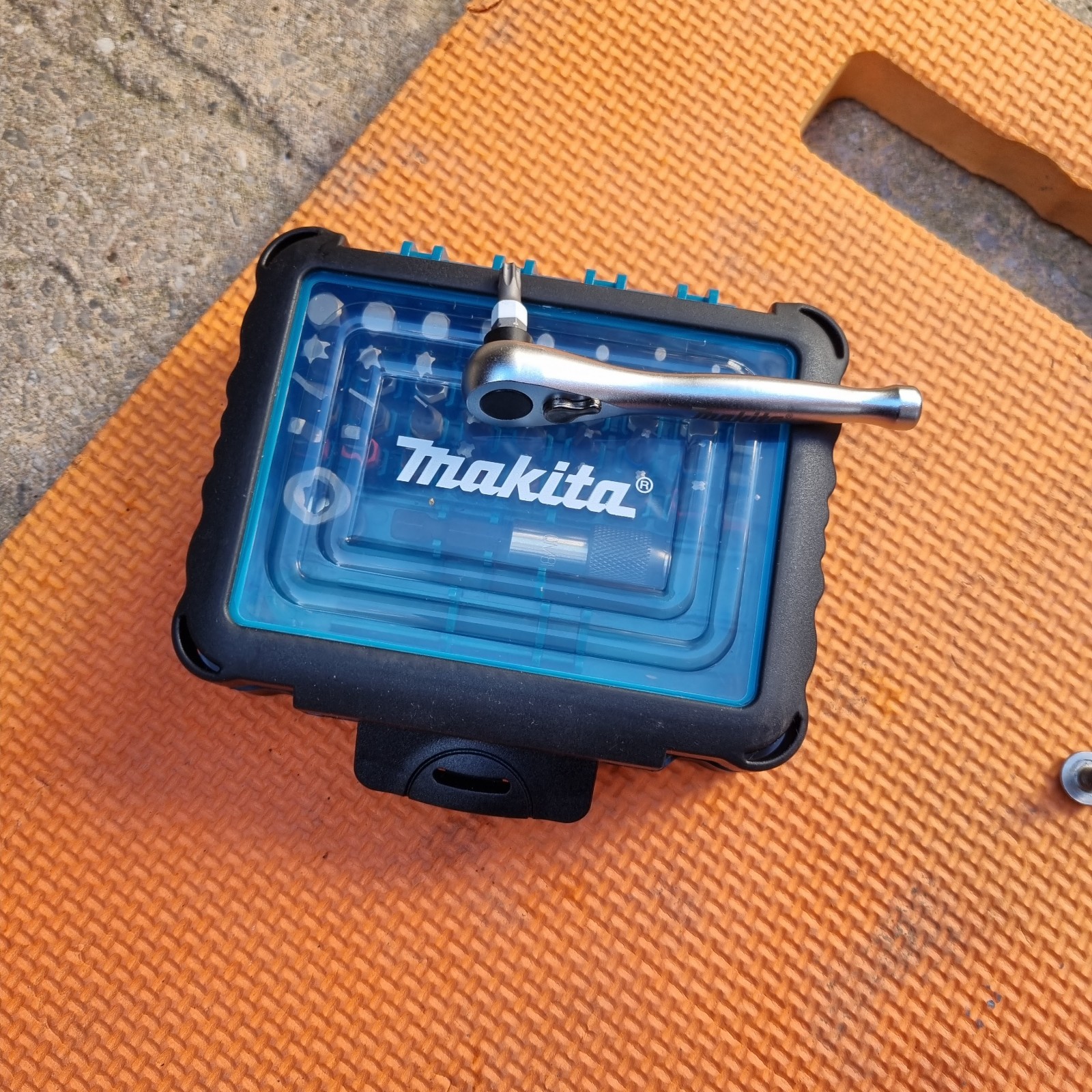

My exhaust flapper valve seized and a warning light has appeared on my dash. Headers were replaced under warranty last time it happened, but now its out of warranty BMW dont want to know unless I have £1600 to give them. Had a problem getting some of the screws out due to the restricted space and found this on Amazon
for £17. Money well spent and flapper valve now working, until the next time. Anyone have any idea if the flapper can be removed? How easy is it to do? And will it effect any future MOT due to its emmissions? Many thanks

Thanks for the advice folks really appriciate it. Here's the link for the mini wrench set
