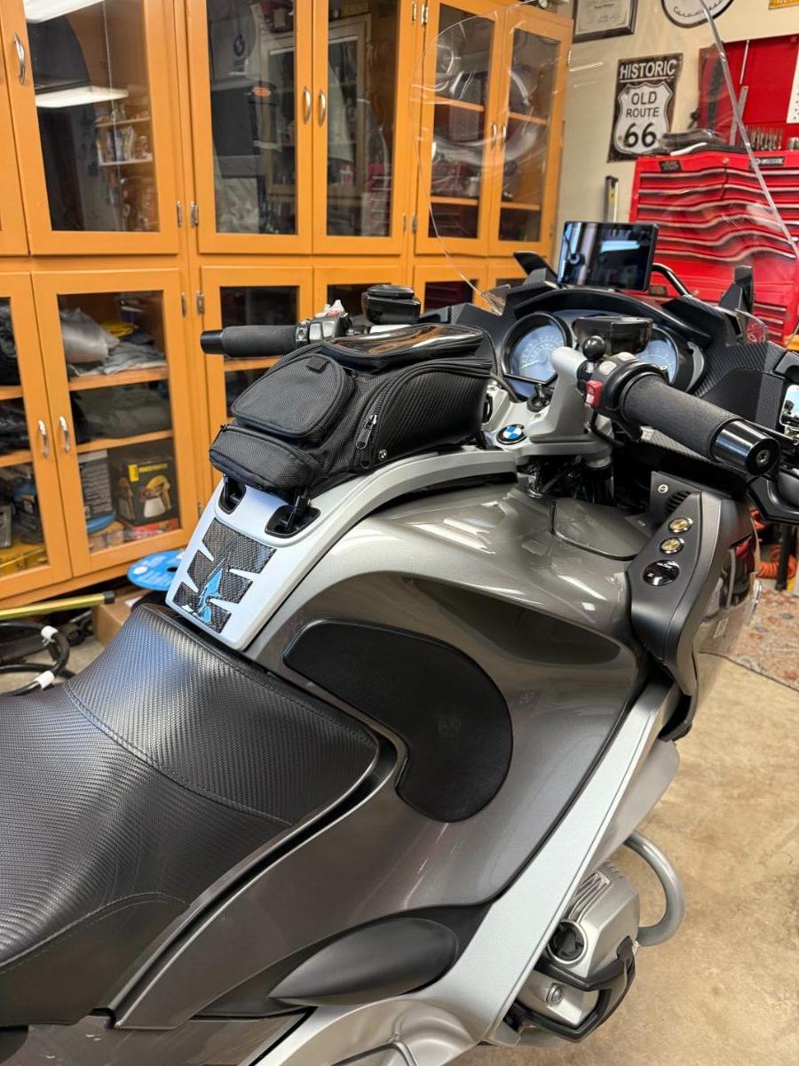

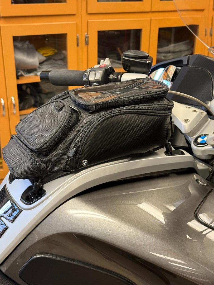

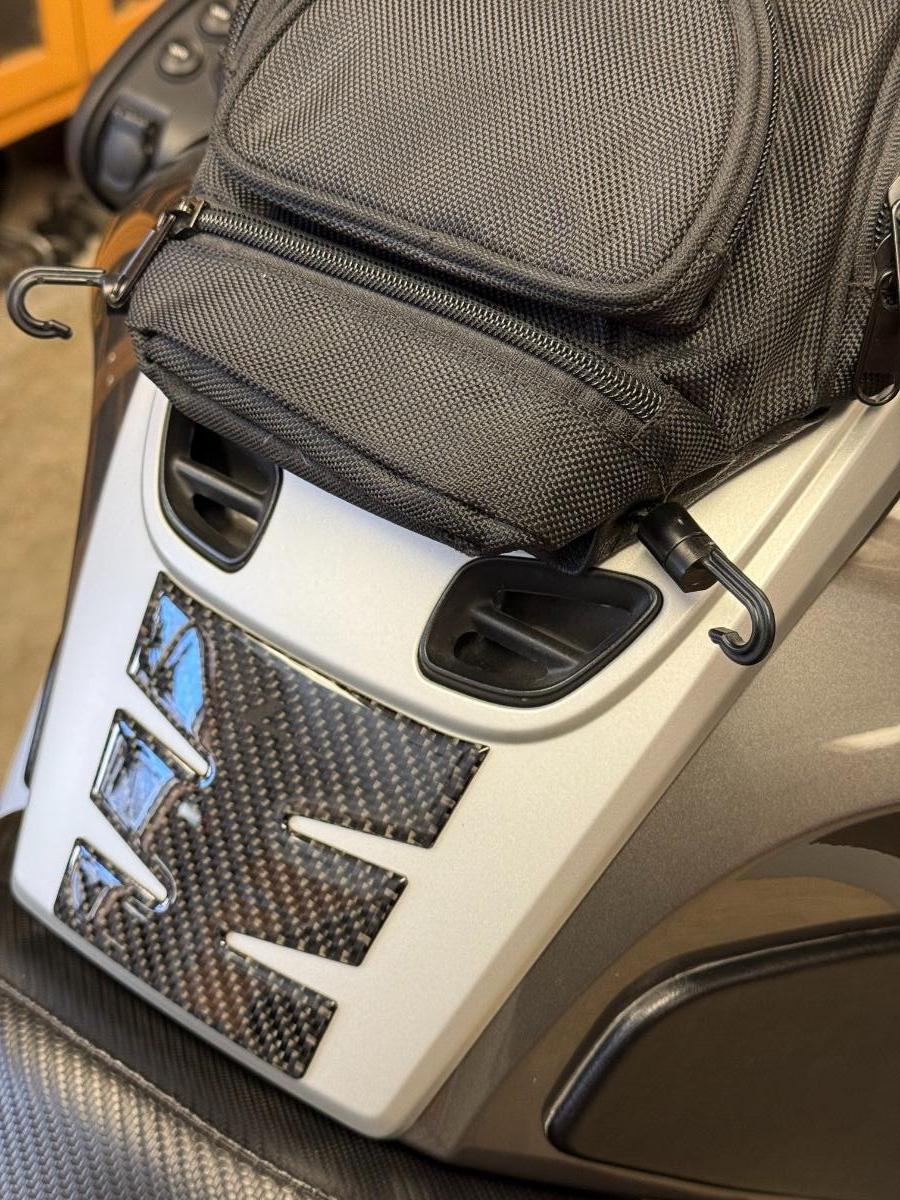

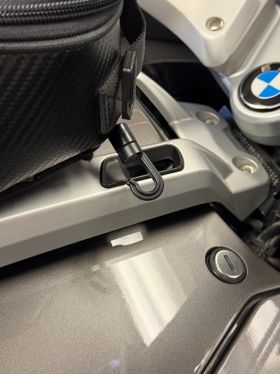

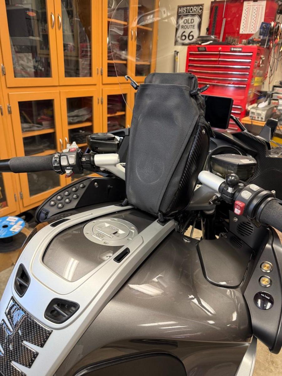

Post by bruce2000ltc »
I went a different route. I bought a small magnetic tank bag on Amazon and cut the wings with magnets off. I installed custom bungee cords I made up(also from Amazon) to the front and rear of the tank bag. The hooks on the bungee cords hook into the slots on the tank and hold the tank bag securely. It's easy to remove the rear bungee hooks to flip the tank bag forward at gas stops. I'm sure this method could be incorporated on most tank bags.
