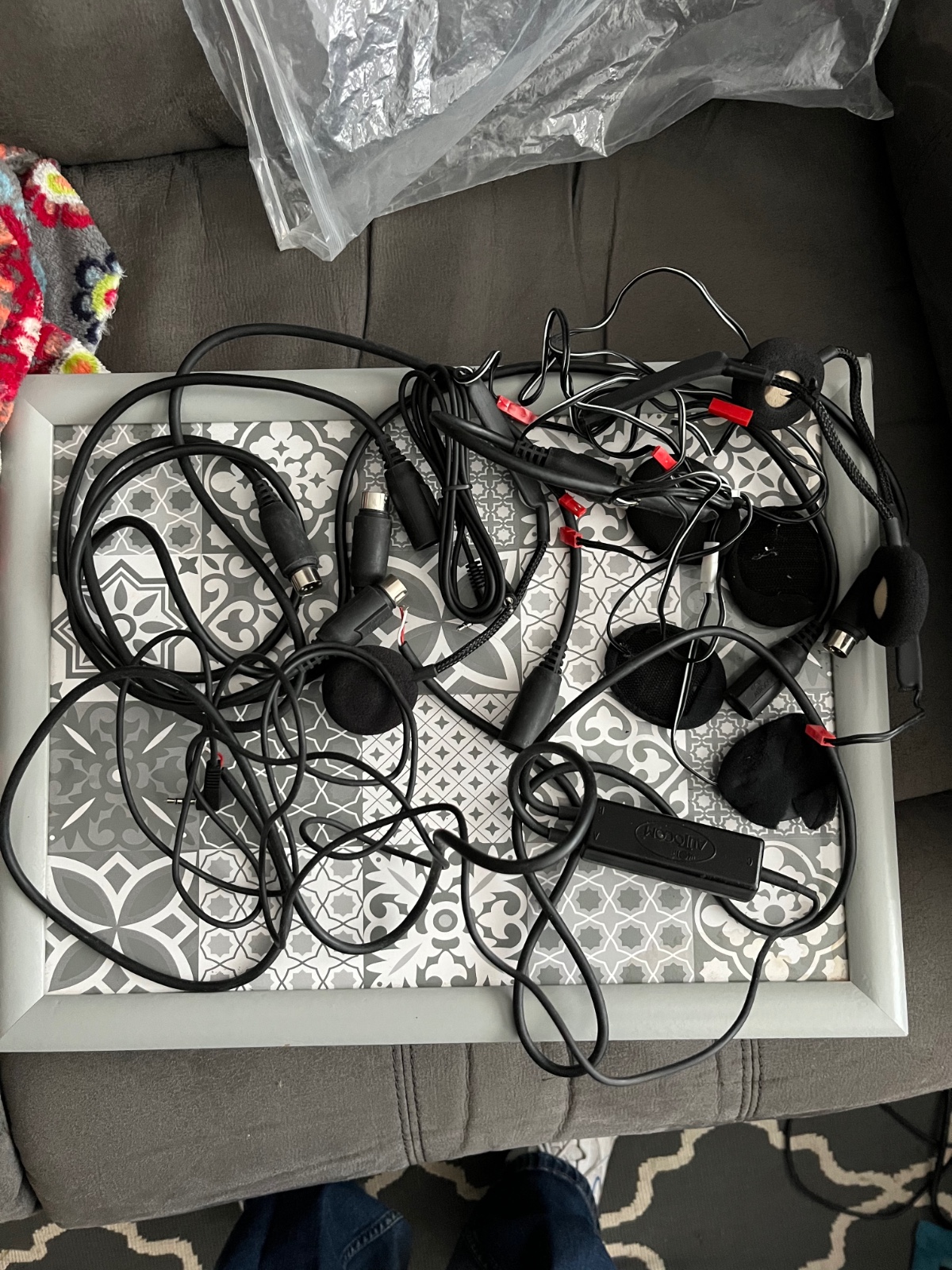

I’ve just picked up my first BMW (2005 R1200RT) and there is a bag of cables with it. Two helmet sets by the look of it and about 4 din leads. Also a lead with a small plastic box with wires coming out. I have no idea if it fits to the bike or not? Any help would be greatly appreciated. Oh and I absolutely love the bike after 24 hours!!!

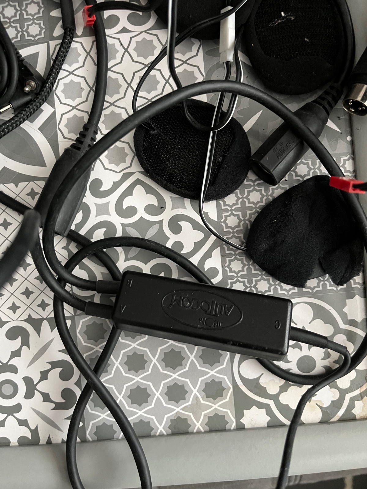

Hopefully you can make since of these pics. Where would these plug into etc? Please bear in mind you are talking to someone who has never used an intercom on a bike. Cheers.

There is no doubt that it is Autocom stuff. From the spaghetti, it looks like you have got a couple of helmet headsets with mics & speakers and some extension leads. I don't recognise the black box with A, B & C on it. This box could well be what is called an isolation adaptor.
Found this isolation lead, looks the same but with only one input.
Having said that, without a control main hub unit it's probably all useless.
Have you looked for a unit anywhere on the bike, mine is under the pillion seat.

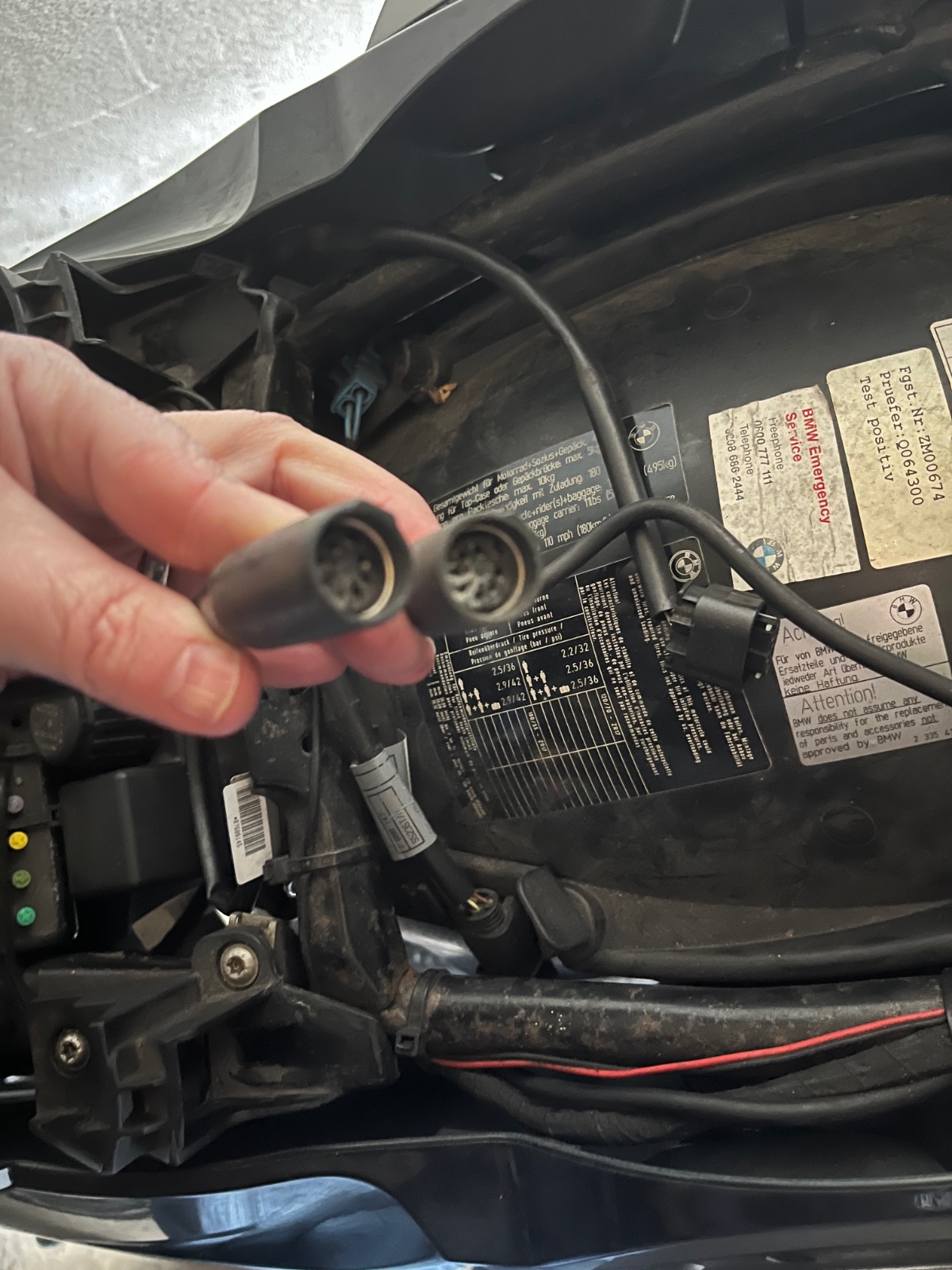

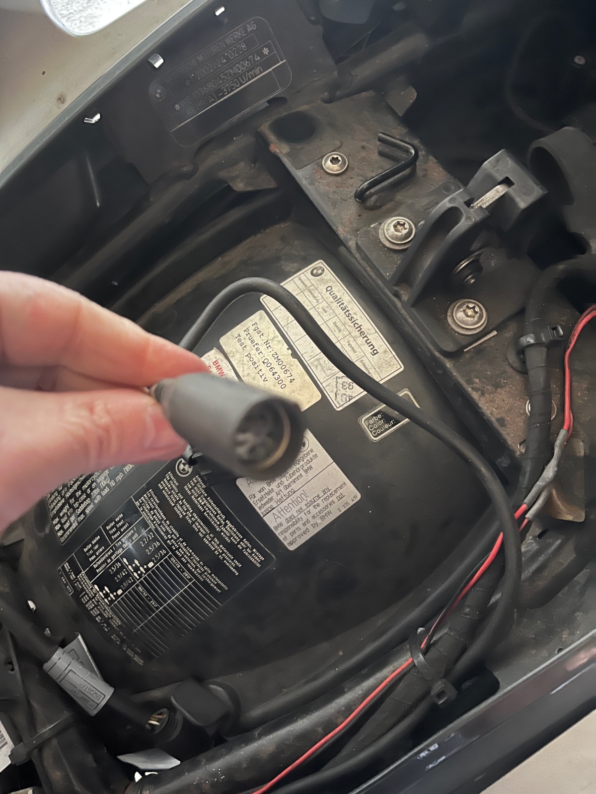

Hi @David. heres a couple of pics. I do have the unit under the saddle. So is it just a case of connecting the headsets vis the extensions to the leads under the saddle? If so, what is the best route out from under the saddle? Hope this makes sense? Cheers.
Re: I think I have an autocom?
Windy wrote: Mon Mar 06, 2023 4:01 pmI do have the unit under the saddle. So is it just a case of connecting the headsets via the extensions to the leads under the saddle. If so, what is the best route out from under the saddle.
Which Autocom control main hub is it. The two 7 pin DIN sockets will be the rider & pillion connections. I used to use my system for rider to pillion helmet comms. and sat. nav. Now only use it solo for sat. nav. voice prompts, therefore don't have the headset mic. connected. For the rider, the lead comes out between the seat and tank. For the pillion, I had the lead coming out between the two seats.
