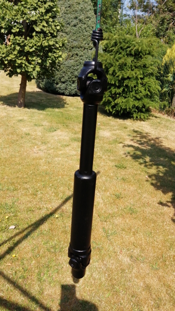

Some maintenance this morning :shock: , decided to grease the front splines this time and replace the rubber boot. Sprayed up the shaft whilst at it :lol:

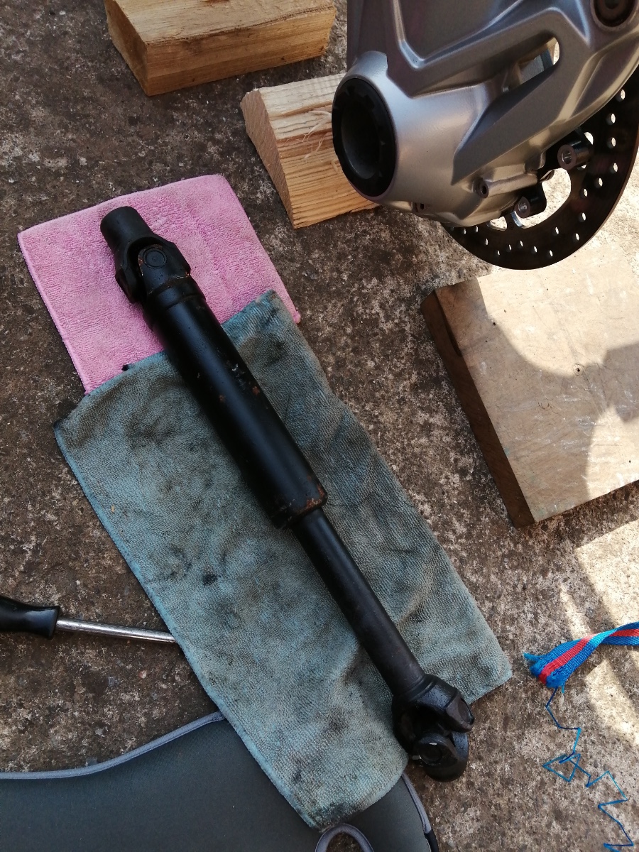

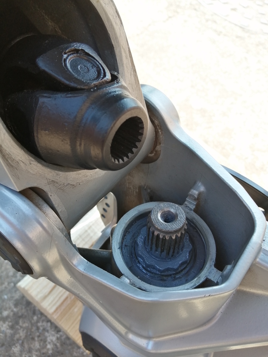

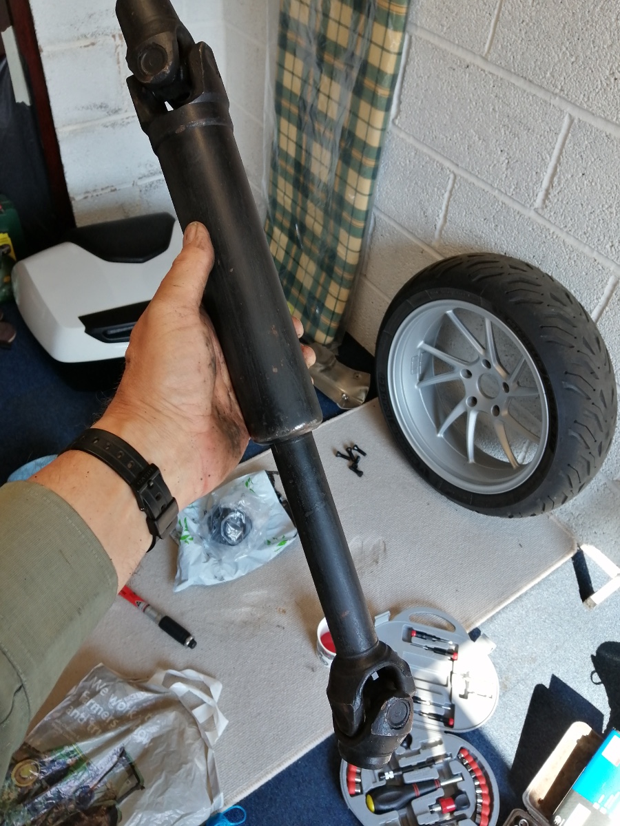

Stripped the rear on mine today!
The shaft still looked good and the UJ felt fine too
Small amount of water in the swingarm though :?
I think the rubber boot has had its day so I will replace that in good time
