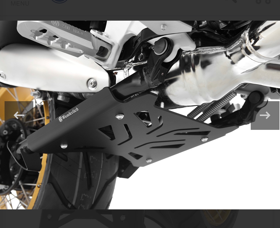

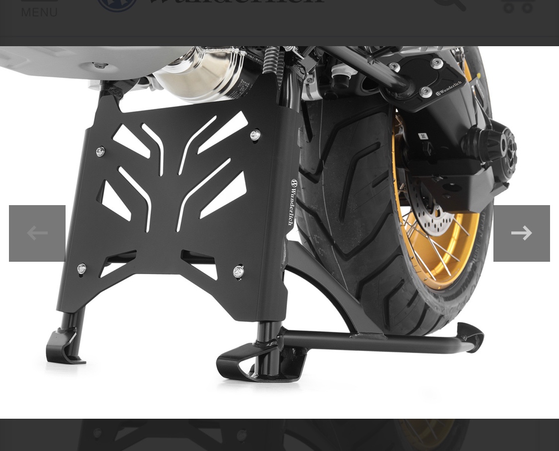

If you had a GS you could buy one of these from Wunderlich

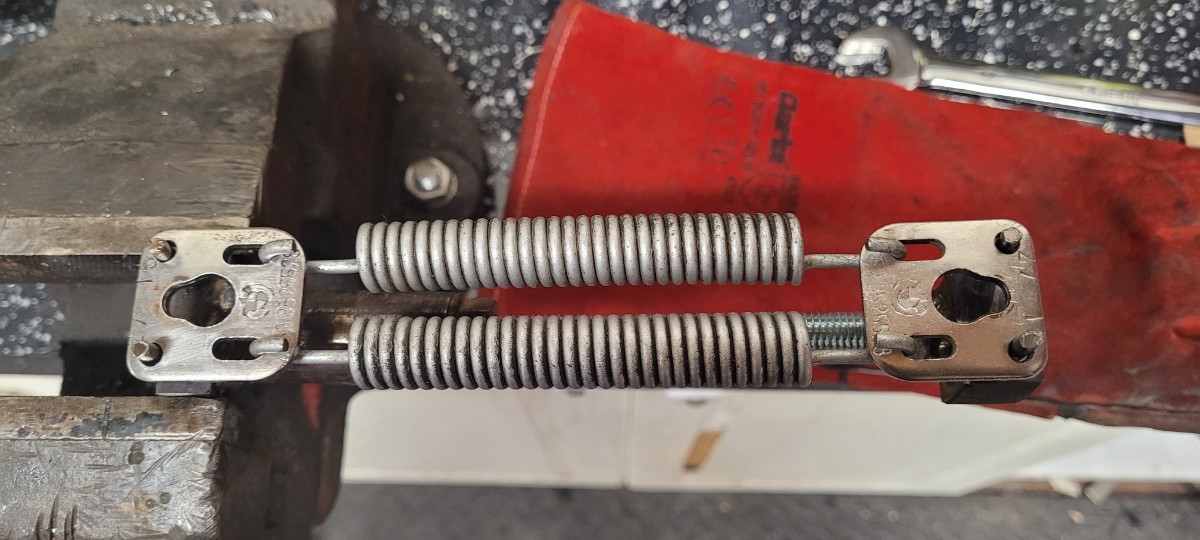

How did you get on refitting the springs.
Re: centre stand painting
David. wrote: Mon Mar 20, 2023 7:35 pm How did you get on refitting the springs.
extremely easy with a home made tool
Those springs are bloody strong and I reckon I could have done it with a spring puller but I thought sod it I am making life easy :lol:

sakm wrote: Mon Mar 20, 2023 7:46 pmExtremely easy with a home made tool.
Now where did you get that idea from.
