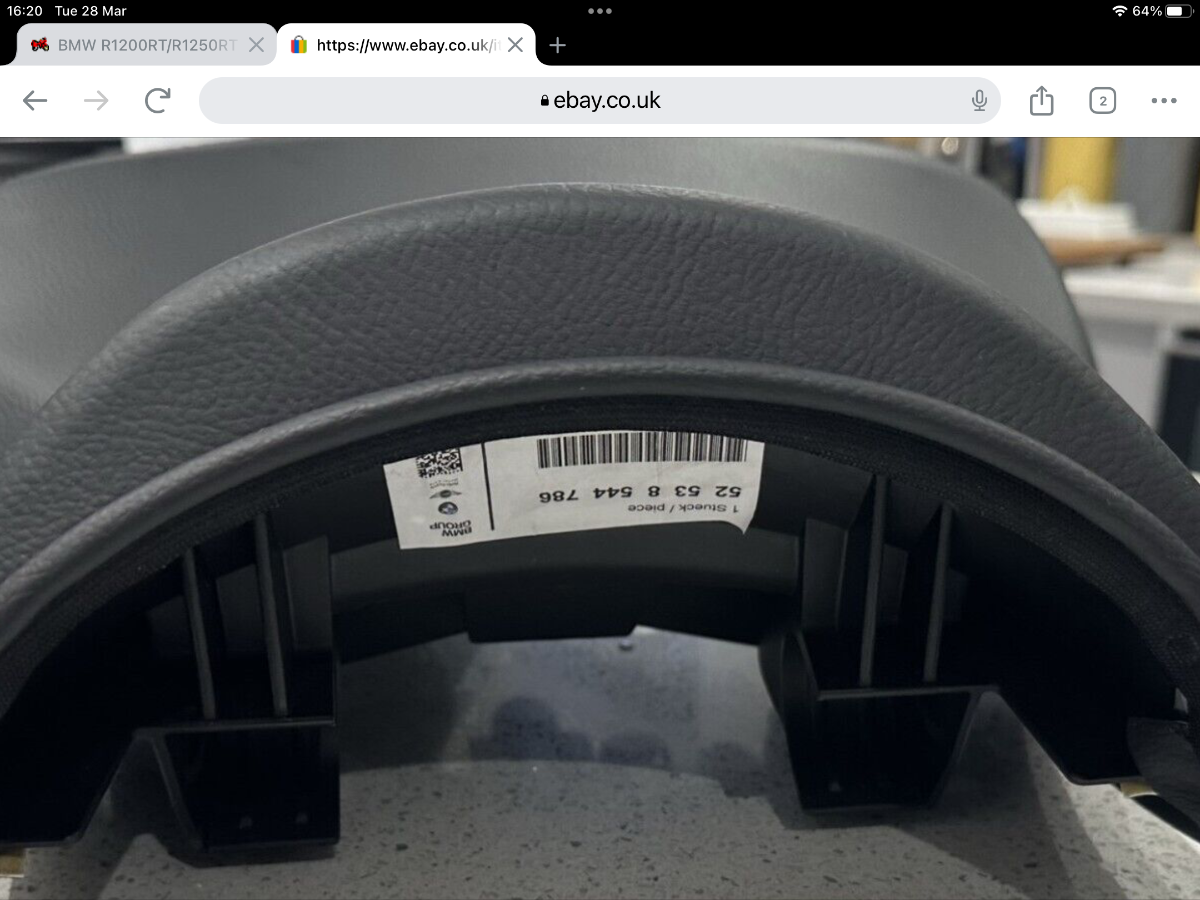

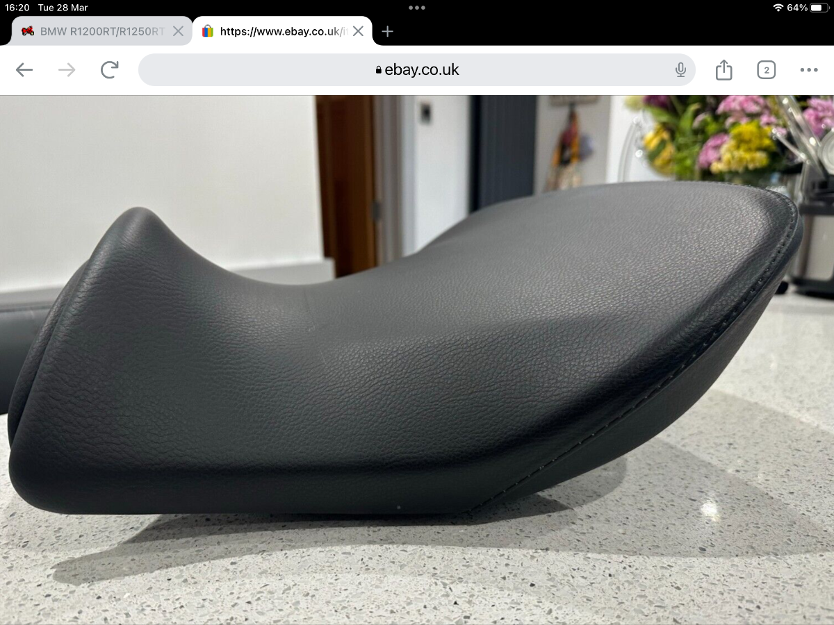

This is the low seat I am looking at getting is it similar to yours or not.

A 2014 Wethead seat won't fit an 11 plate Camhead.
The Camhead has 3 seat height options, standard and low rider seats and the dual comfort seat described as extra low.
