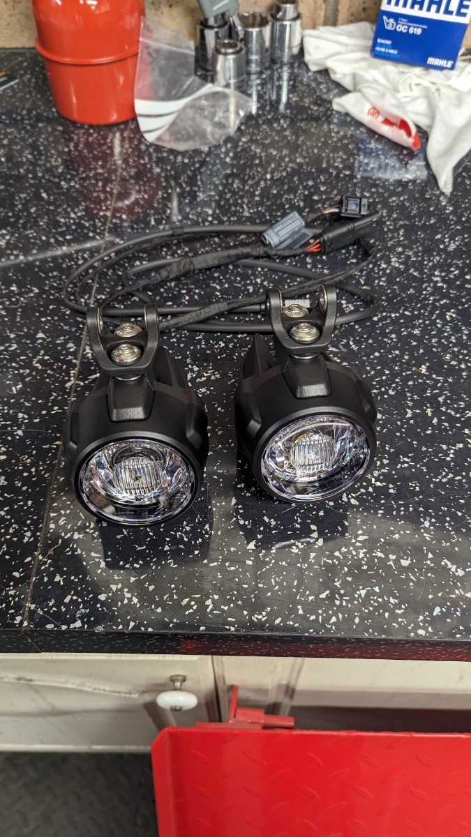

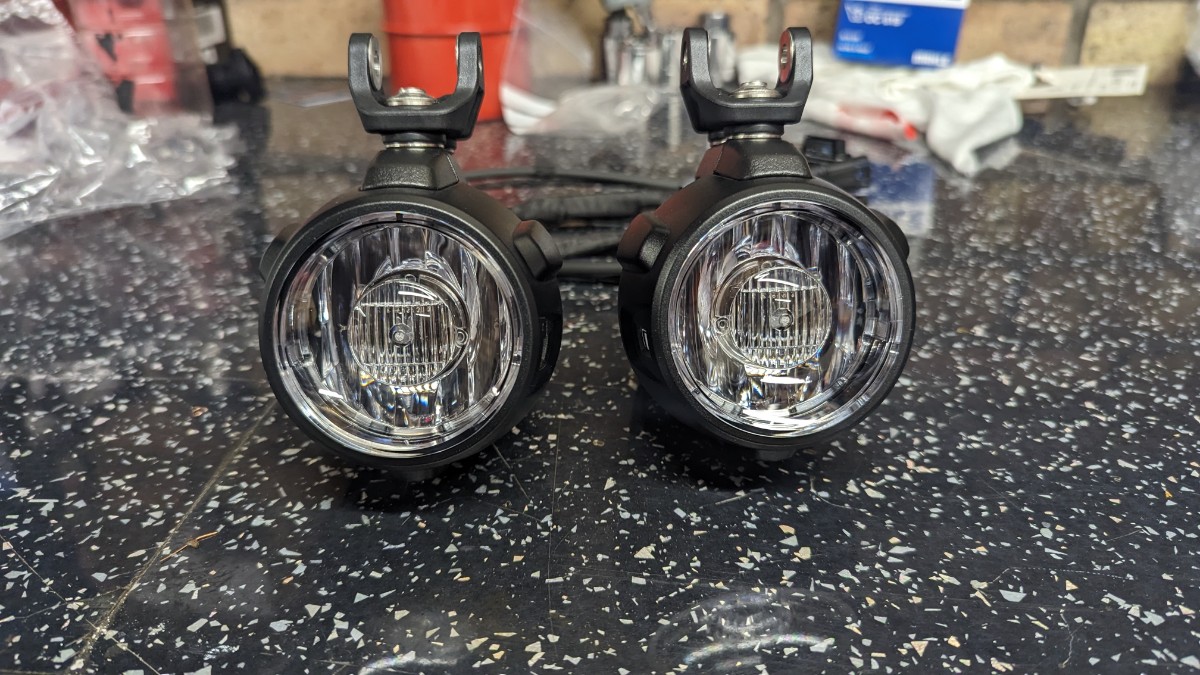

Well I bit the bullet and ordered a set of new lights! I opted for replacing them as a pair with the newer Nano set which meant replacing part of the loom too as they have different connectors on :roll:
After looking more into it you simply cannot replace the stock lights for anything else as they are canbus controlled and as a result 3 of the 4 wires are permanently live with a 4th wire being the canbus wire that tells the lights to turn on and off
Replacing them with something else would have meant a seperate switch and relay or a EZcan controller and I would have had to take a trip to BMW to remove the coding for having auxiliary lights fitted otherwise you can get errors
