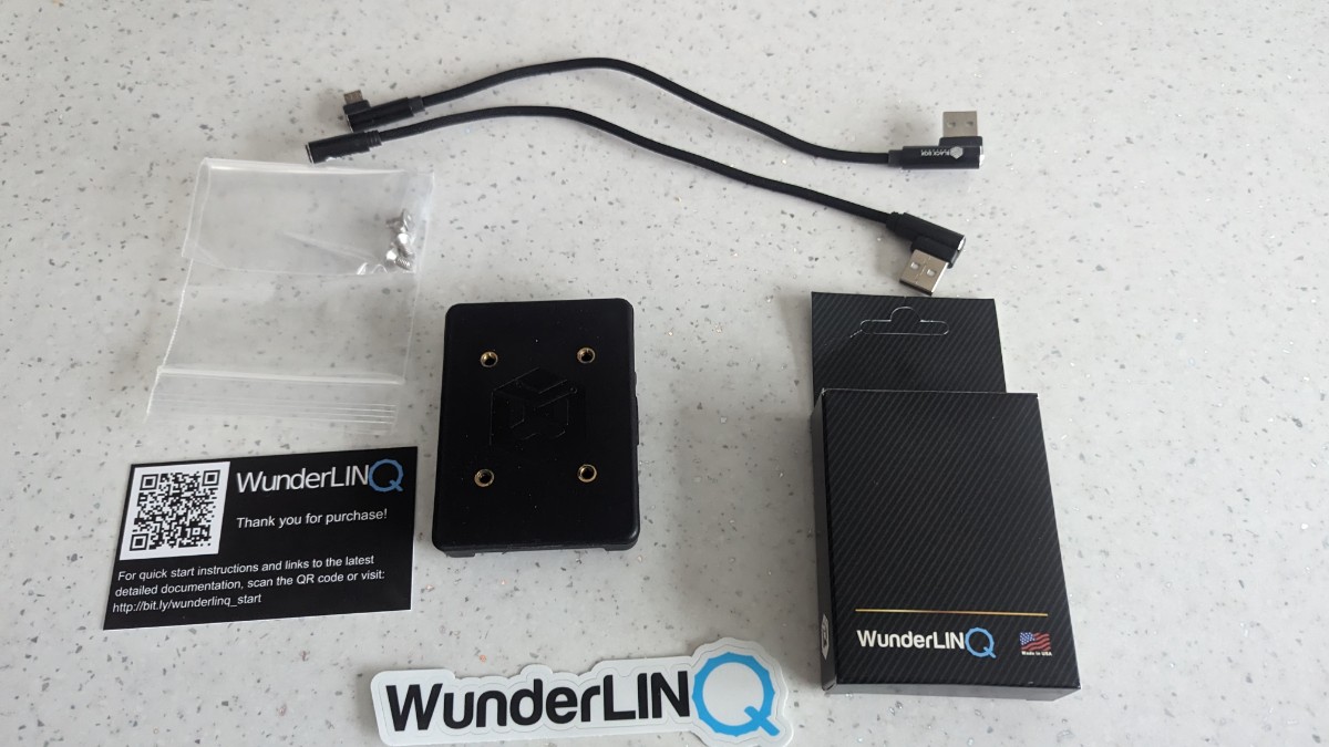

This is what is in the box and as you can see its very small and compact the box of tricks that does all the talking and comes with 4 screw holes to accept AMP type mounts which is pretty much the standard these days.
I was also supplied with two charging cables for the phone micro usb and a micro C as the unit has a 5V 10w charging port on the side

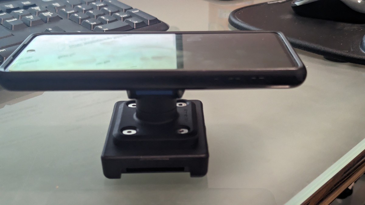

I have also got 4 screws for mounting a Quadlock mount to mine as thats what I intend to use

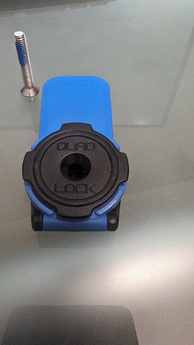

I used a Quad Lock square base to mount the phone which comes with a spacer coupled with Quad Lock 360 Lever head
This spaces the phone out perfectly to mount it on to the R1200RT but if you are using your main phone then I would recommend the Quad Lock Motorcycle Vibration Dampener otherwise you could destroy your mobiles delicate camera.

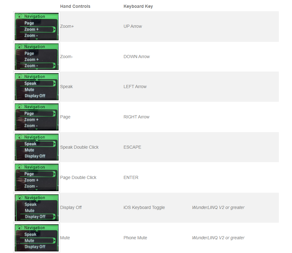

On the BMW R1200RT the inputs are controlled via the OE inputs via the navigation page on the LCD display
Here is a list of the standard inputs

I was also having some issues with the "speak" input not working correctly so I moved this to the "Display Off" I have also added some other functionality to suit my needs and it works extremely well

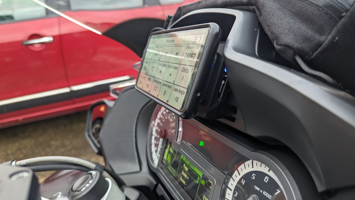

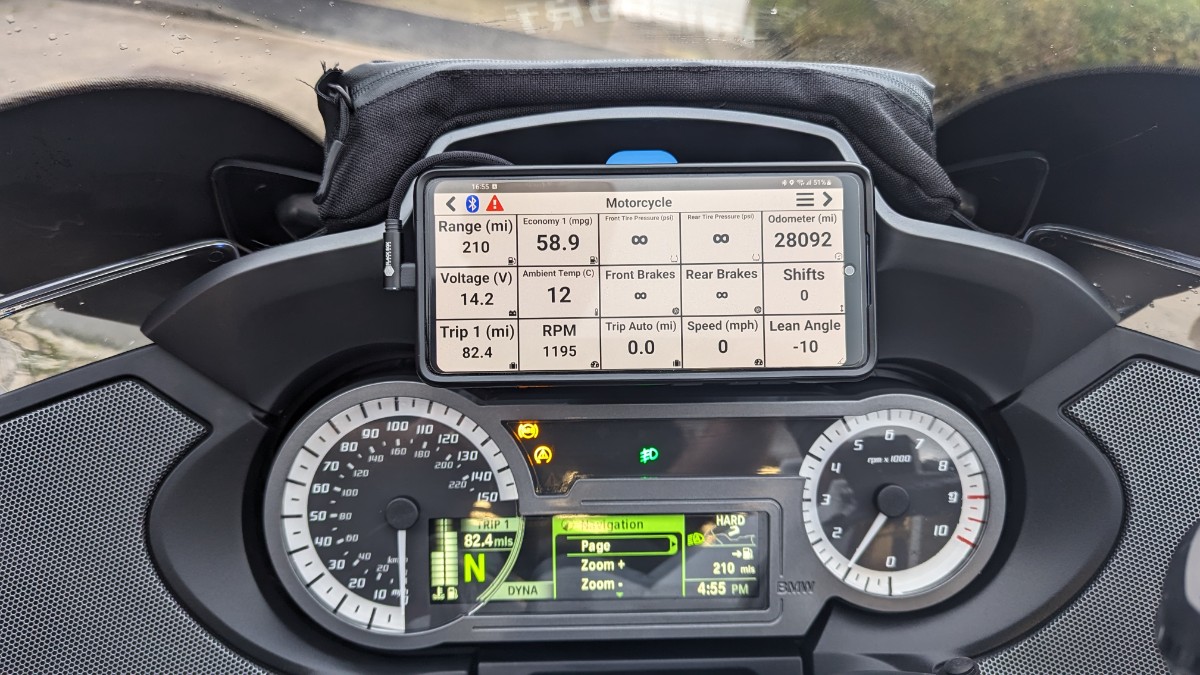

Pics of my set up on the bike

Just some picture of my new installation with systel against vibrations ;)
