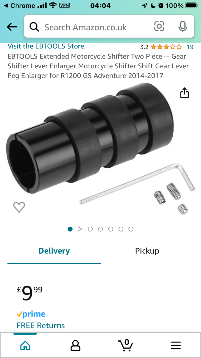

If you want one of those Steve,I've got one in the garage.By the time you've slipped it over the existing lever there's hardly anything left that's extended. Buying that is what made me do it meself (bit of a blonde comment there :mrgreen: )
If anyone wants to try that extension Steve has posted then pop me a pm and I'll post it to you(free of charge)but I may have lost the grub screw,not sure :thumb:
Has liked: 473 times
Been liked: 404 times
Re: Gear lever extension
burridge01 wrote: Sat Nov 25, 2023 7:36 am If you want one of those Steve,I've got one in the garage.By the time you've slipped it over the existing lever there's hardly anything left that's extended. Buying that is what made me do it meself (bit of a blonde comment there :mrgreen: )
Thanks matey,
I bought a pre-owned Wunderlich one when I irst hot the bike which do the job, but I concede they provide less of an extension than yours.
The Amazon jobbies are considerably cheaper than Wunderlichs over-priced item
