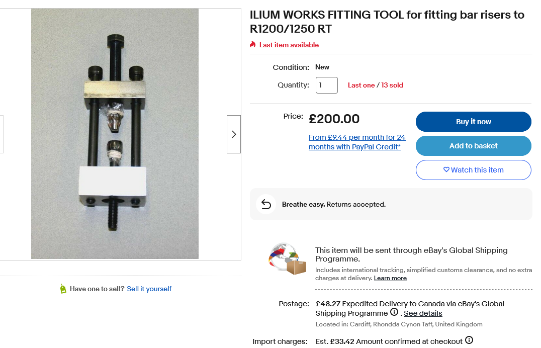

Glenn wrote: Sun Dec 03, 2023 8:35 am You can rent one for £25 here https://www.ebay.co.uk/itm/134122495671 ... R8K8gO2FYw
Fifteen quid would be a bargain but i'm in the willy-wags of Canada and to obtain that device would be about $500 Canadian not including the cost of shipping it back. Here's a screen shot of what appeared after clicking on the link you offered.
Screenshot 2023-12-03 at 08-39-01 ILIUM WORKS FITTING TOOL for fitting bar risers to R1200_1250 RT eBay.png
Screenshot 2023-12-03 at 08-39-01 ILIUM WORKS FITTING TOOL for fitting bar risers to R1200_1250 RT eBay.png (336.67 KiB) Viewed 1899 times
The company that manufactured aforementioned device (Ilium works) seems to have dropped off the map as their website no longer works. The brake pedal extension that i bought a while ago that was manufactured by them was only obtainable through Ebay as there was no stock elsewhere.
I've looked around for a puller in the past but i may have more luck if i try again at this time. I had hoped someone could comment on their experience with warming the aluminum part of the assembly with a heat gun.
The other thing i should have asked is if anyone has noticed any sort of adhesive or locking compound used to hold the bar end in place.
Cheers and thanks for the replies!

burridge01 wrote: Sun Dec 03, 2023 9:12 am That's who I rented off(the fella asking is across the water)seems to have put his price up,i only paid £15.So much easier with that weapon :thumb:
I only paid £15 too back in July, I did buy the Ilium risers from him too.

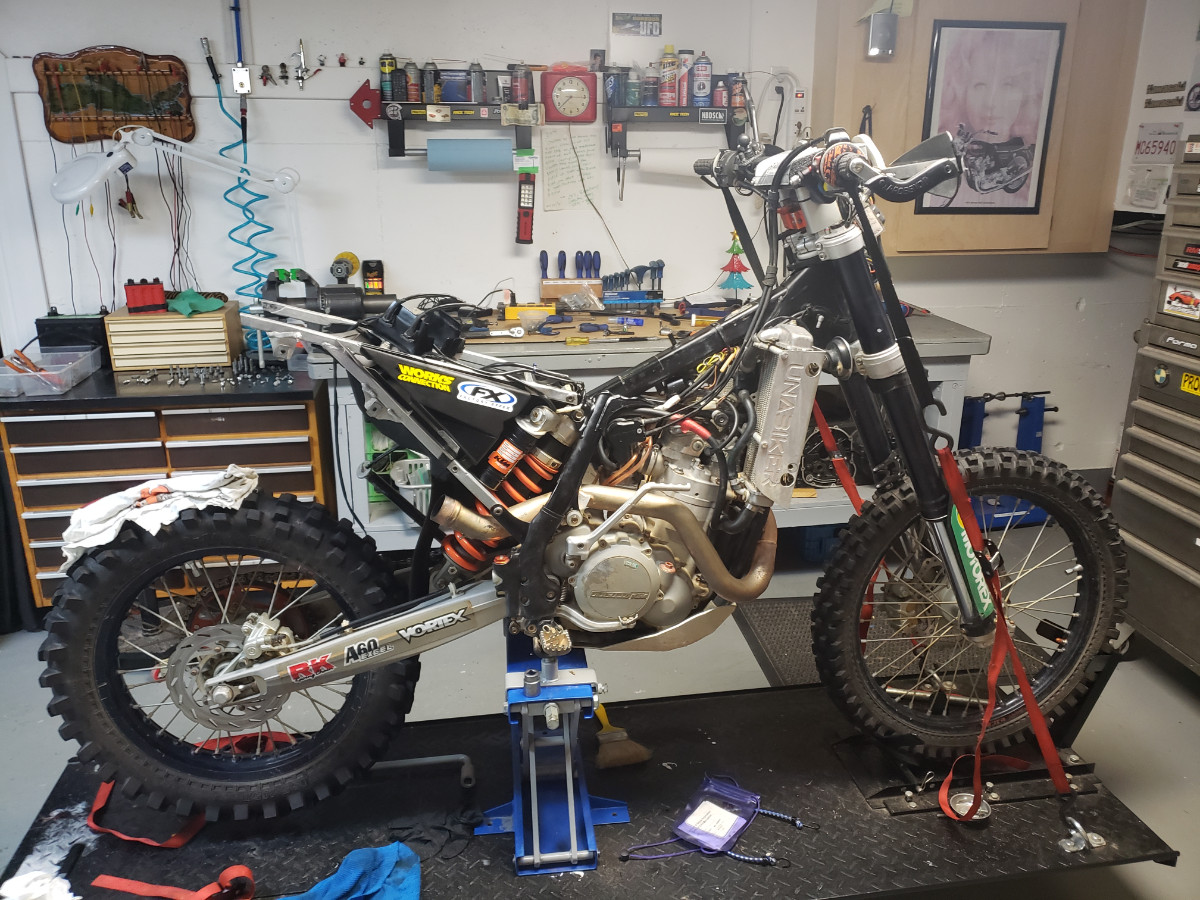

I'm re-thinking whether i'll actually install these risers. I already have the blocks under the bars and adding the riser will probably necessitate adding longer brake/clutch hoses. I could get away with stacking risers on my R1100RT but this R1200RT doesn't seem to have that 'flexibility'. Once my shop gets cleared out and the lift freed up, i'll remove the body panels and see if there is any leeway. Cheers! Here's a pic of the current hindrance. :lol:
