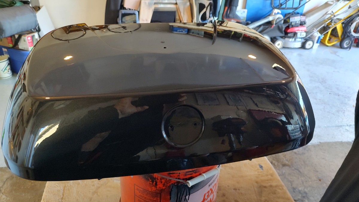

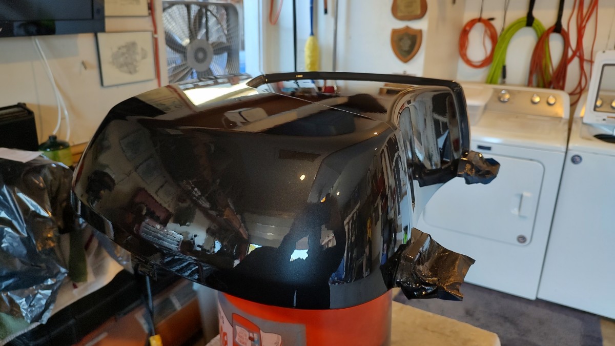

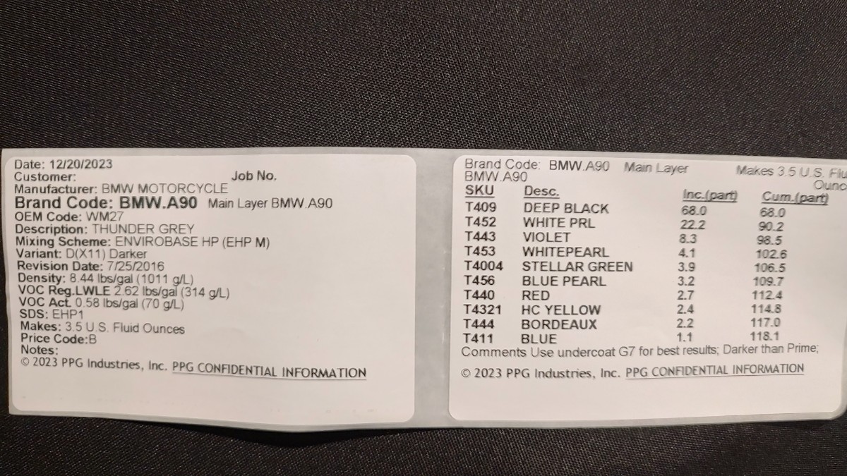

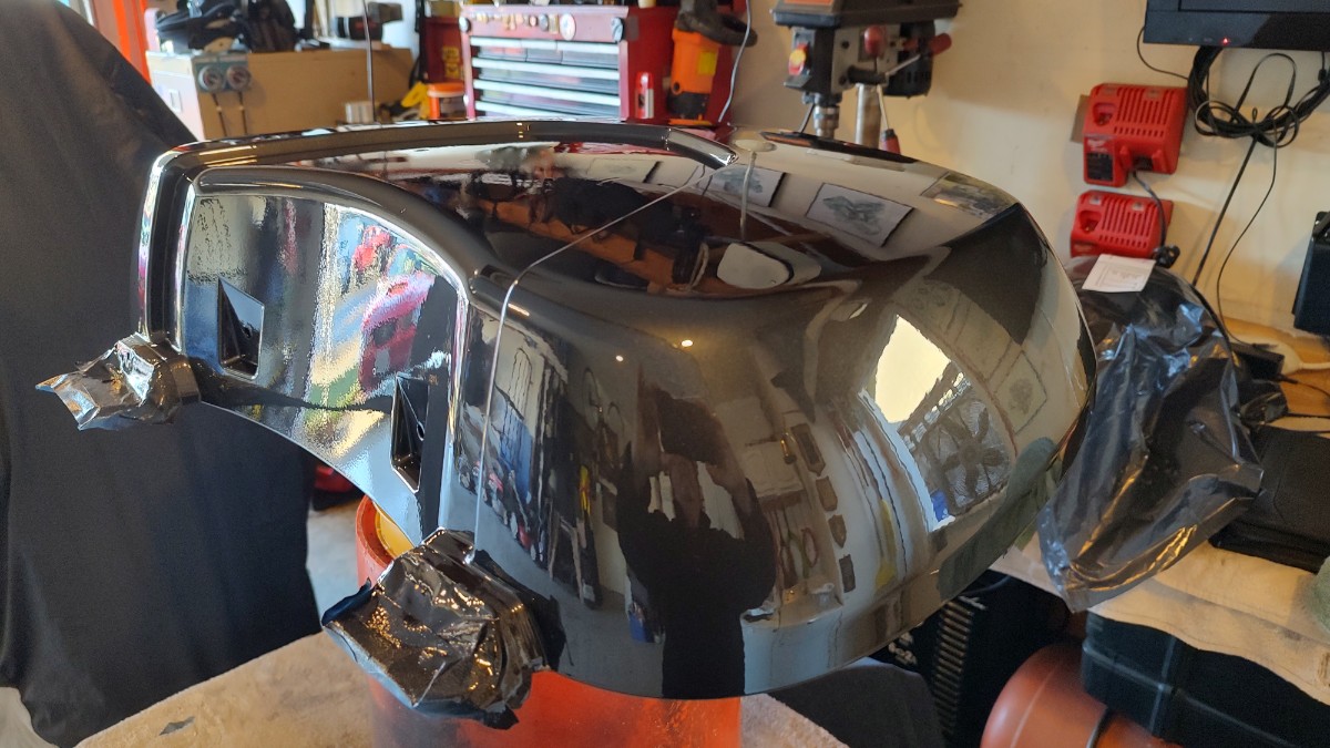

Hi All,
I decided to color match my top case to the paint on my 06 RT, and I have to say finding this paint was no easy task. I finally went to Ned's Paint Supply, and as usual they came through, there wasn't a code available in their system so they had to scan with a very cool machine, took only a few seconds, $91.00 later I walked out with a spray can of base coat and a can of 2K clear. Both of these are aerosols, in a can, I've used this system in the past when color matching components and it works great! I have attached the results and printed PPG paint ratios for BMW 946 paint code through Ned's.
