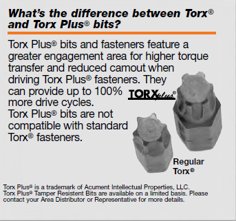

The Torx Autosert feature guides the driver bit accurately into the recess creating a self-centering engagement action. Torx Plus is designed for high torque transmission. This means that higher torques can be used to securely tighten fasteners without incurring additional wear and tear on the tools.
https://www.insight-security.com/what-i ... he%20tools.
The article also adds that a standard Torx bit would be a sloppy fit in a Torx plus screw.
However I’ll order a Torx+ set, they’re not expensive (£29 from Halfords) and they’ll look really pretty in my tool box :lol:

Yes, the Torx and Torx Plus should not be interchanges otherwise the head will be damaged. Having said that I don't think there are any Torx Plus fasteners on the RT.....Cheers David
