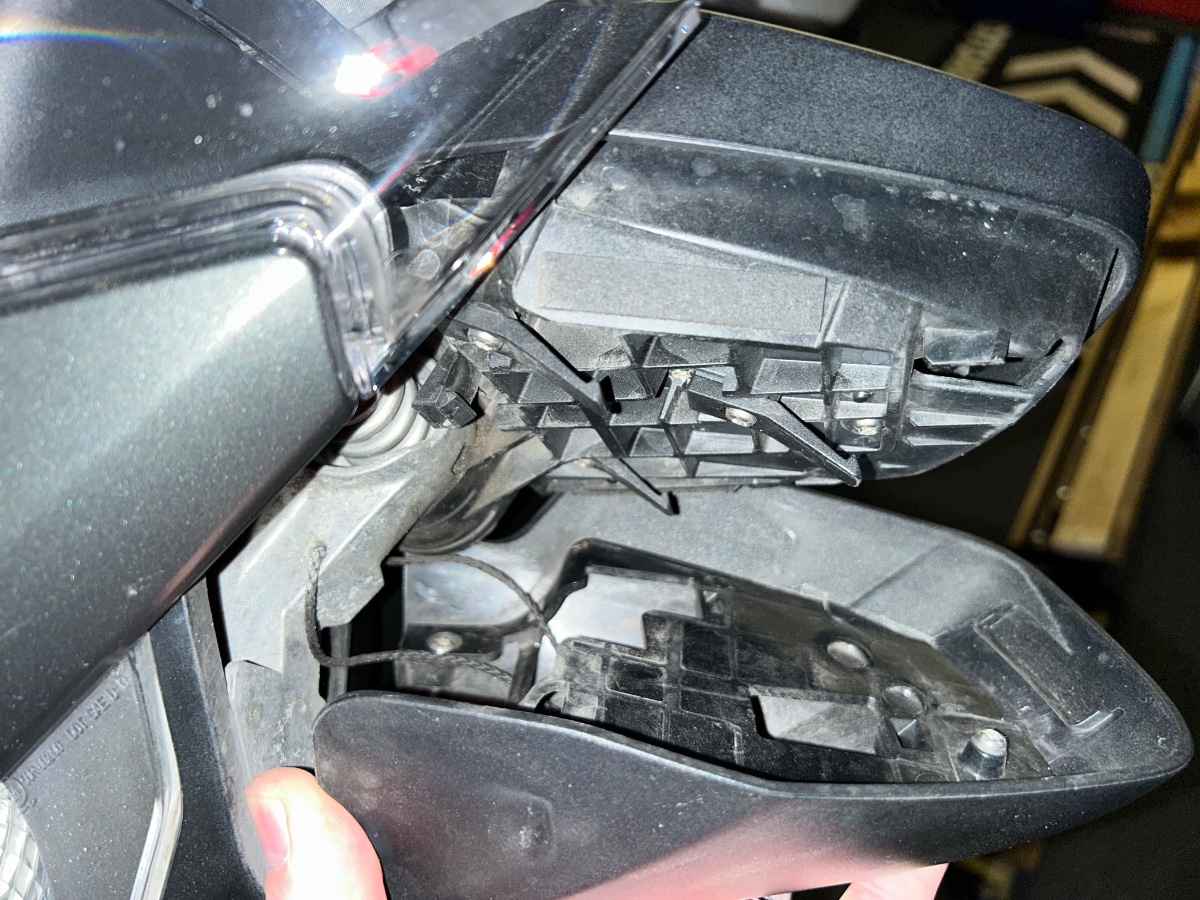

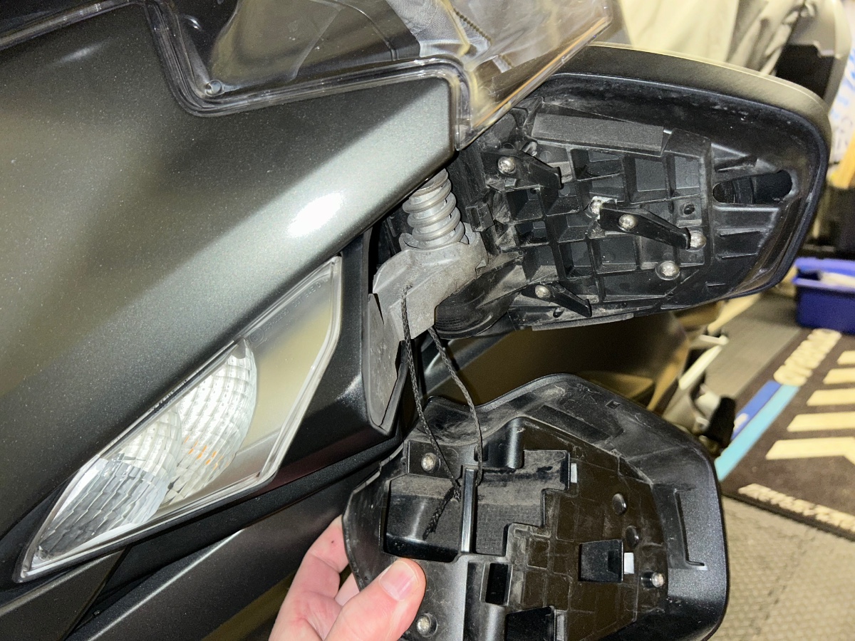

Anyone know how to remove the mirror covers on a 1250 rt ? Need to replace one of mine :(

They just pop off outwards from the inside edge.
Not backwards or you could break the 3 retaining hooks.
There is also a string that stops you losing the cover.

Fold mirror in then pull the exposed section of the mirror back inline/parallel to the line of the glass. I find a quick jerk works better than a long pull!
