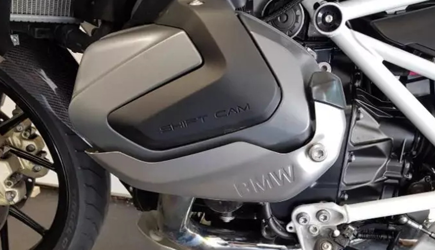

BMW cylinder head guards

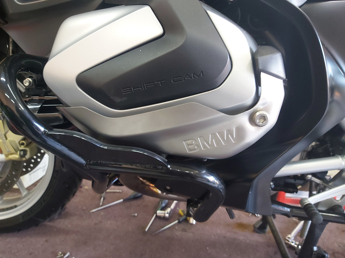

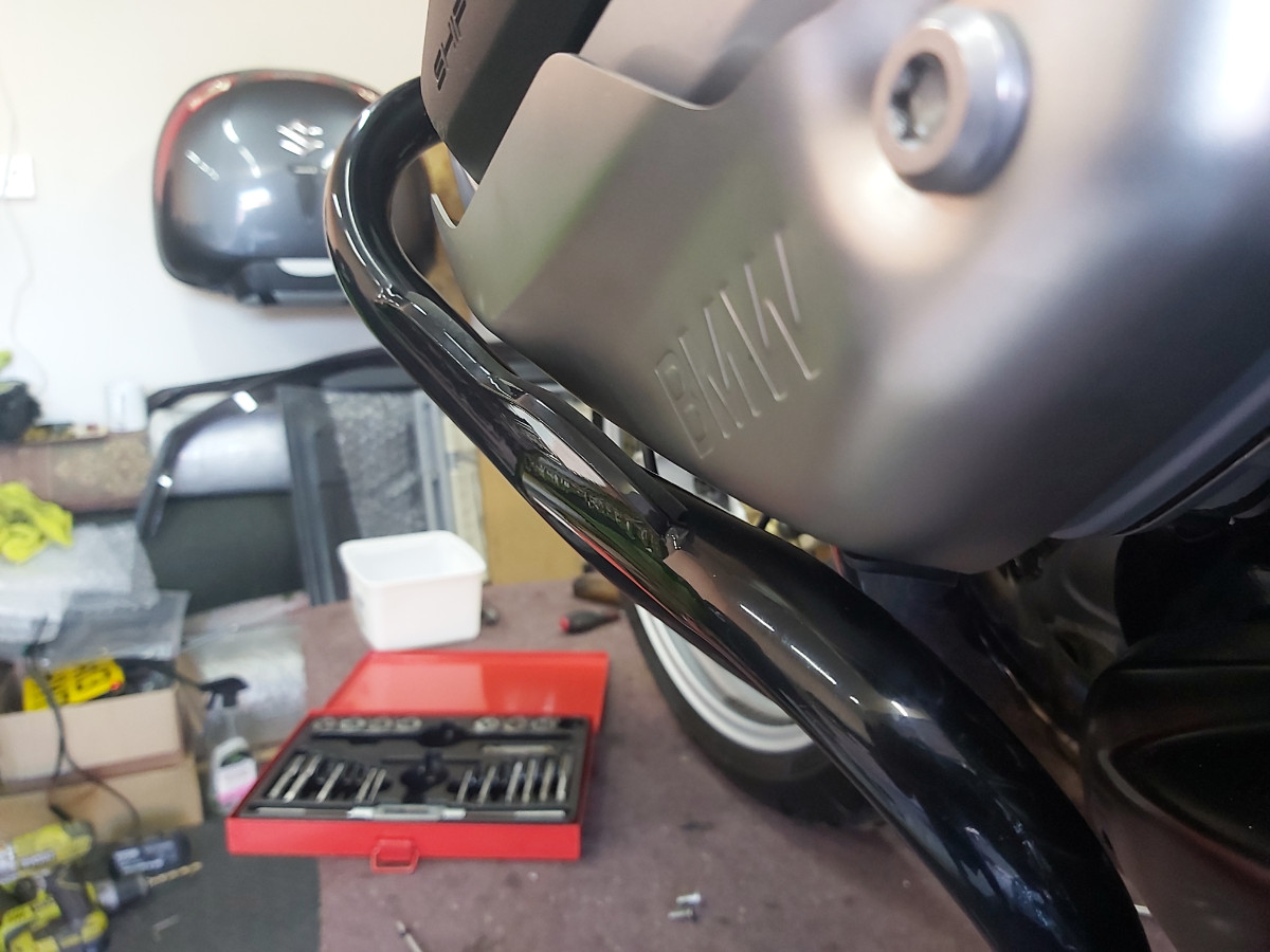

So i have now fitted both the BMW cylinder head guards and the Heed crash bars.
Now there are 3 mounting points for the left and right bars once the lower bracket is fitted to the sump.
The rear mounting point has had a 6mm spacer added. The front top mounting point has had a 6mm spacer added. The front lower mounting point has had a 10mm spacer added that fits between the bars and the mounting points.
This gives enough space to slide the cylinder head guard in place and room so it does not touch the Heed crash bars.
