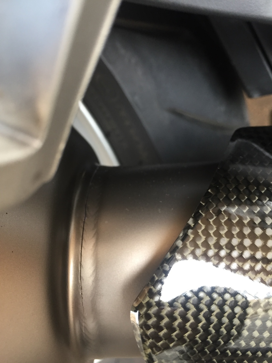

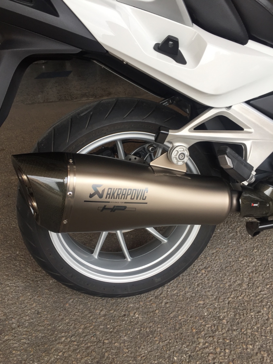

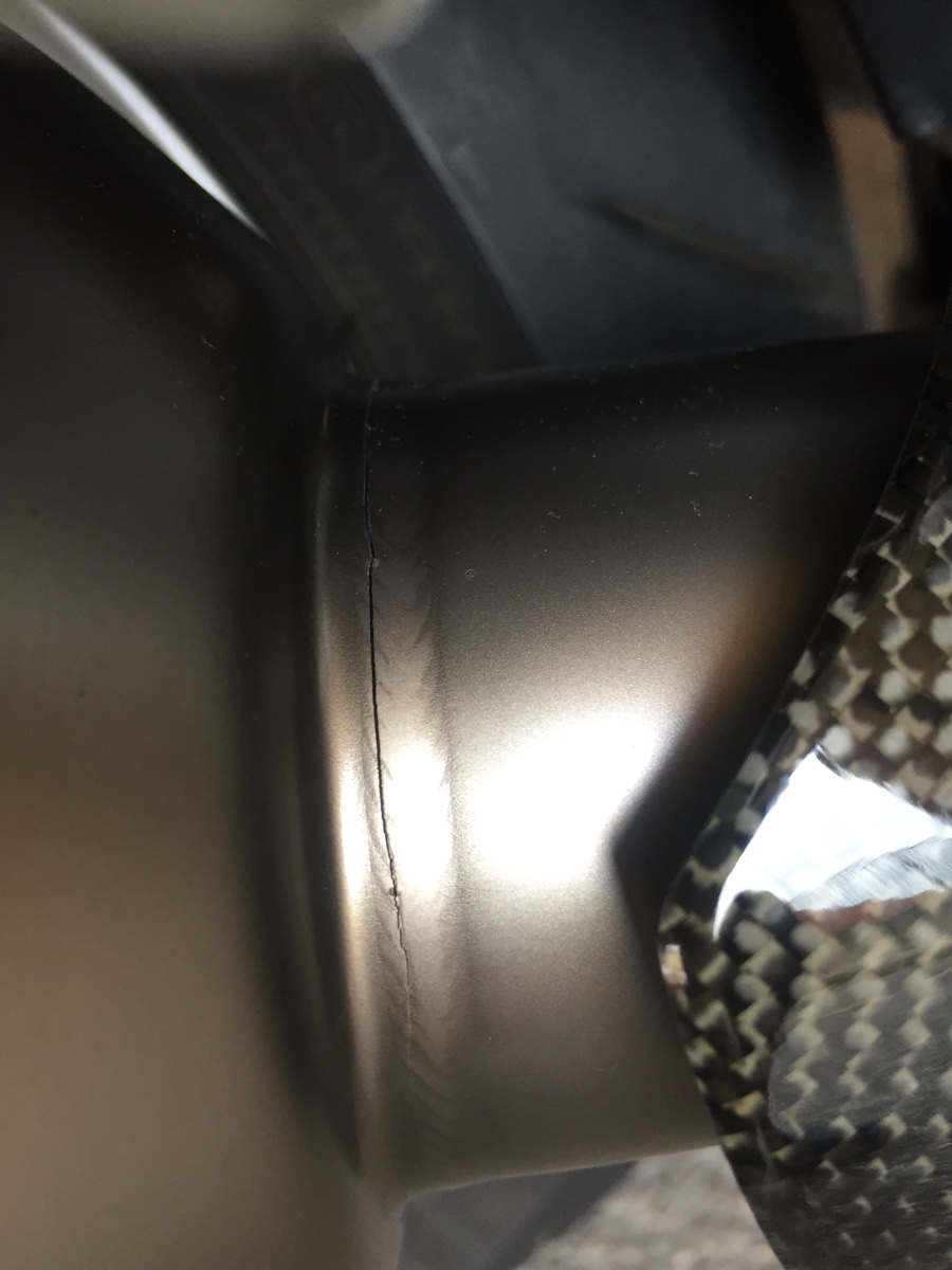

Hi guys, whilst cleaning my 2019 RT1250 I noticed a crack on the weld between the silencer and the collector on the HP Akrapovic slip on. Anybody had this issue as well? Bike is now out of warranty. Any news or ideas would be great. Cheers!

My first port of call would be the dealer(if warranty hasn't lapsed that far)then Akrapovic. If no joy there then it's a decent welder.

Well, the bike warranty ended in June '22 (3yr warranty) I've not gone to the dealers, yet, but I probably know the answer they'll give me beforehand. Worth a try, though. I've got in contact with Akrapovic and they asked me to send them some images, which I did yesterday. Waiting for a reply, now.
Really weird, though. I've never seen a can crack like that before. The bike only has 23000km.

Well, Akrapovič doesn't wanna know anything about this. They say that the sip on came as OE equipment and so it's BMW who should sort it out.
I've now gone to the dealers who have made a claim at BMW motorrad, Spain. Lets see how this goes, but I'm not very hopeful.

A good specialist welder will be able to sour that out. Have you checked the rest of the system for looseness. Cracks like that are caused by vibration.

Update: BMW don't wanna know either. They say the bike is not under warranty any more. Some guy at BMW is trying to get me some sort of a courtesy deal ie we go 50/50 or something along those lines but as with Akrapovic, I'm not very hopeful.
I will check the slip on to see if it's come loose. Only two bolts hold everything together, the one by the sleeve and the one at the rear footrest. You could be right and maybe the bolt at the rear footrest has come a bit loose. Anyway the damage is done.
Regarding specialist welders, I cannot seem to find any who weld titanium in my area.

Sure you'll find a welder but how much.Must be specialist job,good luck with whichever way you go

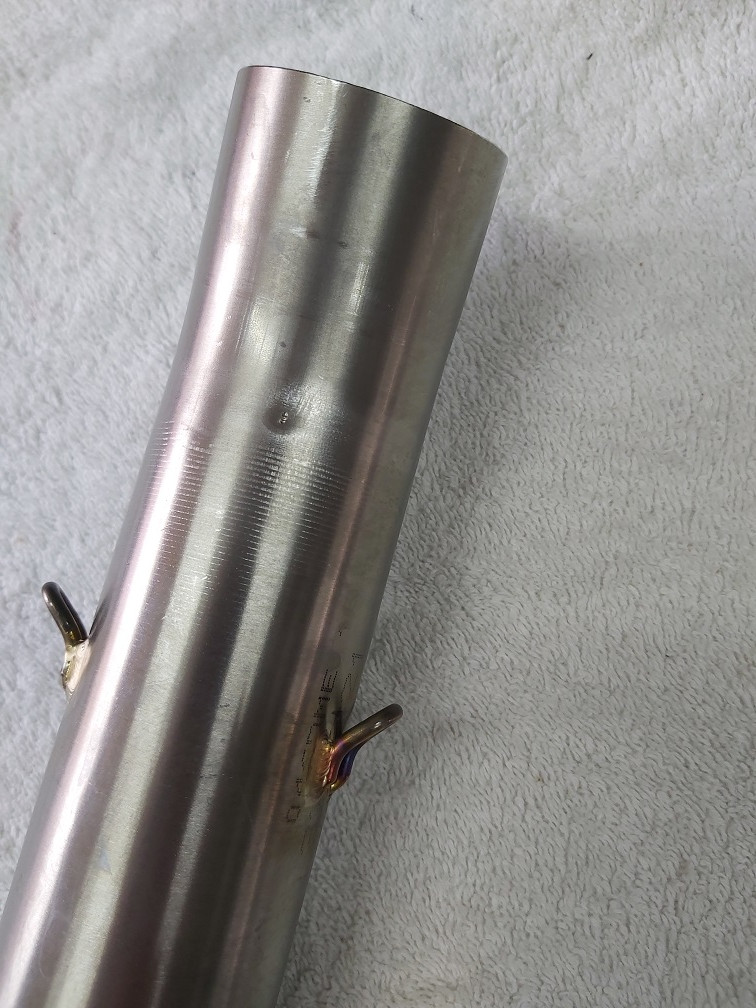

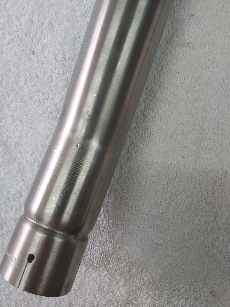

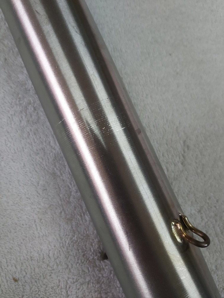

Well i bought twin can slip-on's for my Gen2 Hayabusa. I paid £1300 for them.
When they came the slip-on were great. But the link pipes were a very poor finish.
I tried to see if i could get replacment linkpipes and was told no as Akrapovič said the linkpipe were ok.
I could of returned the whole system, but i really wanted these exhausts.
So i ended up painting the linkpipes black.
Akrapovič's customer service is not that good. I wont be buying from them again.
Here are the new linkpipes as they came from Akrapovič. No attempt to clean up the tooling marks.
