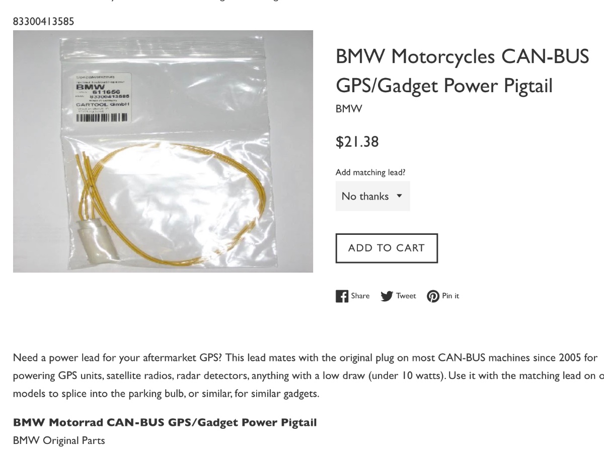

Hi. I have a 2023 1250 RT, and want to power an accessory (i.e., a usb charger that I’ll keep in my tank bag) by connecting it to the Can-Bus system, so that the power to the accessory turns off when the bike is off. I bought this pigtail (see photo), but am not sure where the Can-Bus connector is located on the bike. Anyone know?

Hi,
Done exactly the same thing on a 2021 RT.
Looking down in front of the tank on left hand side (as when sat on bike) just under the bottom of the cubby hole, you will see some wiring all clipped in. Amongst that you should also see a blanked off connector (black), cabled tied to the loom.
Carefully !!!cut the cable tie to free it it up.
Going to assume nothing changed on 2023 version!
Works a treat for me
Hope this helps
G

Thanks Gareth1962! Very helpful!

Thanks exportman. If (when) I have any other accessories to add, I plan to tap into this pigtail for switched power, and then add some sort of fuse block (like a PDM60 or Fuzeblock) directly connected to the battery. I think you are saying that’s what you did. Right?

If that's what you ware going to do then use the accessory plug to operate a relay to turn on the fuze block rather than splicing in to wiring
That way it will shut off after 30 seconds too

Thanks. I may not have been clear, but yes that’s what I intend to do. I will tap into the yellow pigtail in pic above, so that it serves as the relay to know when the bike is on/off. The power will come from the fuzeblock (or PDM 60), that will be connected to the battery.

I just brought home my new 2024 R1250RT and getting power to my Zumo XT2 is a priority. I bought the pigtail adapter the OP showed but the Canbus plug is nowhere to be found near the left fork, or right for that matter. Does anyone have knowledge that it’s actually there on a 2024?

Cancel that. I did some more digging and it was tucked up out of sight on the left. I must have looked at it 5 times before and didn’t see it :(
