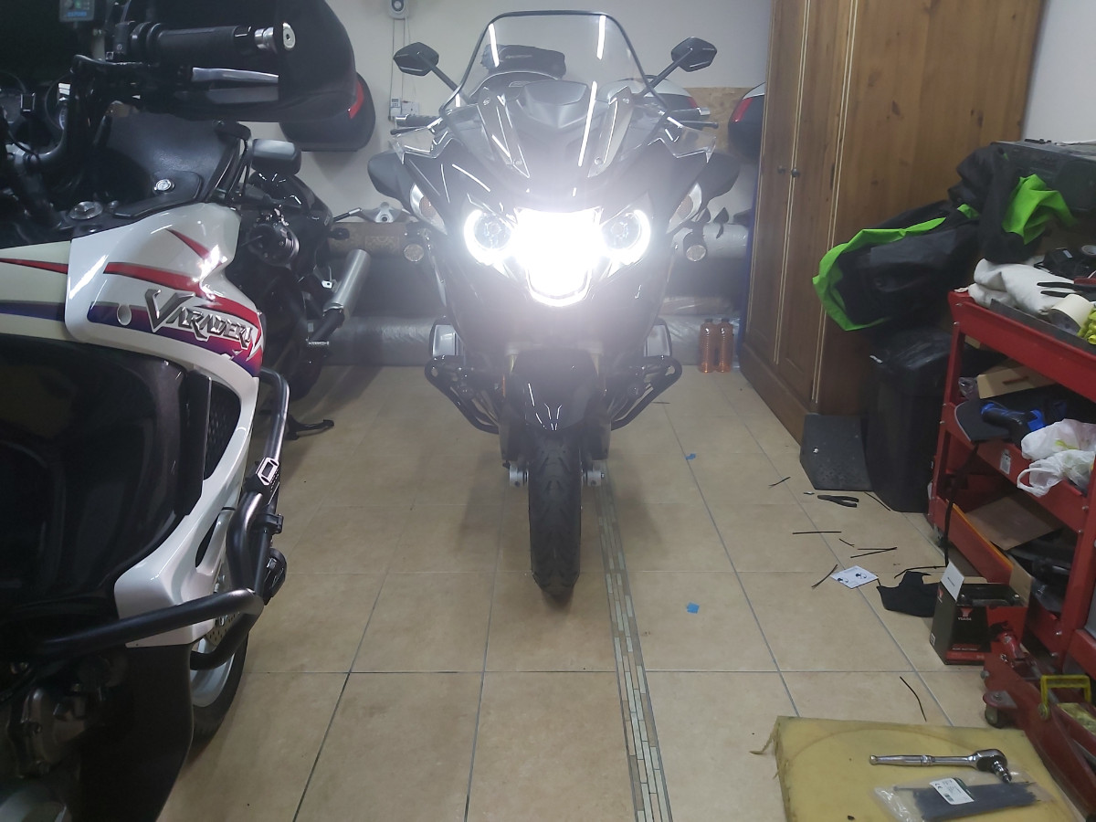

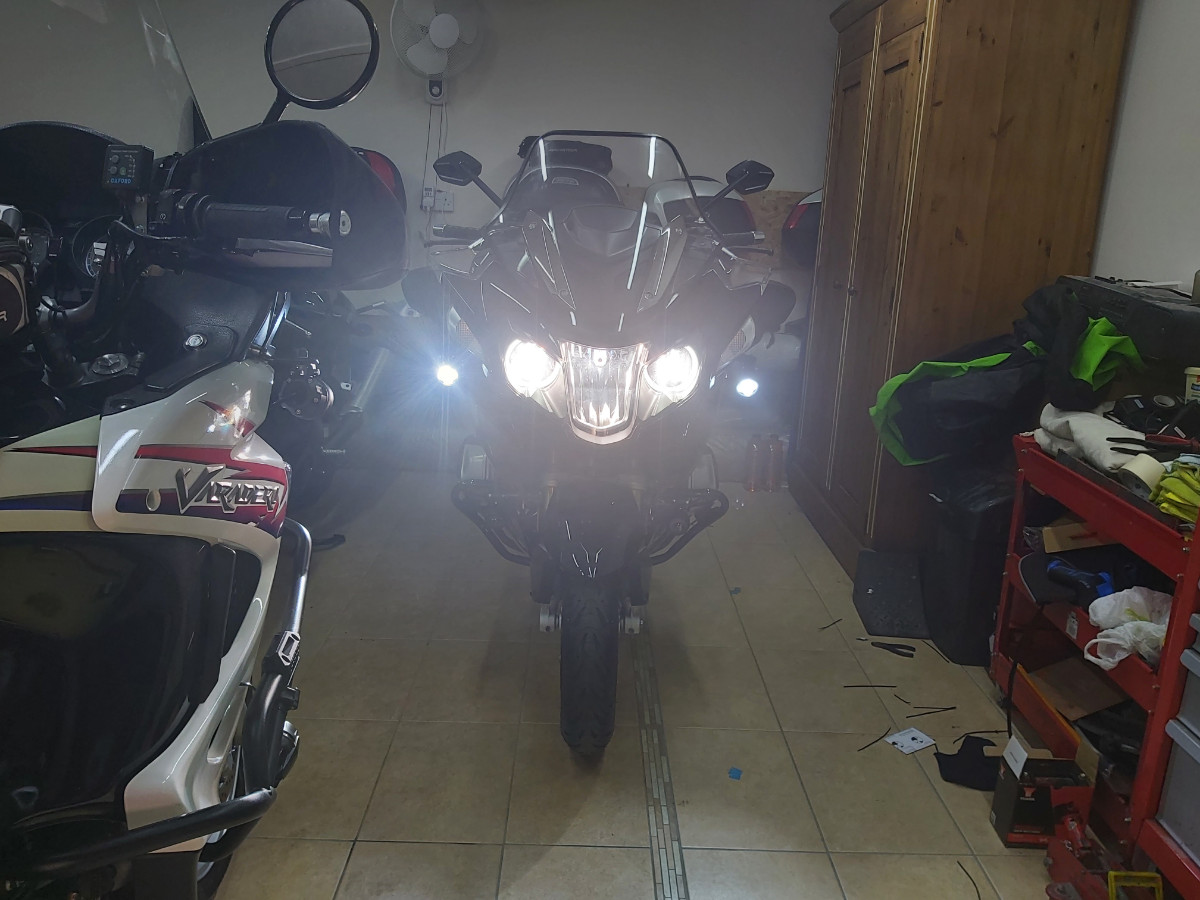

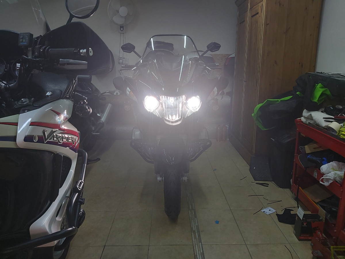

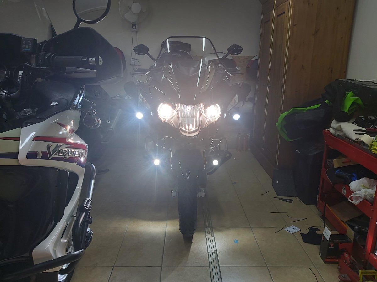

You can see when the spot lights are on that the new bulbs are still an offish white.
Anyway they look whiter than the OEM bulbs that were fitted.
Here are some photos. When the high beam is on the light were to bright to take a photo head on.
So the photos are taken from just above head on.
